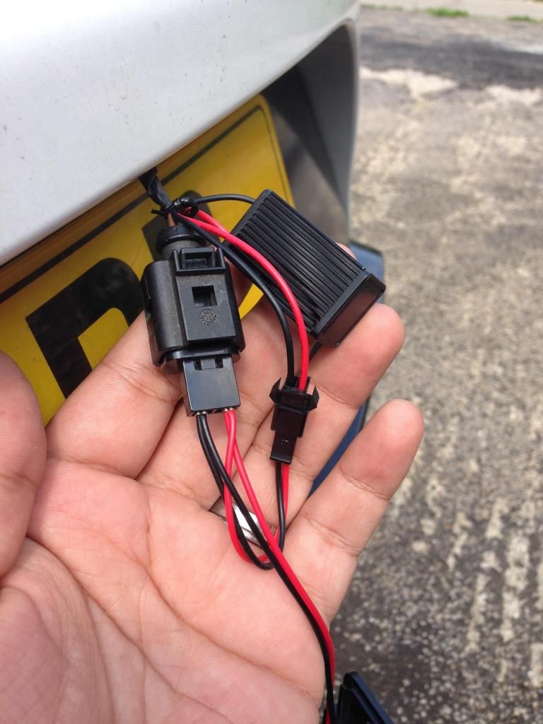

right installed and no errors, out of interest how did you secure the resistors ?
As professional as I always am... I just pushed the resistors in.. Haha. Is that bad? Didn't think there was anything in the way of moving parts so just pushed them in. The wires weren't too long so wouldn't go far
I did the same snigger, its a bugger to get behind there with an LCR zorst
Not much to take a picture of really. Such a small entrance I doubt I'd get my camera in. Just pushed them in. Can't hear any knocking or anything and I doubt they move too much due to the shortness of the wires :)
I think i may just shorten the wire with a cable tie to restrict movement as much as possible
easy
Yeah that's the resistor they sent me first that didn't work. It worked for like a day and then errored so keep an eye on it mate. Get a photo tonight when they're fitted
