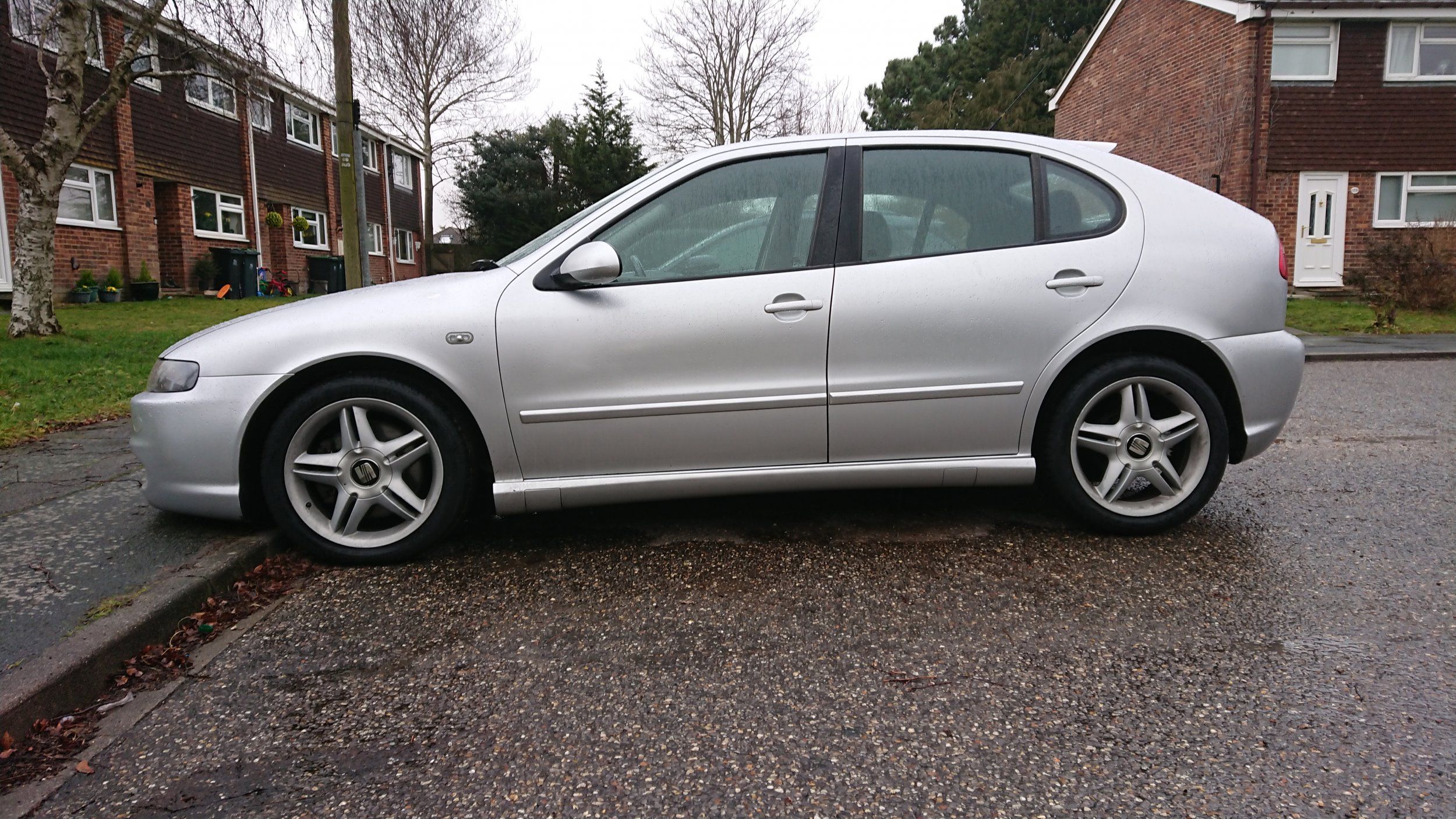

Hi all. Around a few days ago needed new rear springs fitted as old ones were badly corroded.
Car now seems to be higher at the rear by about half inch roughly...it's noticeably higher than the front.

When I bought my LCR it had its arse in the air because they'd fitted the wrong springs. So it can happen.
Show us a photo

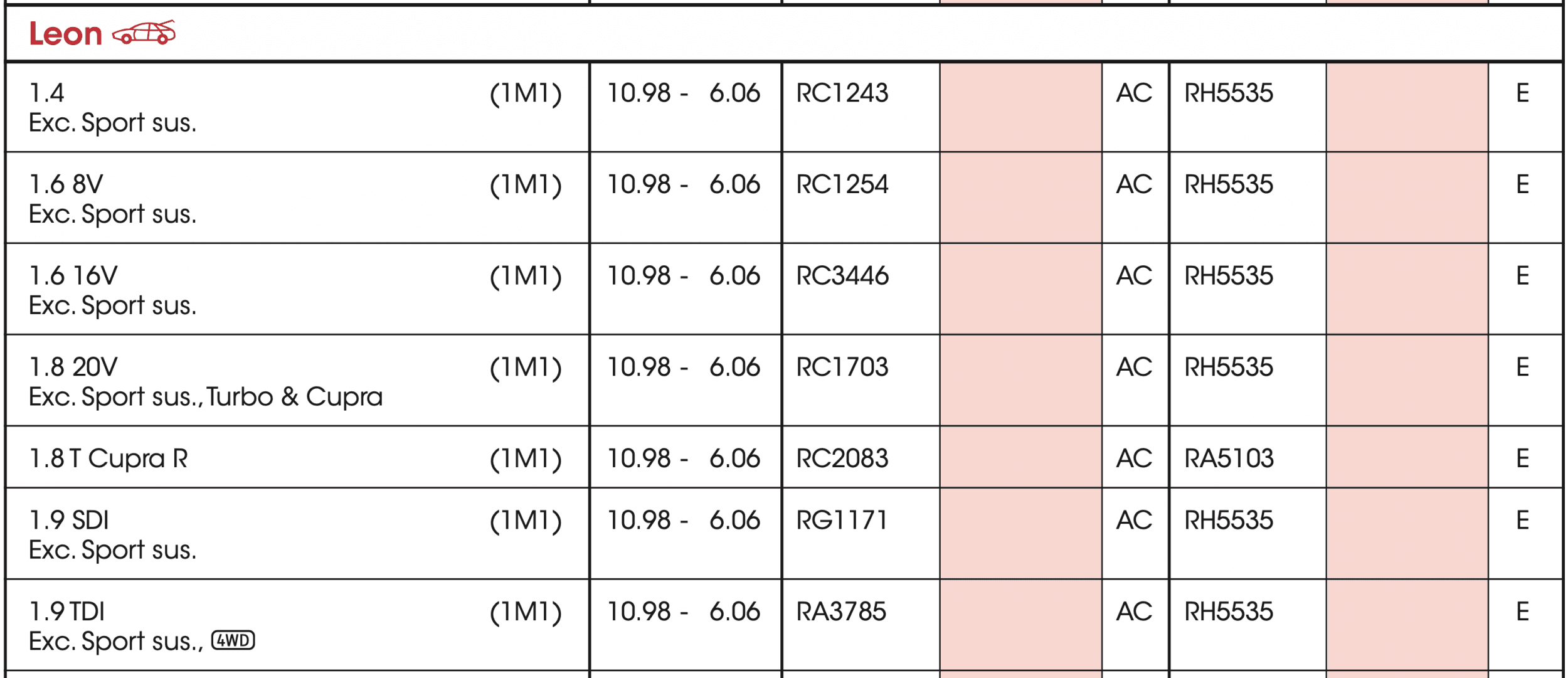

The KYB catalogue doesn't have any models for sports suspension for some unknown reason, but I can see how a mechanic would put the RH5535 springs onto a Cupra.
Lesjofors don't do sports suspension versions either:unsure:

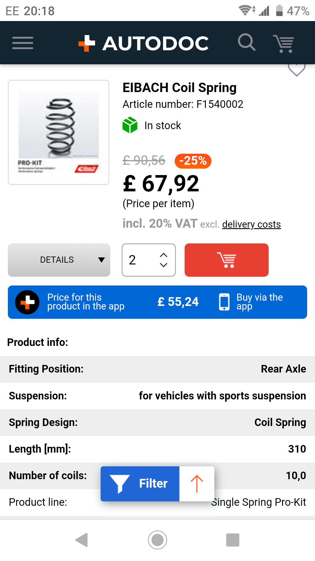

Do you think my only option now is to get lowering springs?
I don't understand how they list non sport springs for a cupra.
