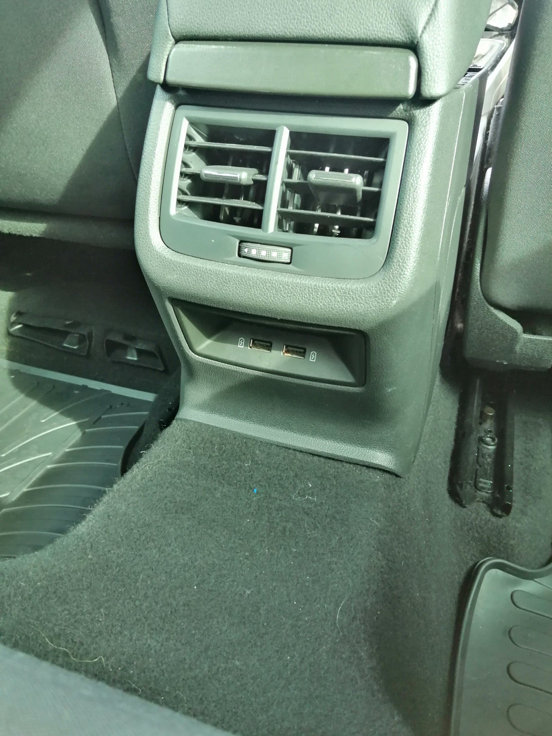

So, just in case anyone is thinking of doing this, so far I removed the tray section from the centre console and pushed this section backwards to release the top of the vent panel.
Then I pulled the lower section loose by pulling it backwards, gripping at the sides.

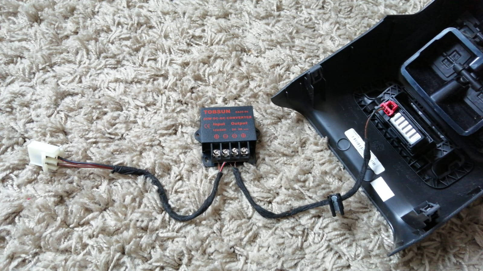

I'd bought the 12v to 5v converter from Amazon and had wired this as follows:

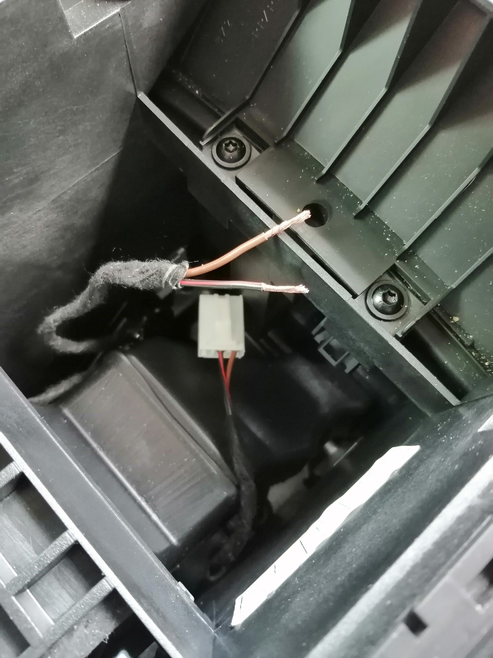

I poked the red connector for the USB hub through to the side of the air duct and clipped it to the side:
OK so I went for soldering the wires into the white 12v connector which goes into the cigarette socket. Measured output at the other ends at just under 12v, rewired into the Tobson 12v to 5v converter, turned on ignition and got a whistle, pop and burning smell. Turned off ignition and found the Tobson device to have failed. Wires still giving around 12v, cigarette socket still works. Do you think I got a dodgy Tobson unit?
OK sorted it. You DO NOT NEED to buy a 12V to 5V converter! The USB ports have this built in, as I originally thought might be the case. Ah well. Found this out whilst checking the Audi forums, did many searches on the part number but nothing included this information. Anyway, I am happy now and hope some of you may be able to benefit from my experience.
I have read from other forums that you can get the wiring loom from Ali Express with the parts for Audis or Golfs but I'm not sure if you can buy them separately. I bodged it by soldering which still looks quite tidy.

Not totally clear in the pic, but it doesn't look like you have any connection to the +V side of the output?
I assume you are referring to the red plug which goes into the USB module. There are two wires there, the wires are really thin, looks like they go into pins 1 and 2. Just bear in mind that the black step down in the centre of that picture is not required, in fact it just won't work with it.
