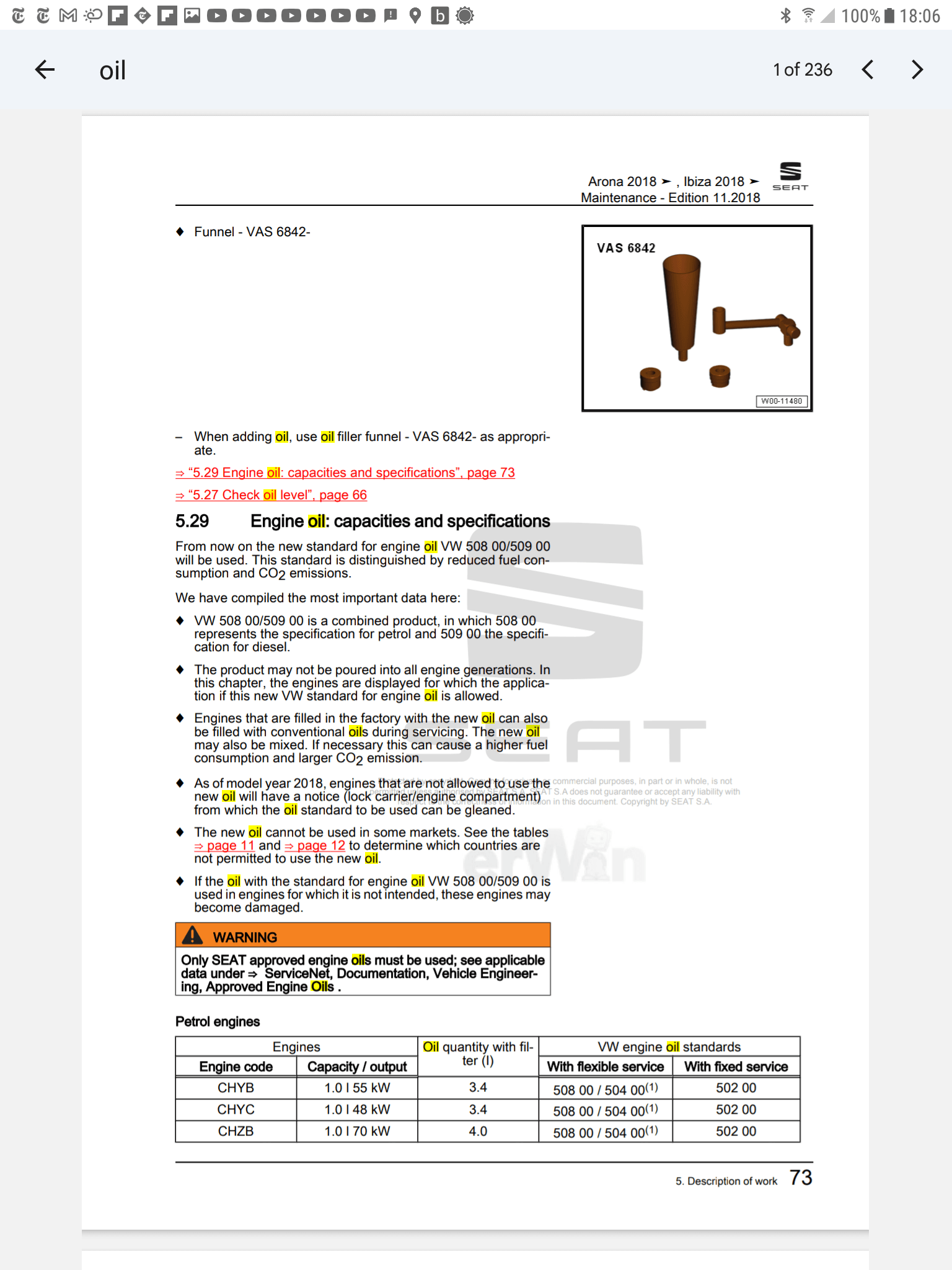

It's this service page manual from Erwin:

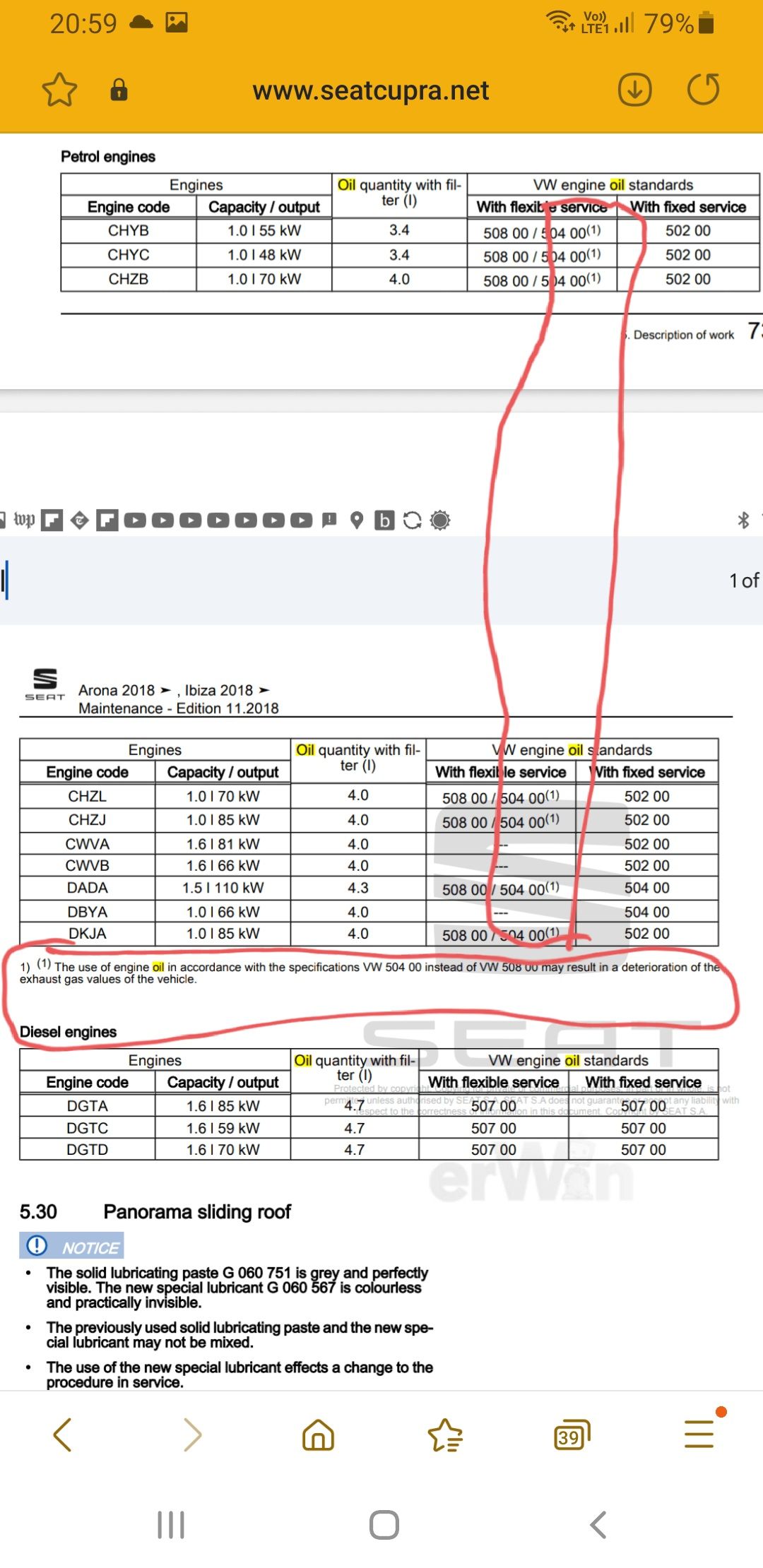

It's a CHZJ engine it hinges on the marked up:
(1) The use of engine oil in accordance with the specifications VW 504 00 instead of VW 508 00 may result in a deterioration of the
exhaust gas values of the vehicle.
508.00 is what you are suppose to put in it unless you want the warning tab above. That is why we bought the quality stuff, what the dealer puts in it who knows.

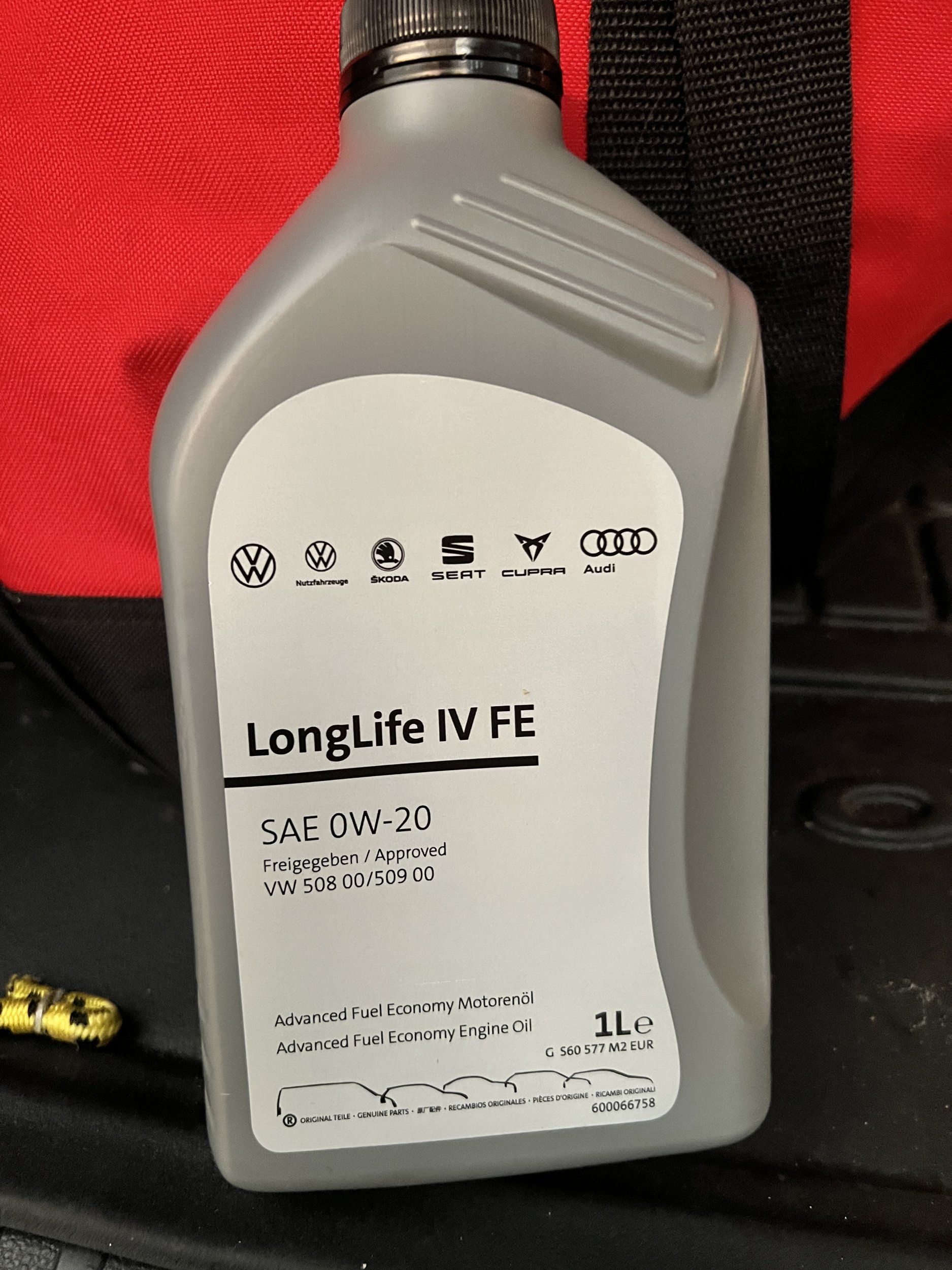

I have a 2019 Arona 1.0 115hp. I had mine serviced by the local SEAT dealer recently and they said I was a little low. This is the oil they put in it.
Oh yes, Their little designer bottles. That's the recommended one same as the Castrol posted up.

504.00 and 508.00 are the flexible service interval oils and you suppose to put 508.00 in it at per the table, it's the CHZJ engine fitted to the tsi 1.0 Arona. That if you are on flexible interval services. If you aren't on flexible service intervals, like having it serviced annualy then 502.00 is specified. 508 is bracketed from 00 and up. Lesser ones aren't.
If the dealer is putting 502.00 spec oil in it at fixed interval services then there is no point in putting 508.00 in it. But then given you don't know what they are putting in it. 508.00 is just dandy. Why I opt to top up with the variable spec oil.
Someone servicing it themselves on a fixed interval would go for 502.00
Skoda description
And
For those on variable service interval the car can measure the viscosity and claw back the miles. What happened to my brother once that didn't obey the oil standards of long life oil and slopped what he already had in it, shifted him onto the fixed service interval. You do need to be aware of whether you are running on variable or fixed services. Cheapskates like the ability of stretching the service to two years but slop the wrong oil into it and get picked up. I haven't gone through the Arona menus which give you the count down for the two, but certainly Ateca owners in the past got miffed when the variable isn't two years after all e.g.. long life.
By Googling the brand against the VW spec it tells you. Basically if the Arona 1.0 is on long service intervals then it is the VW508.00 if not 502.00. Not 504.00 if long service intervals as it says in the Vag technical notes. It is all based on what regime the car is run on. They leave the factory set to flexible then once put on Seat plans get put onto fixed... generally. Those that don't put then on service plans but keep them on flexible have to watch what they top up with if it's taking a lot oil.
"Supposed to put in 508 00". Extracion from your posting #7 in this tread. Look into attached picture. you can use 504 00 instread of 508 00 flex service (LL) but perhaps with deterioatation of exhaust values... no problem in my world :)
