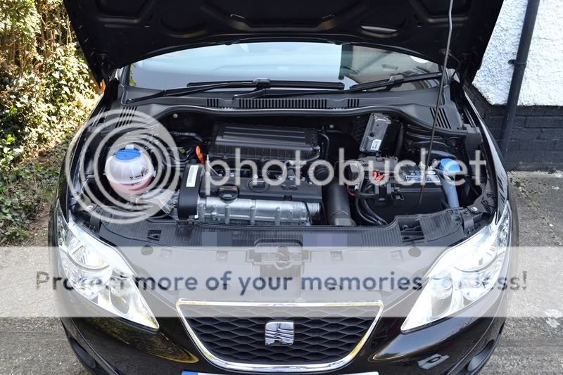

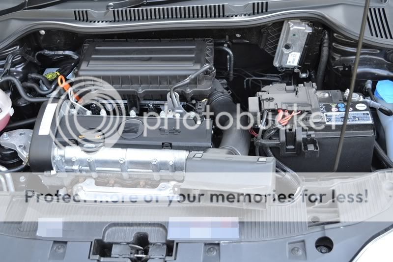

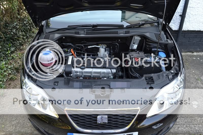

First off open your bonnet and you'll see this :

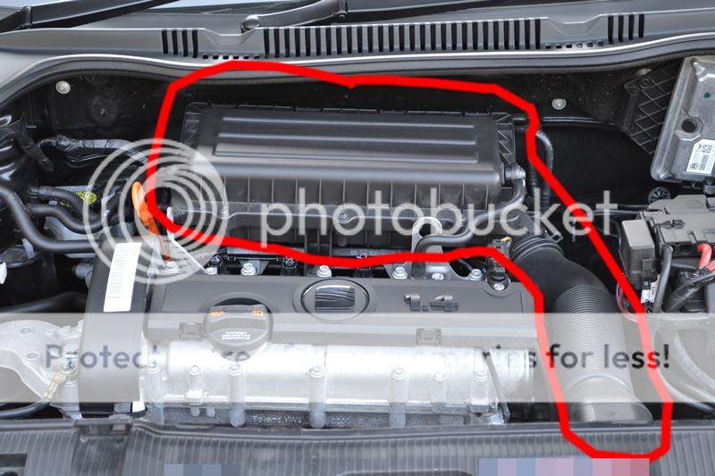

We are going to be removing this :

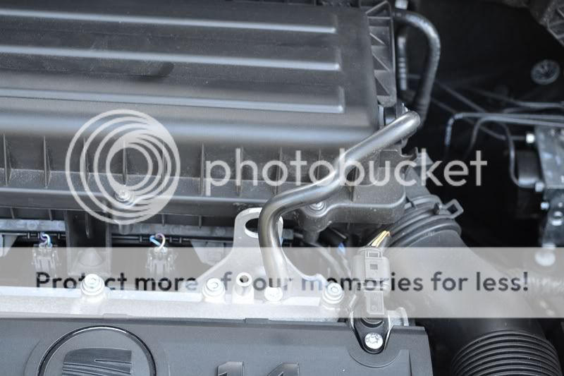

Remove the oil breather pipe (Thanks Elliot!), simply pull it off :

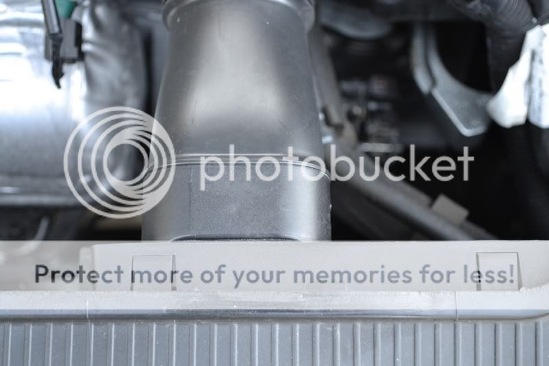

Next we need to remove the cold air feed pipe :

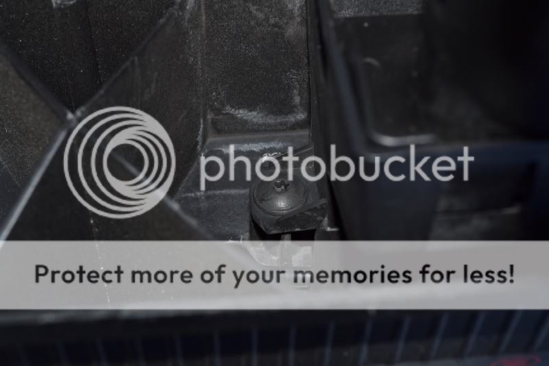

Facing directly infront of the car look to the left of the end of the pipe and you should see a Torx Screw. Take you T20 Screwdriver and remove this :
Once removed you will need to ease the other side off, it's kept on by a simple clip that pushes out and you should then have :

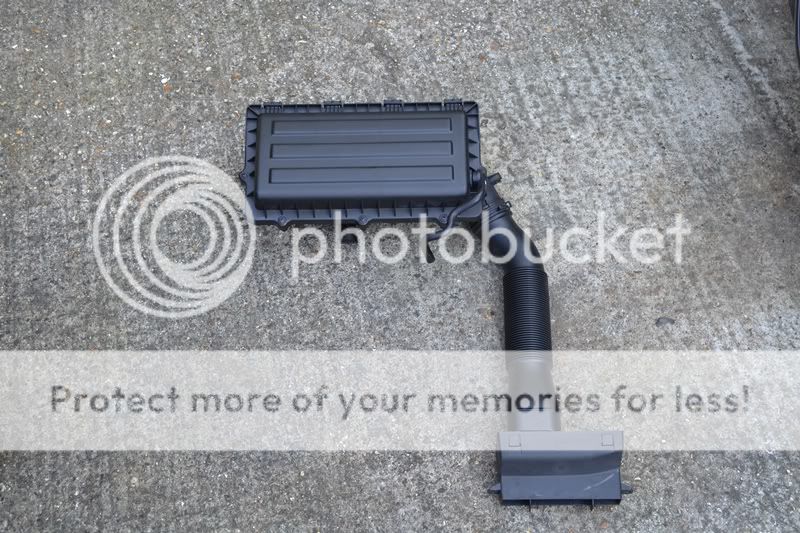

Place both hands on the airbox on either end and lift gently, the rubber bung in the middle should pop off it's holder :
You now need to manovure the box so you can lift it out of the engine bay and place somewhere safe :
Et Voila! All done :
