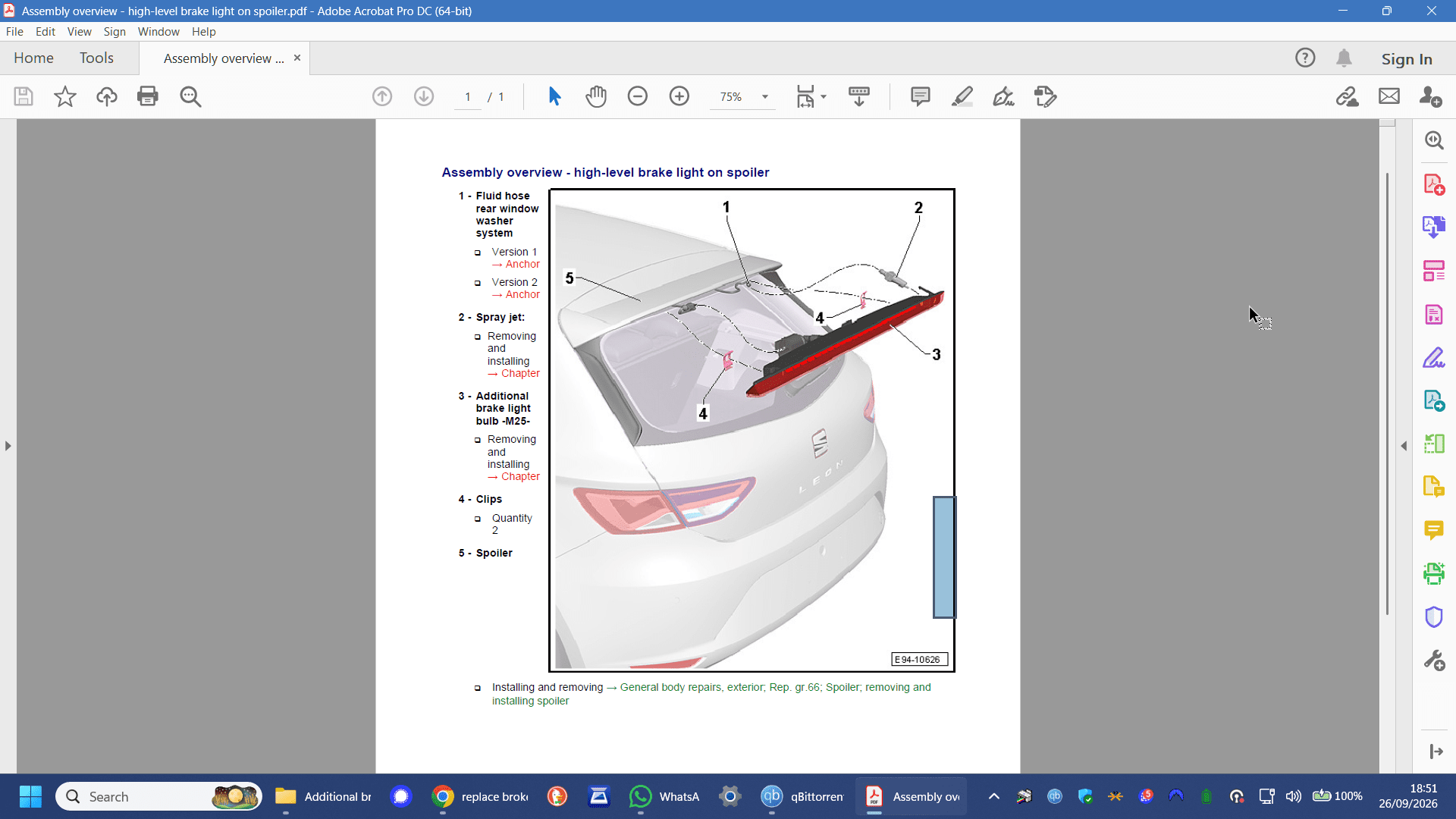

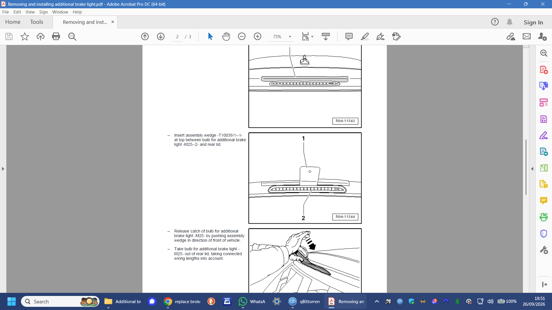

hi all, need to replace broken brake light in the spoiler, you must have to remove the spoiler to do this, how hard is it?
got new light from seat parts direct so should fit properly.
TIA.
The light just clips into the spoiler - use plastic trim removal tools to lever the light unit out. Just be careful the thin rubber seal is properly seated on the light unit when you simply clip the new one in place. Literally a couple of minutes job.

hi, thanks for your reply, bit confused as the new one i got from seat parts direct has two 4mm threaded holes that obviously take two machine screws, and only one metal clip in the middle of the unit, thats why im thinking the screws must go in from behind the spoiler...
