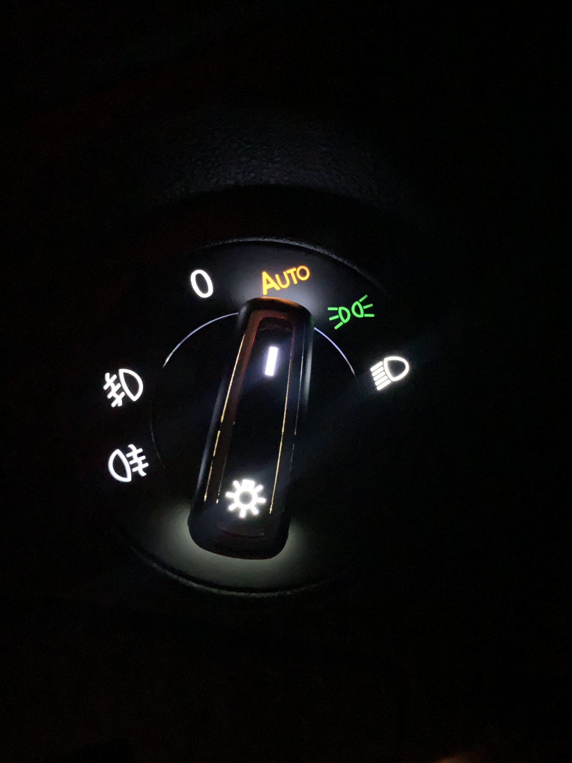

I managed to get auto lights and leaving/coming home lights. I bought this switch n sensor
After putting it in it started working straight away, but to get the coming home lights on I had to use carista. The switch itself is pretty nice looking aswell.

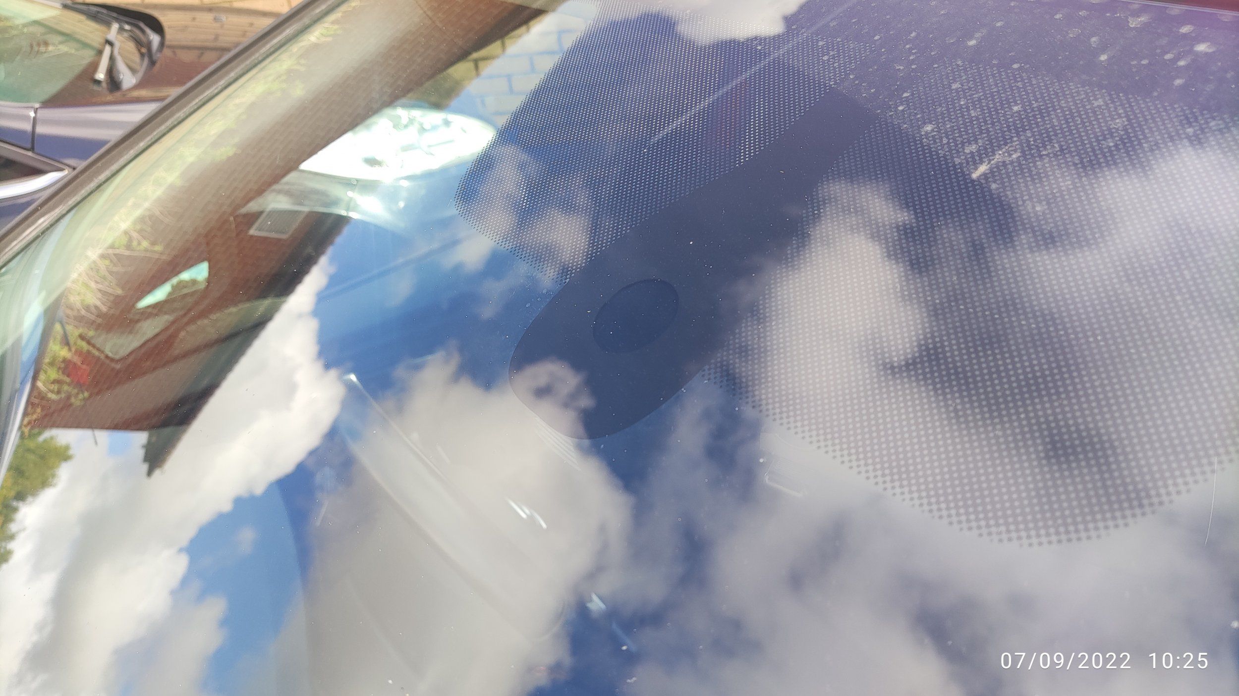

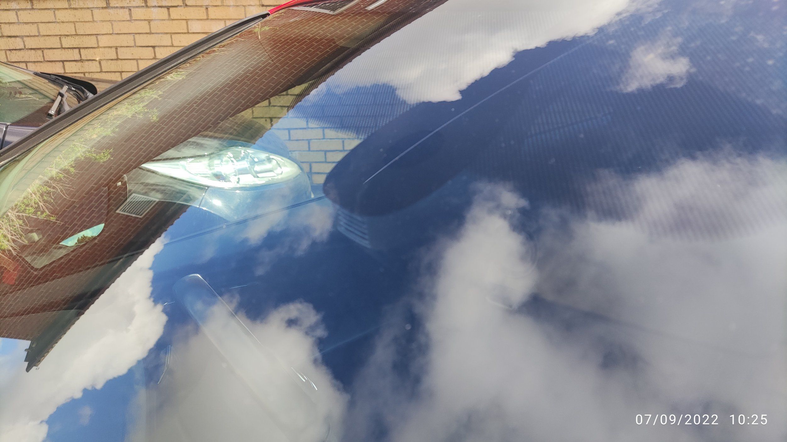

Hey all! I believe I already got the sensor on the windshield (some sort of sensor right below the rear view mirror), but got no idea what is it for ? No auto wipers are on the buttons, not autolight switch, car got no smart cruise control either. If I would to buy a light switch with autolight option, do I require any coding at all if that is the right sensor there ?
I had a sensor already there but it was only for humidity or something.... You'll need the sensor, the switch and a bit of coding, either VCDS or one of the dongle jobbers......

Im just not exactly sure of what is it for. It is facing the windshield to the outside but haven't got around to check what would the actual lights sensor location would be and looks of it
