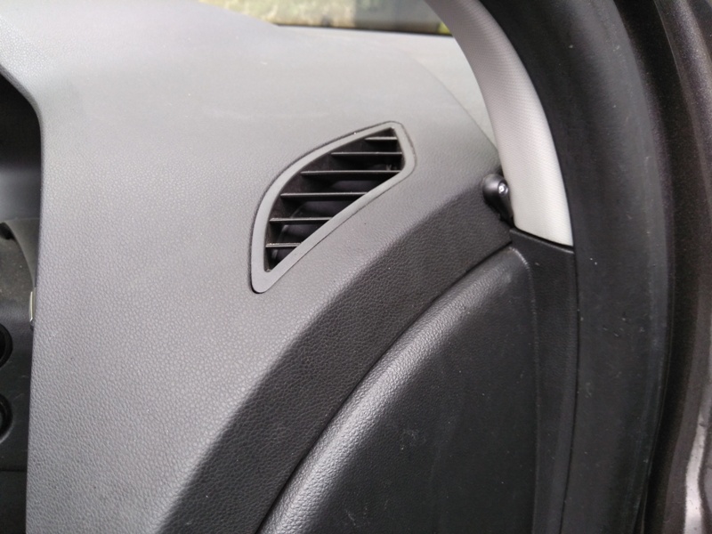

I've just fitted my auto headlight switch today and everything seems to be working okay, apart from the sensitivity. I was driving home this afternoon when everyone else had their headlights on, and I would normally too, but the headlights refused to come on. I therefore manually switched them on, not wanting my experiment to end up in A&E.
Obviously the problem is that in a typical corner of the windscreen position there is too much light getting to the sensor. Is not the answer therefore to position the sensor in a darker location? Alternatively I was wondering if the actual sensor could be covered with some slightly opaque tape just to reduce the amount of light reaching it. I'll experiment over the next few days as I'm sure there's a simple solution to this problem.
After a bit of experimenting around yesterday I finally found a location for the sensor that restricts enough of the available light to make it actuate the headlights at the right level of light outside. It's still very discrete, especially when the door is closed and a bonus is that there is no routing of the wire under the windscreen pillar trim to mess around with.
Like previous posters I lost two of the steel spring clips that attach to the plastic dash end panel but managed to fish them out with no trouble.
While driving around yesterday the headlights were coming on for me at sensible outside light levels so I'll see how things go over the next week and decide if any further positioning is required.
One additional bonus (IMHO) is that the dashboard illumination is now permanently on, with the switch in Auto. A downside is that the sat nav display is now in dark mode however I've changed the setting so it's permanently in daytime mode, day and night.
One other thing I've noticed now is that the illuminated headlight symbol does not appear when the headlights are on.
