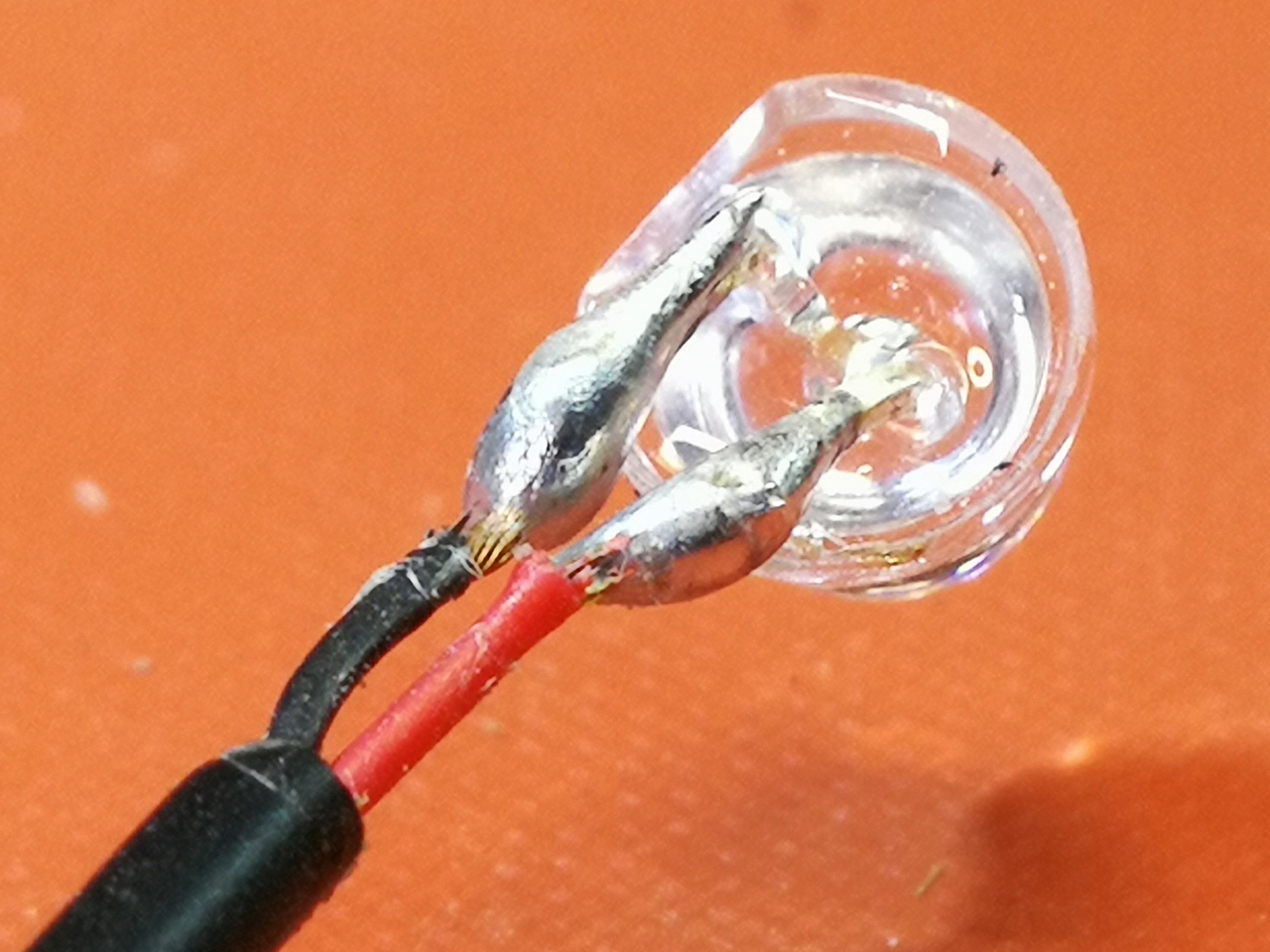

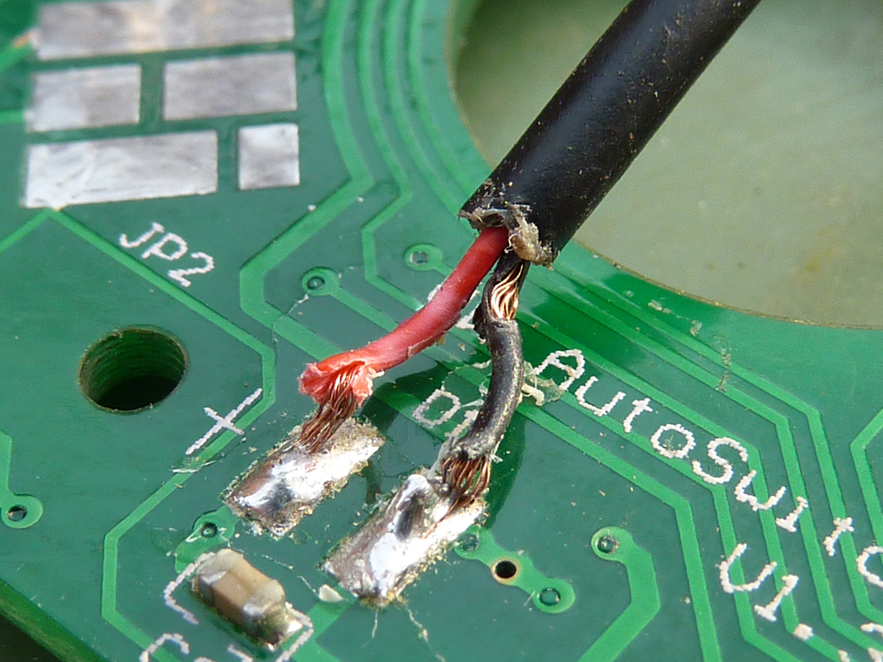

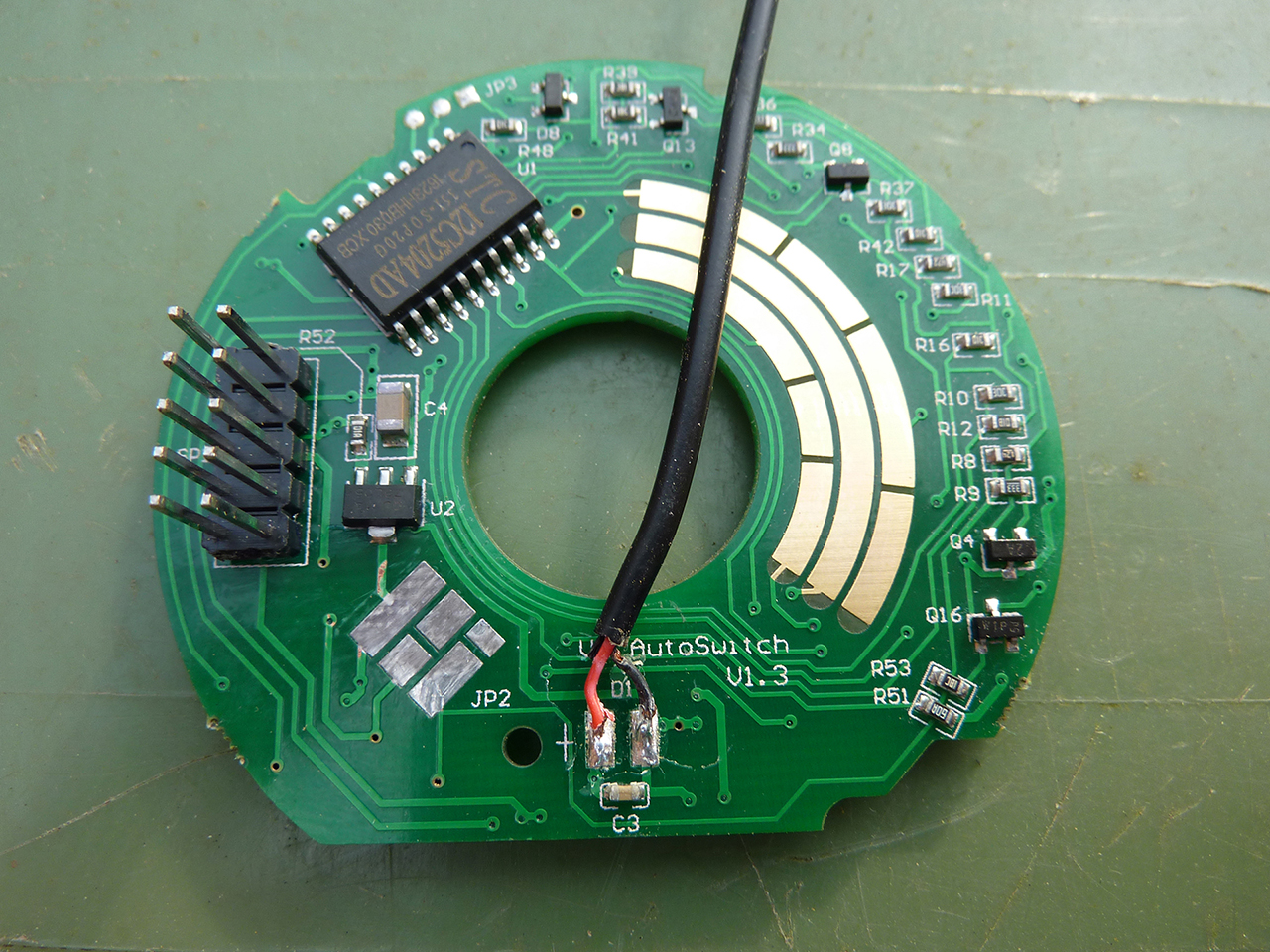

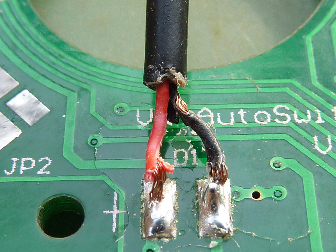

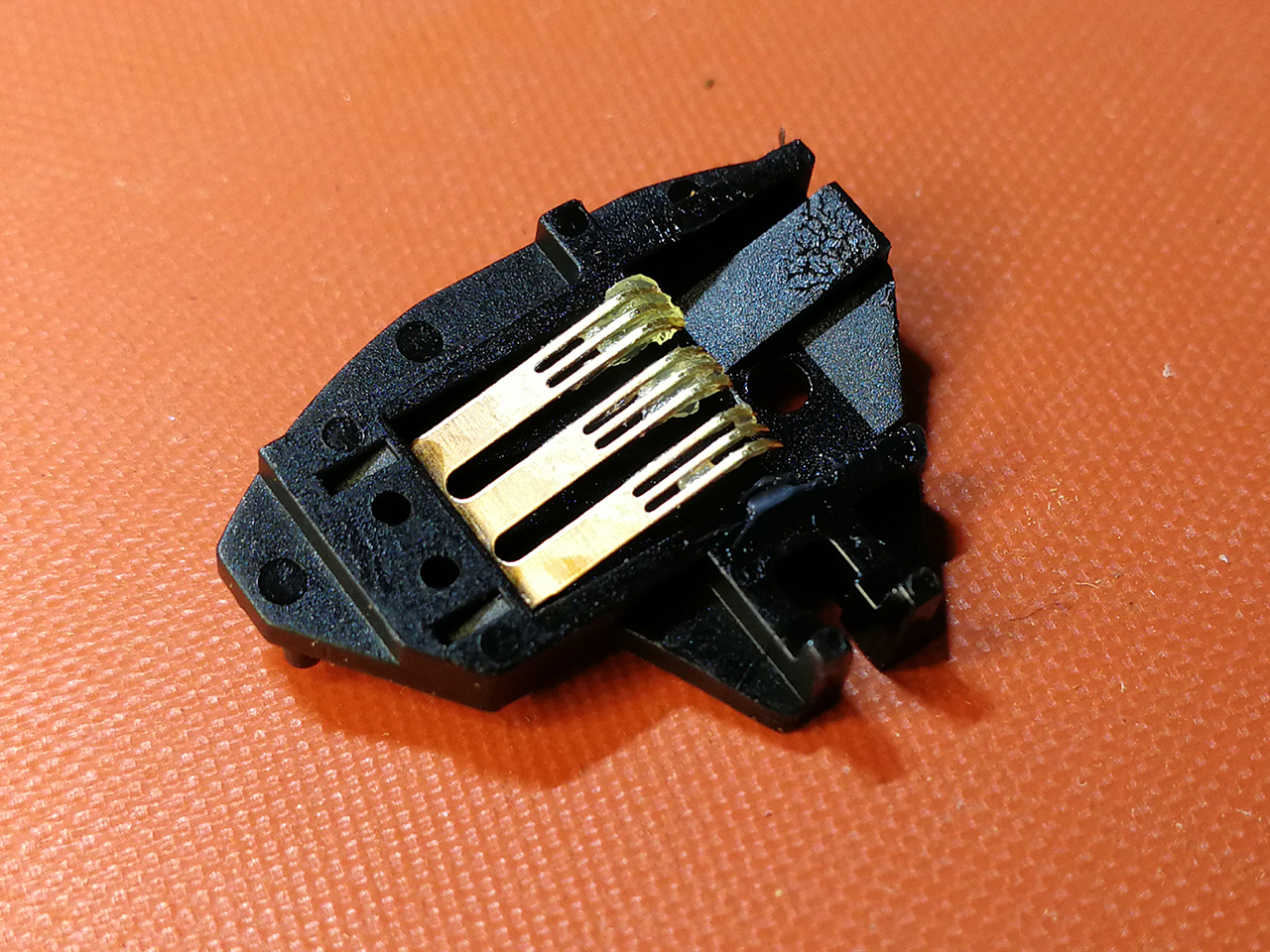

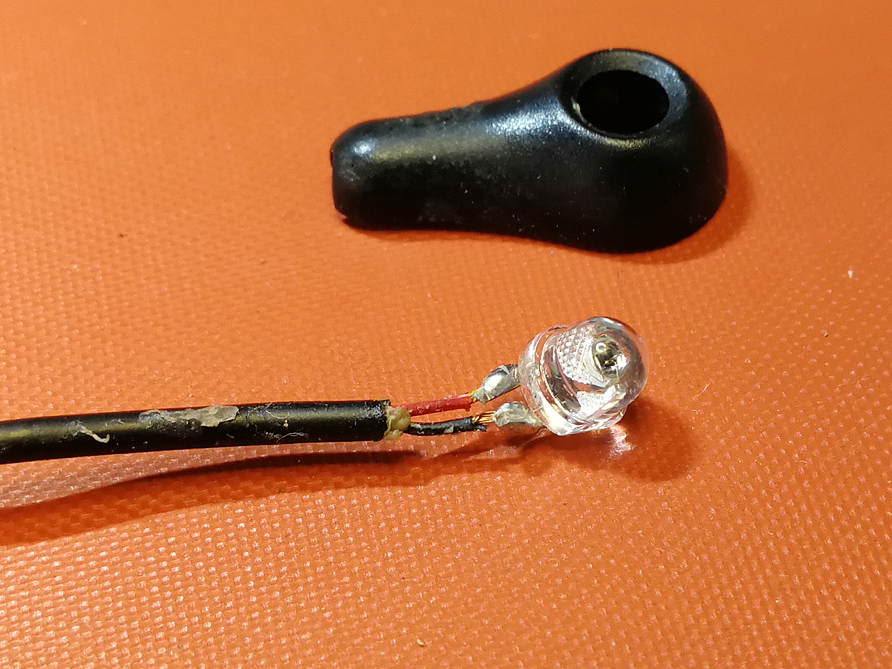

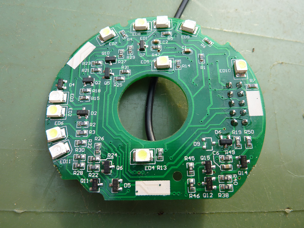

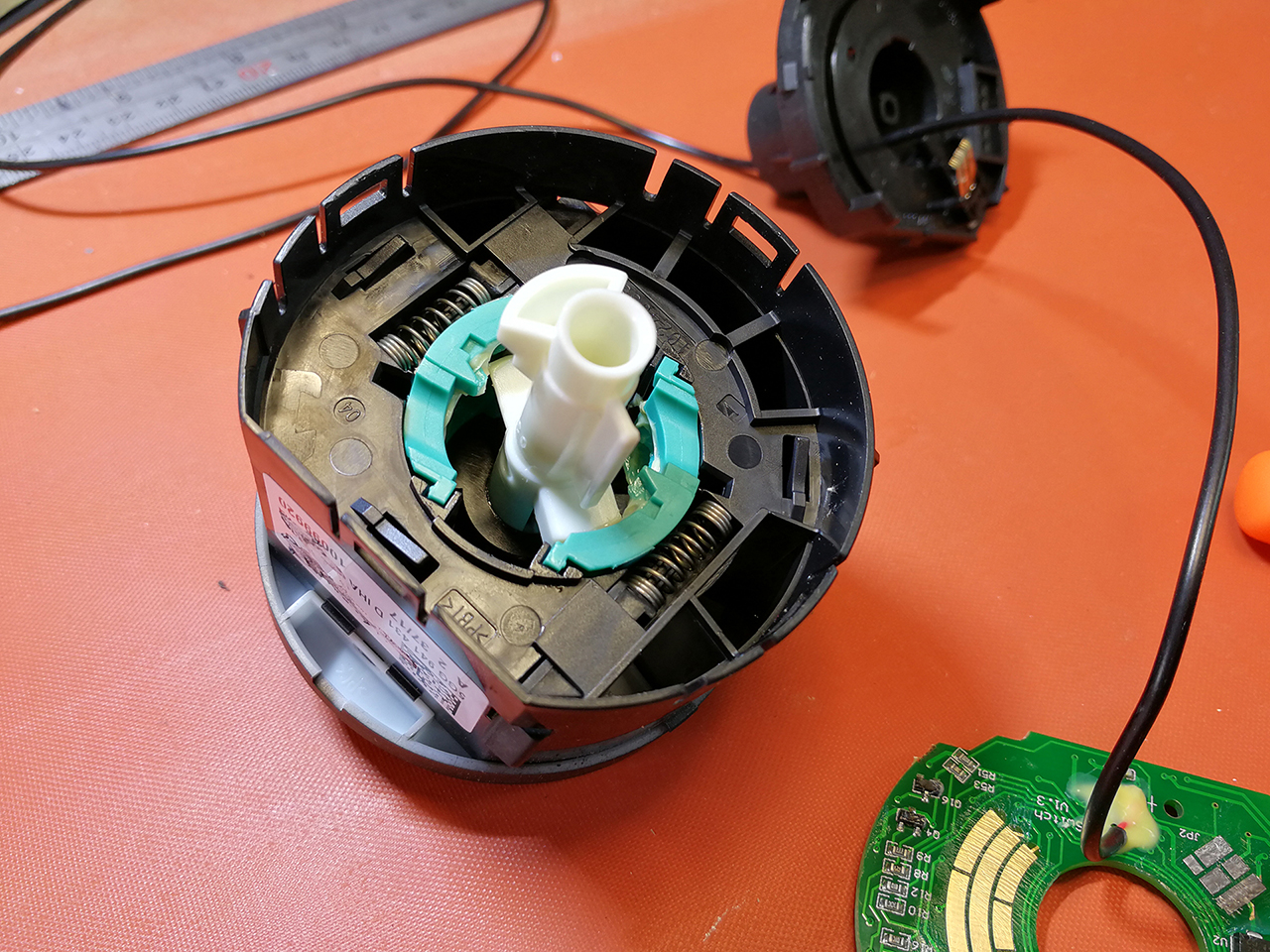

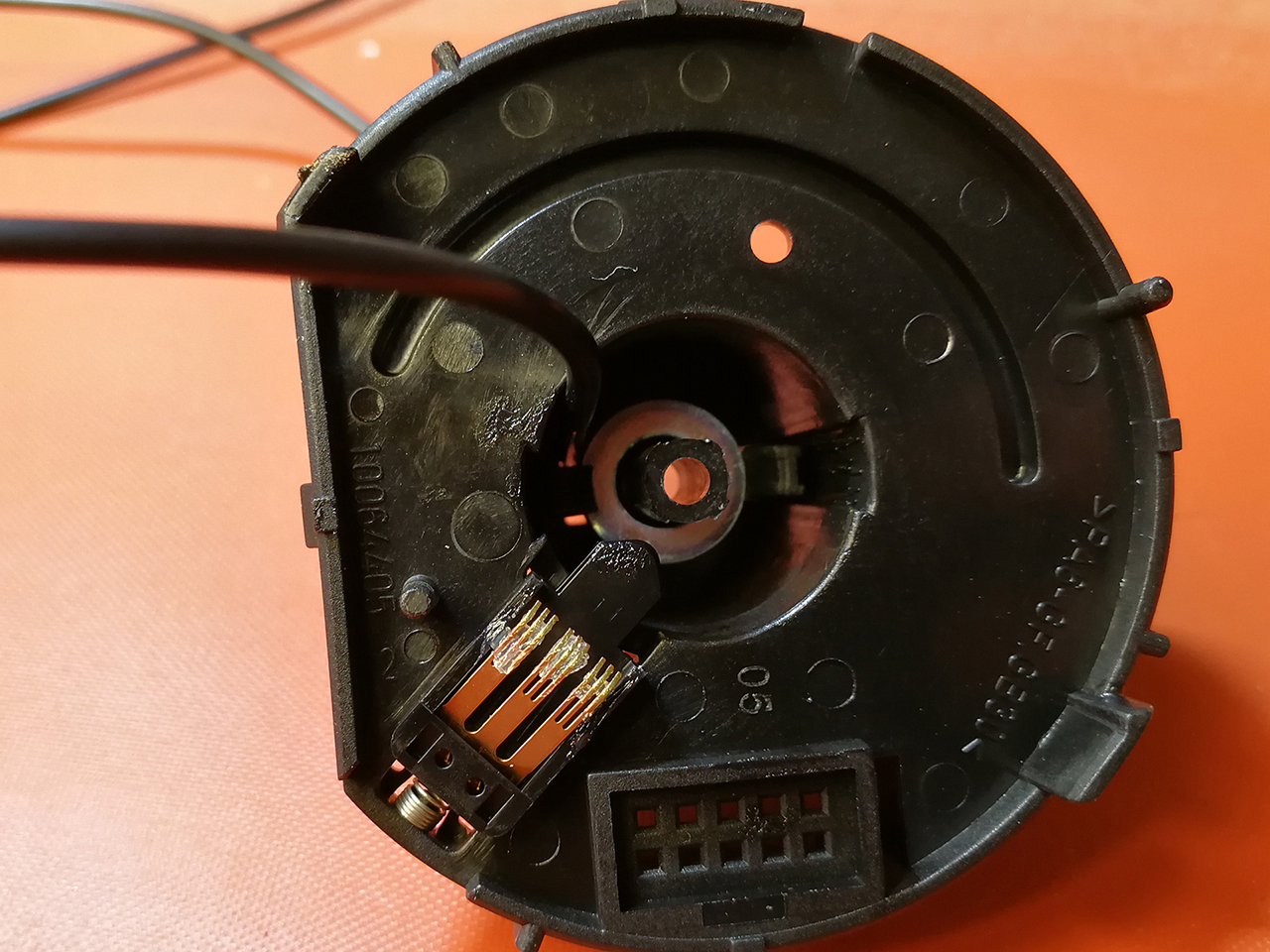

Well I thought I could stick it out, lol, but the extreme sensitivity of my Switch has beaten me. I have now re-installed my stock switch.
But the curiosity got me and I wanted to know how this switch was put together. so I stripped it.
The Photo Diode fell out of the housing.
Pulled the hot glue off of the wires.
All in all not as bad as I was expected. So maybe its the photo diode that's at fault. Maybe when they mod these they just use whatever diode they have handy at the time. And each one could have different specs.
Anyways a few pics if anyone is interested whats inside.

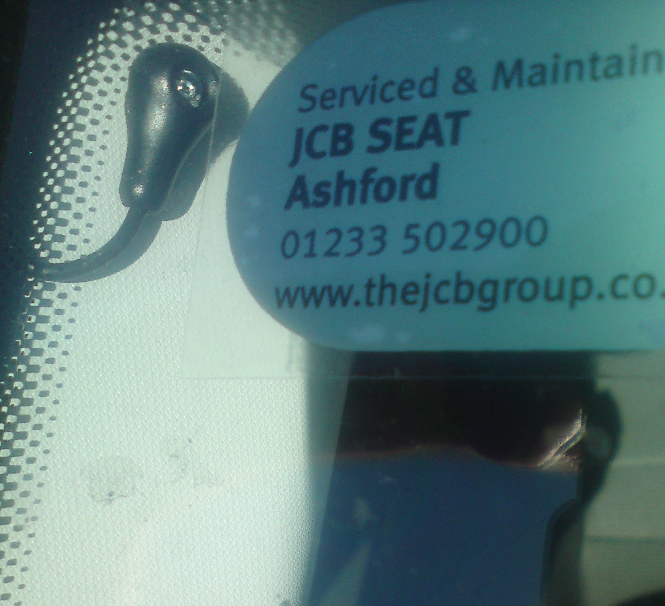

Finally fitted our new switch 2 weeks ago, using the sensor wire up the offside 'A' pillar/sensor
at the top corner of the windscreen method.
I chose to affix the sensor itself in a slightly different place to those already mentioned, (see
image) - but it all works OK and as has been mentioned by others was a clean,10 minute job.
Highly recommended mod for the modest outlay and the simplicity of fitting it.
