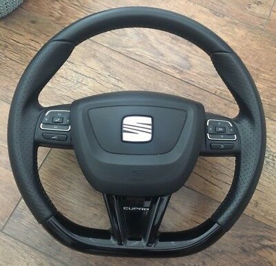

Iam happy owner on SEAT LEON 1P1.8TSI 2008 prefacelift with MFS.
I have bought cupras facelift steering whee as shown in the photos.
I am in search for an airbag at the moment plus trying to sort out every other module to be ready for the installation process + coding.
The list of things need to be changed is the same for the cupras MFS as is with FR’s?
MFSW Airbag Harness p/n 1K0 971 584 C
MFSW Control Module p/n 1K0 953 549 CH
Collector slip ring 1K0 959 653 C
CAN-BUS 7N0907530AF
couple morequestions:
Is it possible to use existing slip ring? Is it compatible? If I tape it to prevent it to move during the swap?
where is CAN-BUS 7N0907530AF locates?
what steps I need to follow to copy in VCDS existing canbus steering wheel settings before swap the new one?I need to done it one by one manually orthere is a backup restore feature possible? I’m not vagcom expert but can do couple things.
