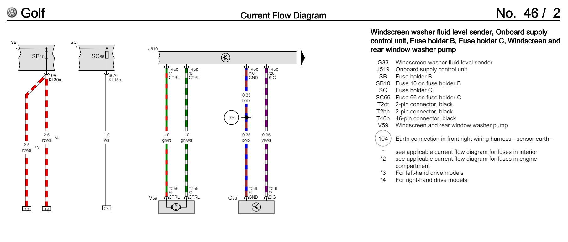

What pins for the wire did you use on the BCM T46B connector?
edit:

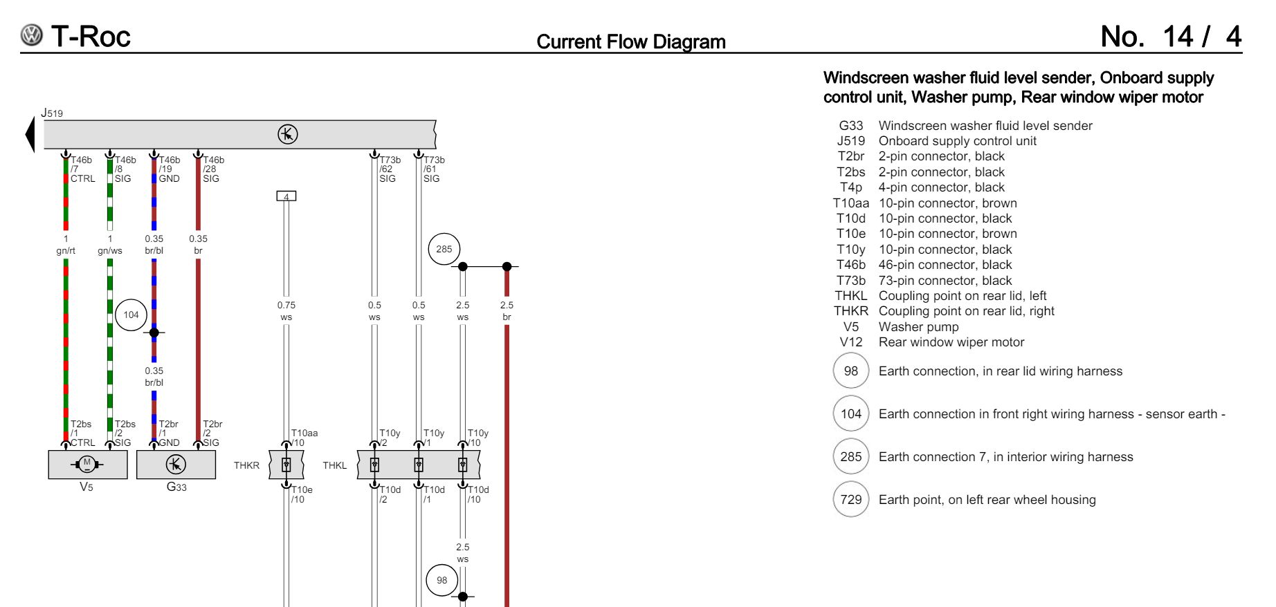

Okay, found it, MQS female pins. Looks like, there is a slight difference on sensor GND (10 or 19) wires, but SIG wire is always pin 28. I found T-Roc 2017 and Golf 8 2020 diagrams.

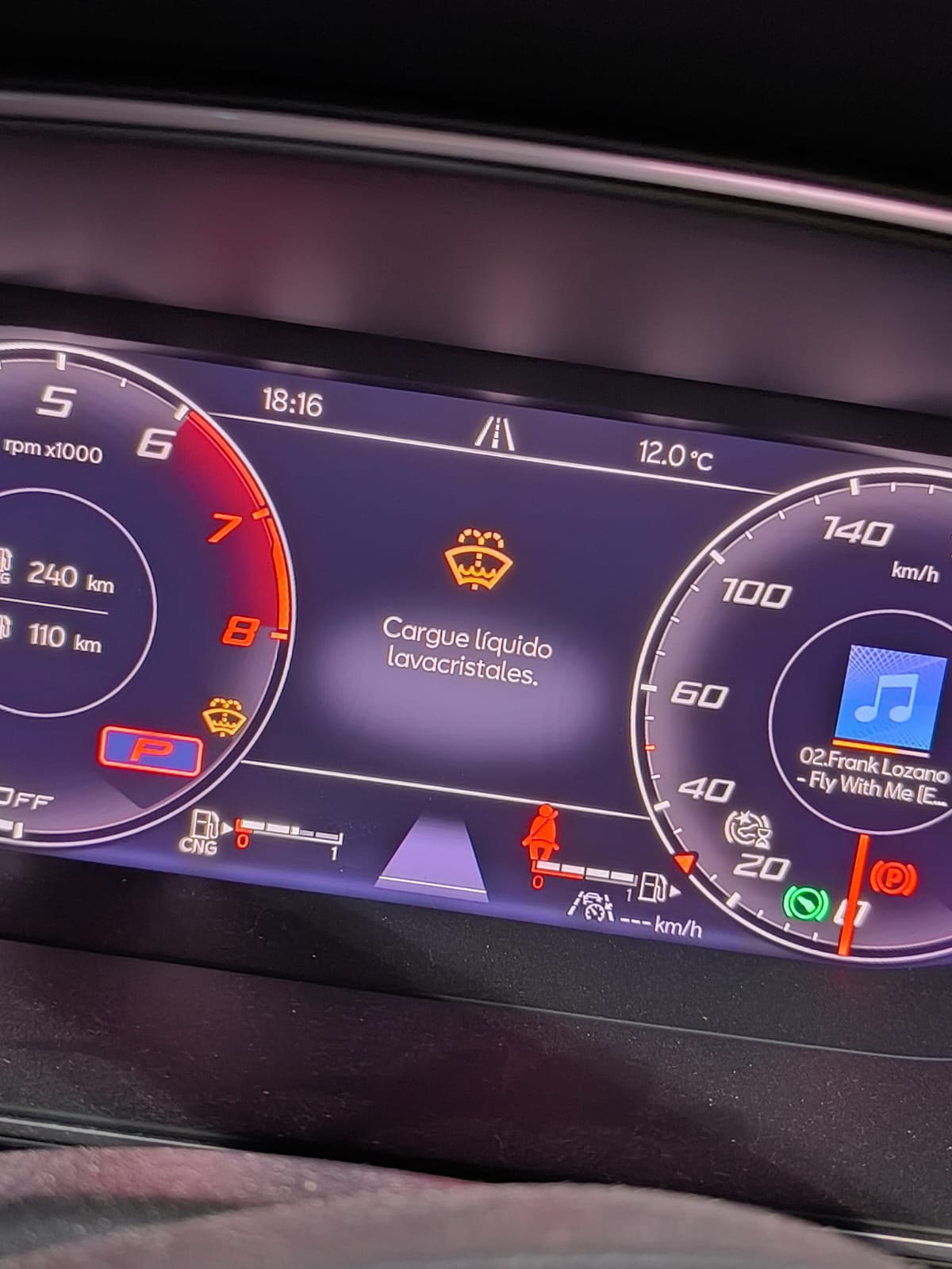

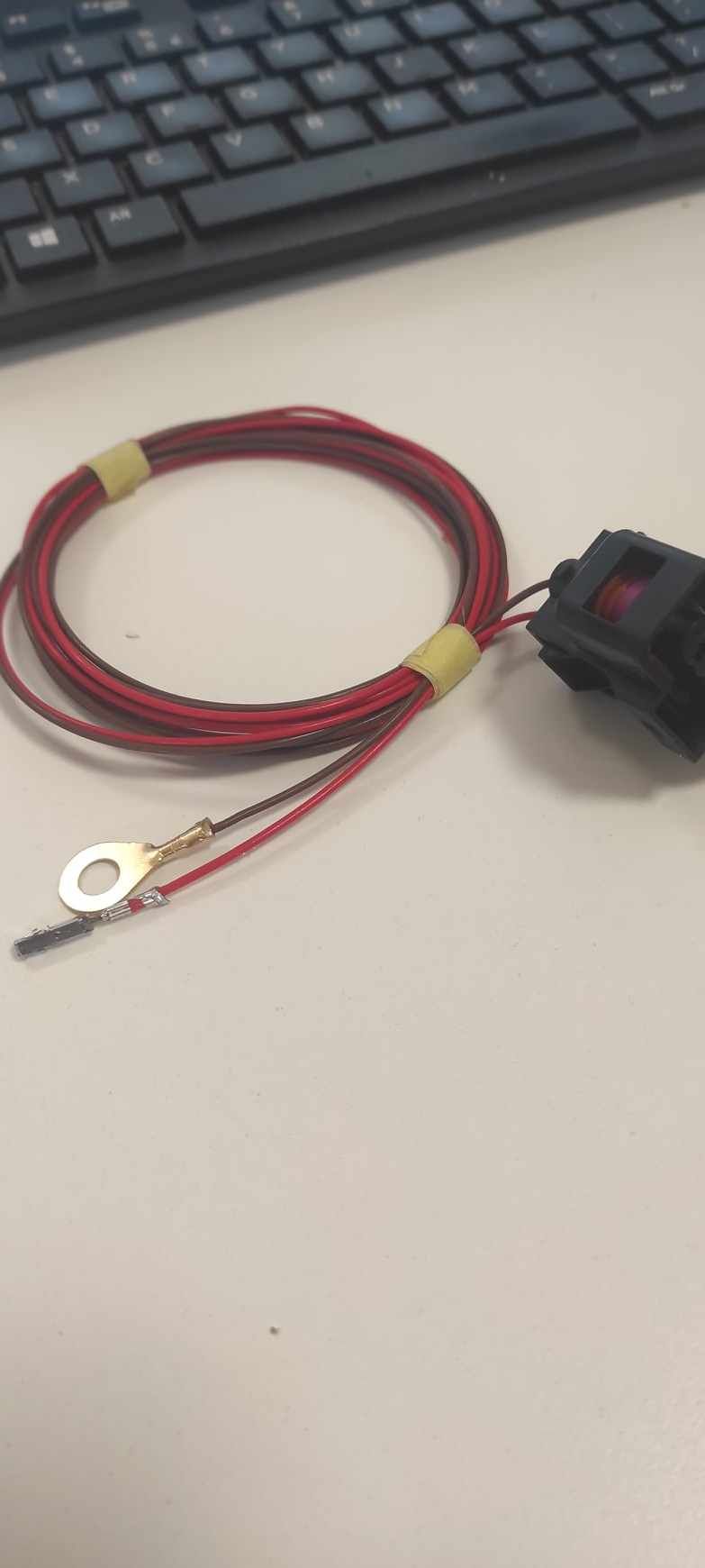

Hi. Today I installed the indication of the windshield washer fluid. The work is not difficult.
What we need:
1. Plug 1J0973202
2. Two 2-meter cables (or one double)
3. automotive cloth tape (for better look)
4. Two connectors for T46B plug
5. Something to coding (i have obd11)
6. Our tanks already have built-in fluid level electrodes.
We have to disconnect the battery, remove the left wheel, unscrew the front part of the wheel arch, remove the battery (it interferes with pulling the cable), unscrew the plastic under the steering wheel and the left part from the lever to open the hood. We remove the middle plug (B) from the BCM (t46b), unplug it, connect the cable to pins 10 and 28, pull it through the bulkhead to the engine compartment, lead it somehow to the washer tank (I led it through the top and went down behind the lamp just like the original washer harness), connect the plug and we code:
1. 09 central electrics
2. adaptations
3. hw_verbau
4. change insufficient washer fluid from to installed
I'm still waiting for my plug, so don't laugh at the connectors on the tank :)

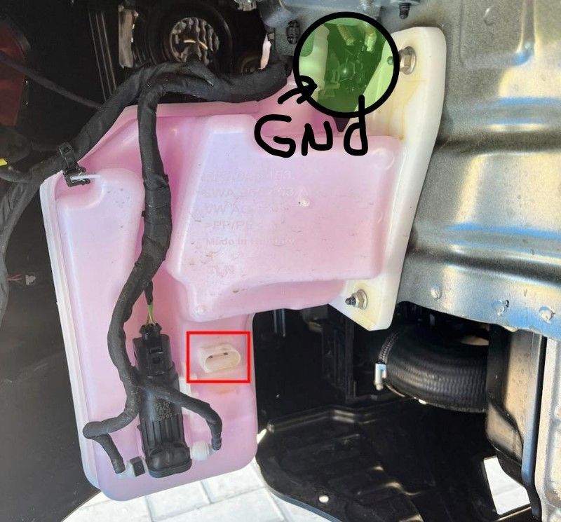

On the sensor G33, pin 1 is ground from the central ground point. Pin 2 goes to the BCM T46b/28. Data from an O4

Hi Witek,
Thanks a bunch for the detailed guide. Question, based on instructions from https://www.seatcupra.net/forums/th...windshield-washer-fluid-warning-light.476044/
should it be pin 28 and pin 19 (instead of pin 10)?
Or does it not matter or is it different for cupra and seat models?
witek_77
Jul 11, 2023
129
56
PL
you show a picture of ELSA from VW T-Roc. This is MQB platform. ours is MQB_EVO. It may be that pin 19 is common with pin 10 but I don't know that. unfortunately my ELSA does not show what is common point 104 marked on the diagram. do it the way the factory would like it to be, i.e. 28 and 10. it definitely works
