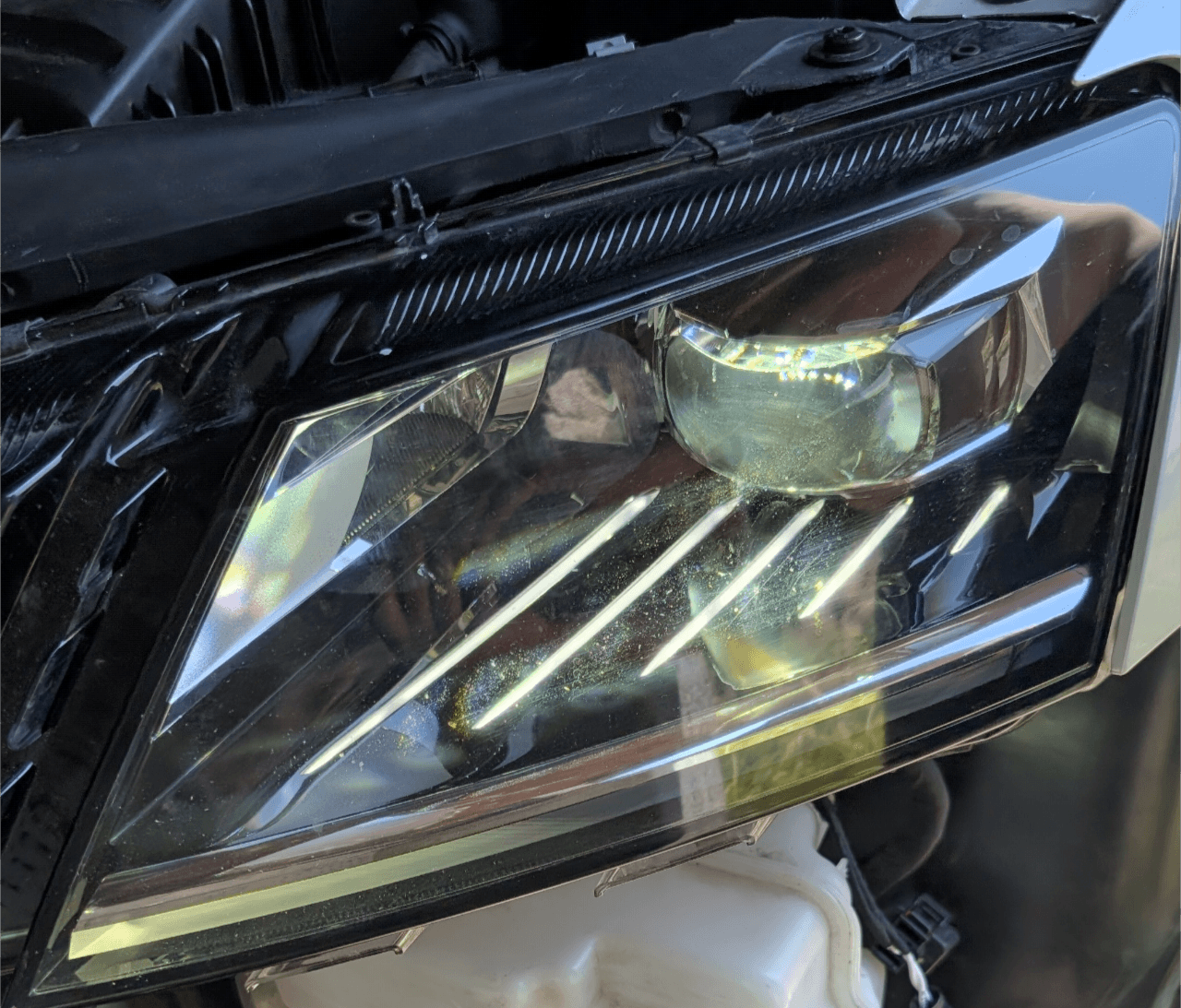

Good morning...
yesterday, things progressed a bit. I took out the battery, then I could see the exposed rubber plug in the interior...
all the new wires in the front were protected with a slotted corrugated tube and pulled into the interior...
so everything in the front should be done...
next, I'll take care of all the BCM changes and install the 4B...
then the rear axle sensor, coding, and testing, and finally, the assembly.

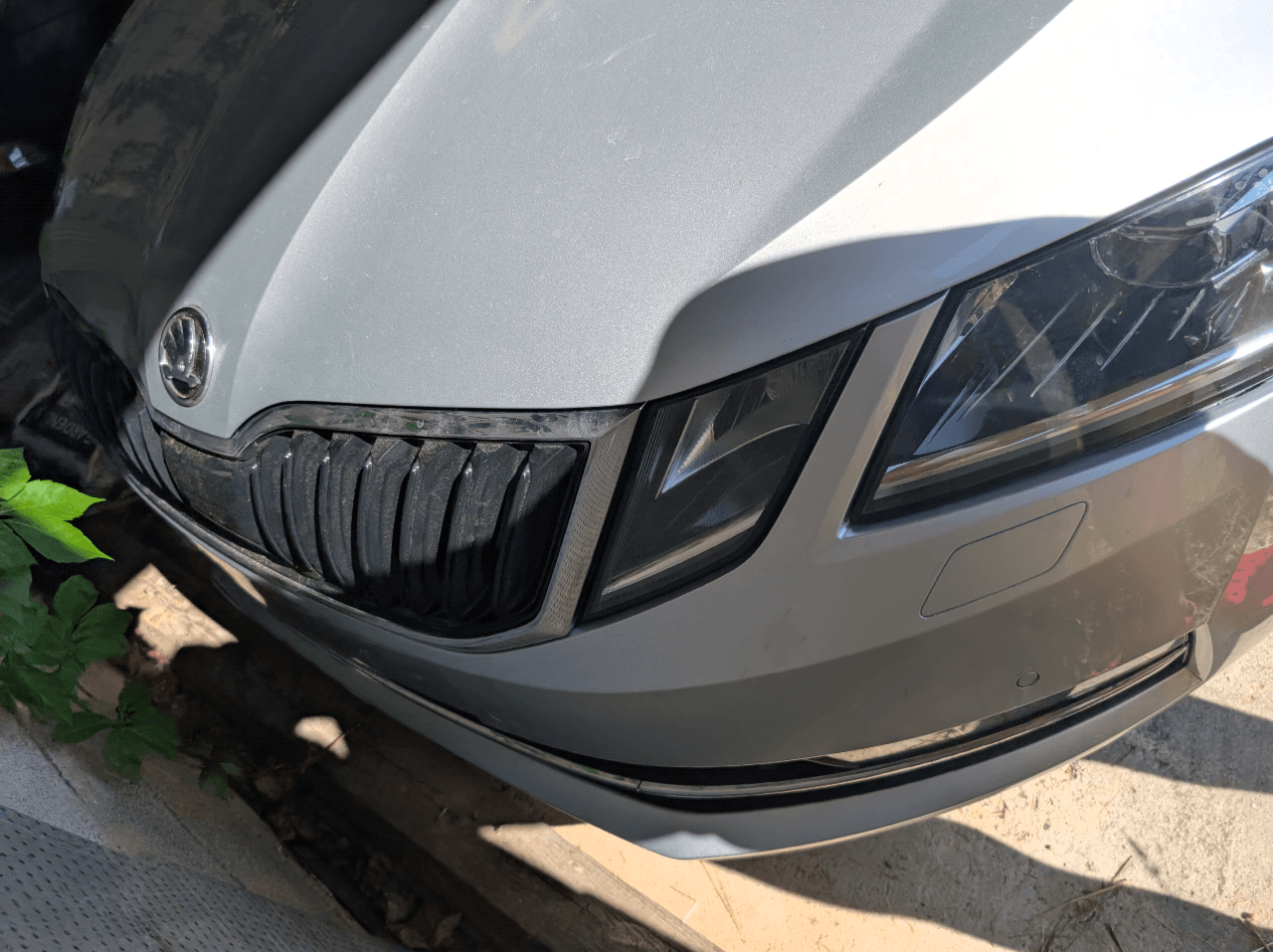

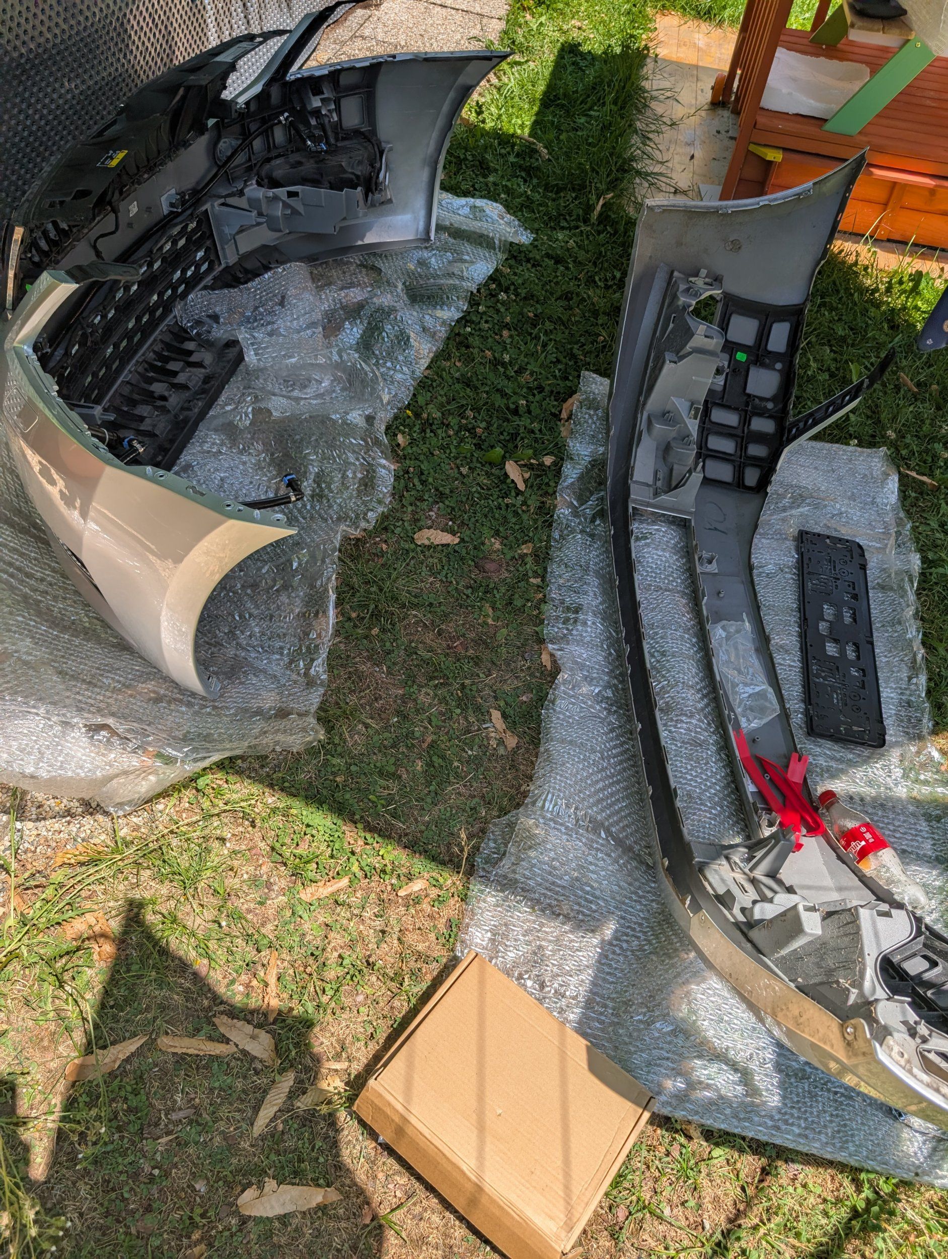

So, let's move on. The bumpers have now been aligned. The headlight cleaning system has been fully connected, and the pump has been checked. Everything's fine. Now, after lunch, we'll move on.
So, the bumper is back on and locked. Everything's working, and it's just an error in unit 4B because the rear left axle sensor is still missing. Unfortunately, I have the wrong connection for the headlight cleaning system on the pump, so I'll change it to
