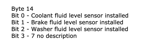

With regards to pre facelift setup this is the setup on my 2014 OBD11
Control unit 09 (BCM)
Long Coding

And just to update you can find all the long coding details from your phone using OBD11
Or they are recorded here http://obdeleven.proboards.com/thread/3262/control-unit-setup
Cracking guide..... looking through OBDEleven..... under Control Unit 9, there's an Adaptation HW_Verbau which has an option for 'Insufficient washer fluid'. Don't know if setting this to 'installed' would do the same as VCDS, if you don't have access to VCDS.
EDIT: More for face lift cars, as I don't think you can do long coding on them
Thanks for the input, that could certainly help people without access to VCDS.
