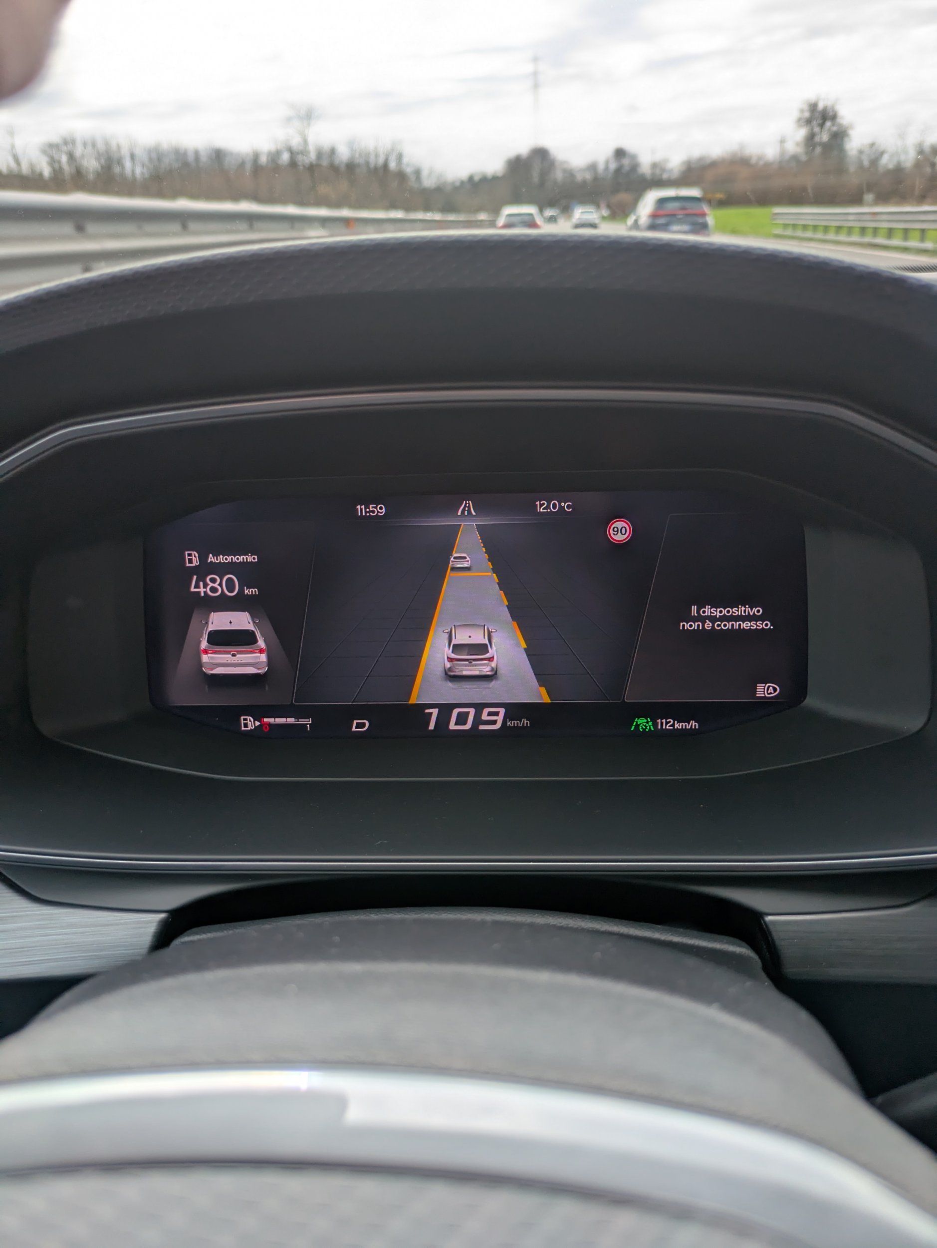

hi all I have a Cupra Leon 2023 with safe & driving pack L. I installed the capacitive steering wheel and coded as per the guide, everything works correctly. however, I noticed that in the highways, with "travel assist view" the left and right lanes do not appear and consequently the vehicles that I overtake or that overtake me do not appear, how can I solve it? thanks

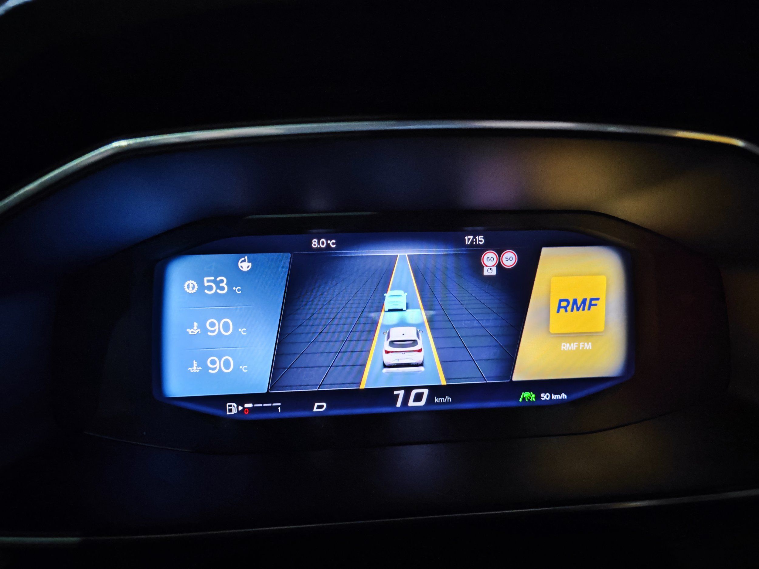

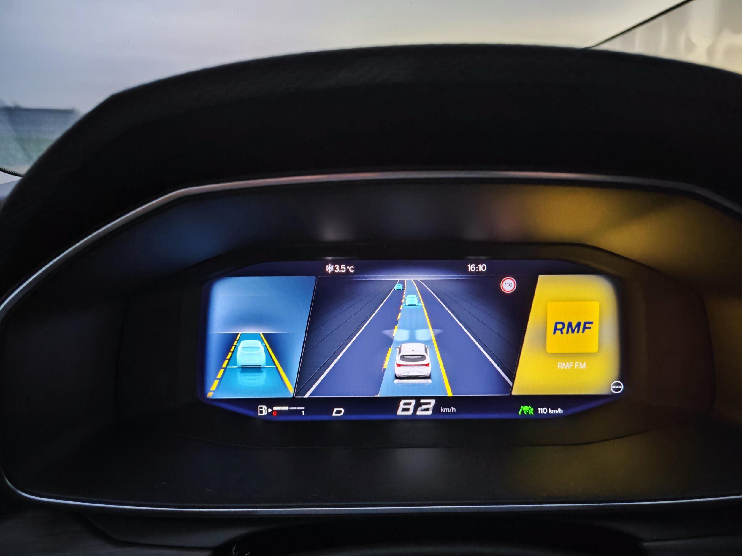

it depends on the road. on a regular 2-lane road it doesn't show. when you get on the motorway it shows additional lanes. I have the same. I don't know if it depends on the car's navigation which informs the car about the type of road.
Reactions: asganaway2019
Not all cars show this. I never understand why.
Do you have Blindspot and ACC? If not I think it's in there

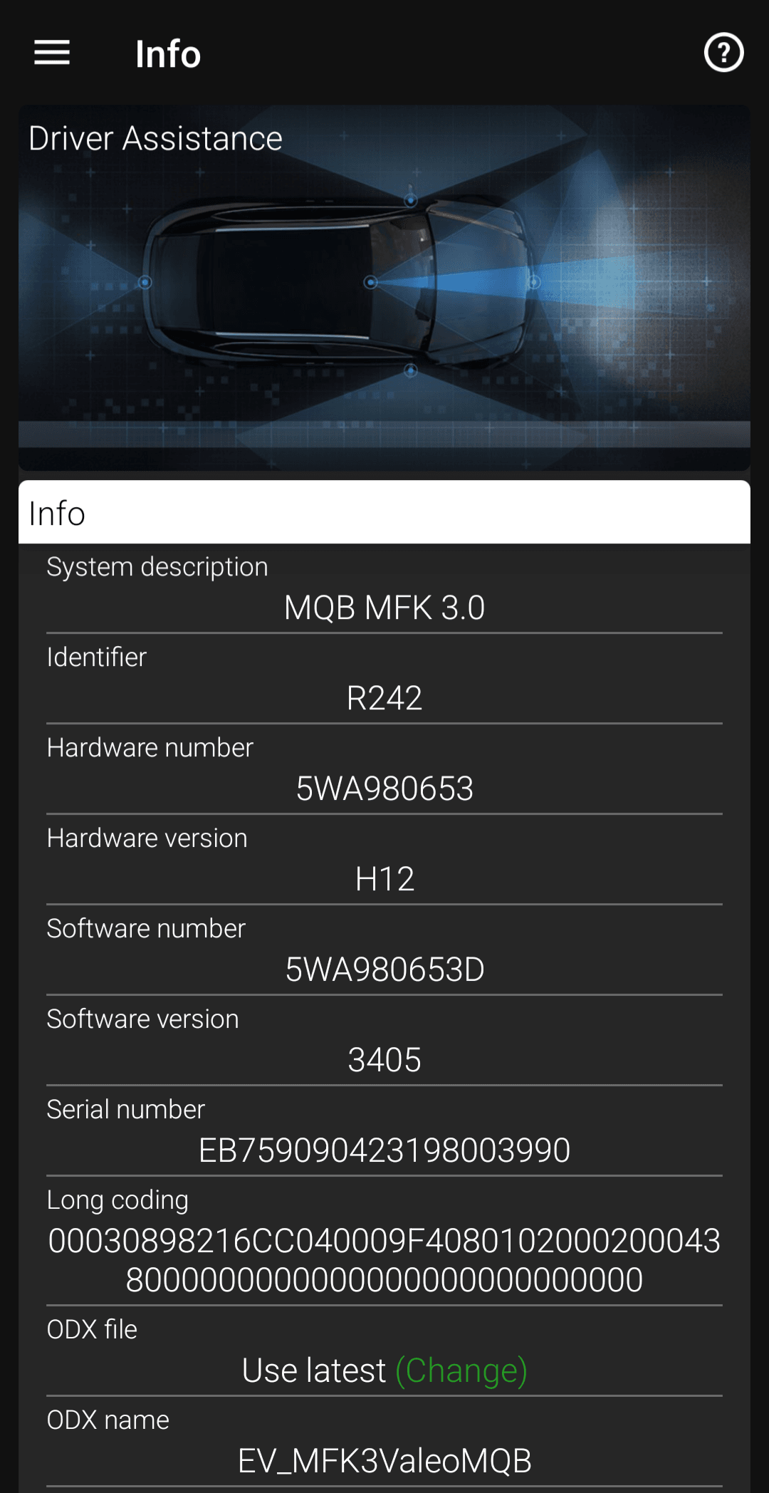

yes sir, L pack, I have to admit that I only tried it on a 2-lane road in each direction but it was not a real highway, from the manual I read that the technology uses the navigator's data for what it considers highways, I'll just have to try it again, in theory with the a5's software (3405) it should be supported assisted lane changing as well...
Only highway ideed works and lane changing only when coded right
i tried on a real highway and the multi-lane view appeared correctly.
regarding lane change i coded the following:
A5 (software 3405), long coding
hc_variant: variant_5
hc_mob_line: coded
44, adaptation
qfk_ma_function: active
the lane change option appears in the travel assist menu as well as the arrows, but operating the turn signal nothing happens, any suggestions?
