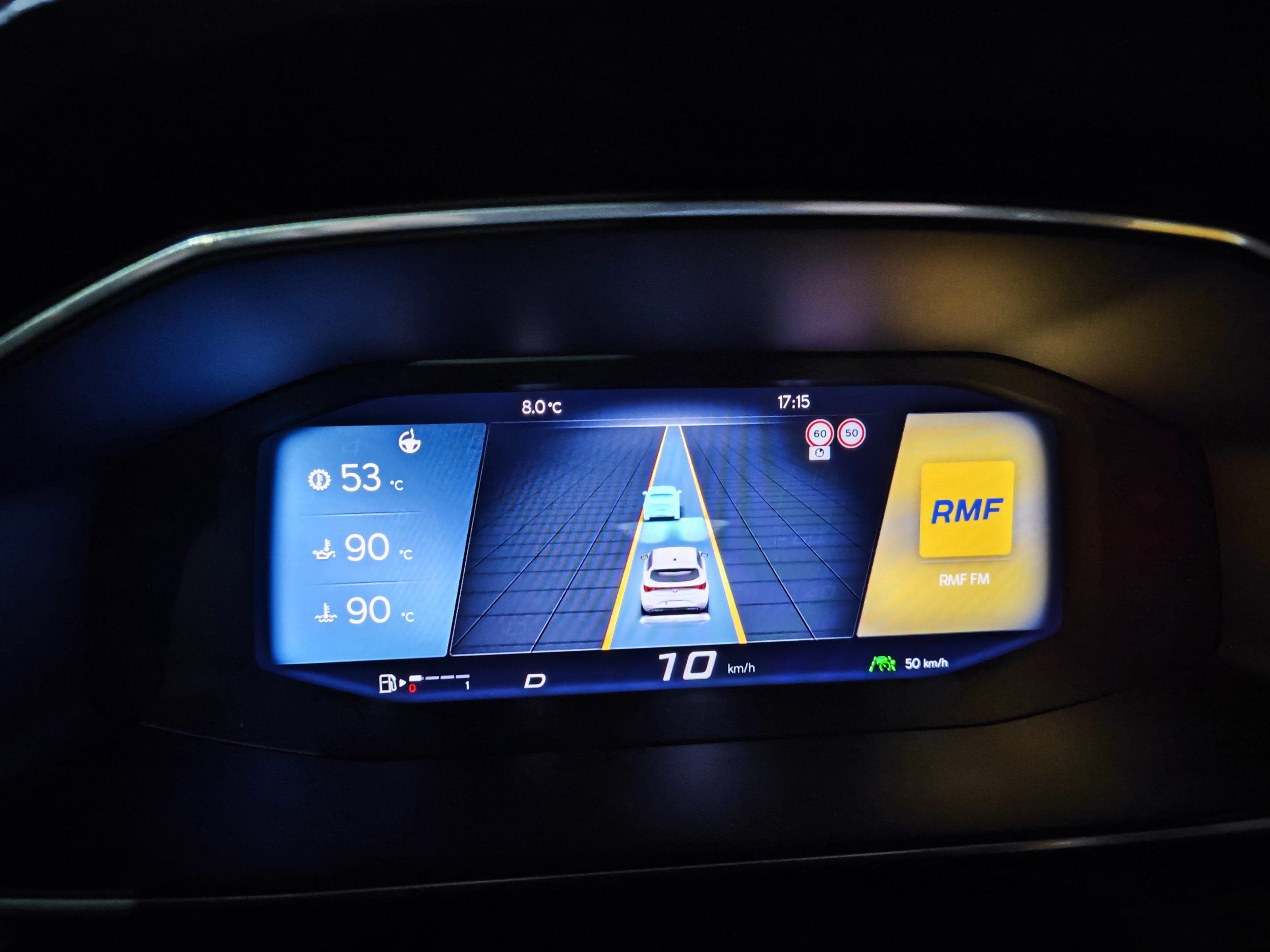

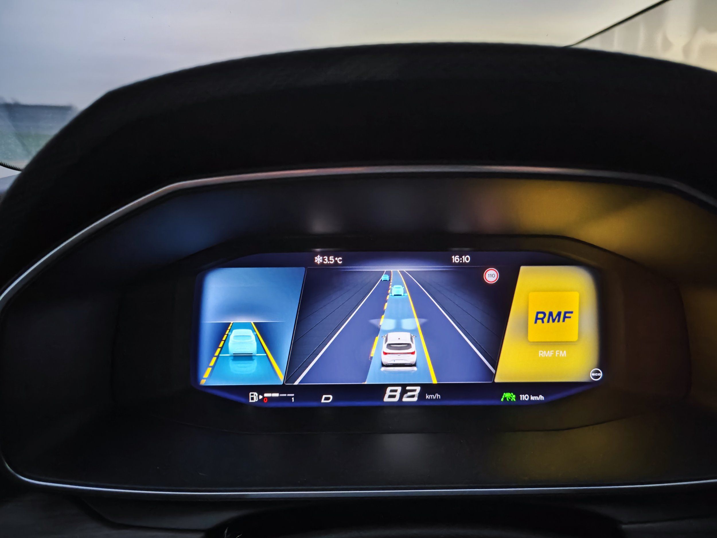

hello everyone, sorry for the delay in giving you feedback, I had a chance to better test the automatic lane change and it works all right, one question, what is the difference between Hc_variante 3 or 5? I tried with both and it works with both
thanks
