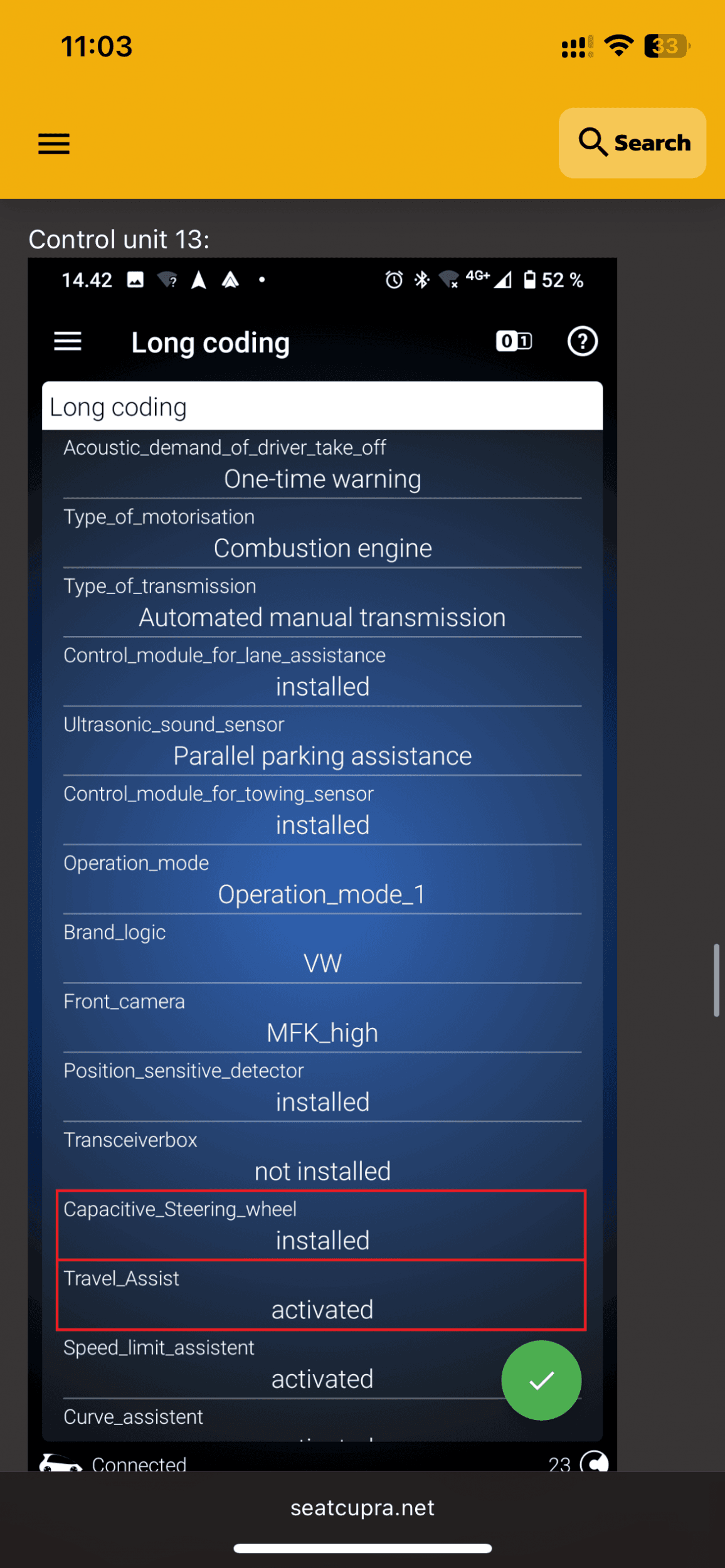

Hello everyone. The capacitive steering wheel setting always jumps to not installed, but everything still works.
May 27, 2025
7
Unit 13
Capacitive Steering Wheel option jump allways to not installed.
May 27, 2025
7
I don't know. Everything always worked, so I never checked. Is this setting even important if everything works?

Same here, jumps back to not installed, but functions well.
However i read above that the torque for fastening should be 30nm. I watched a tutorial which stated 50nm and i used that to fasten it. Should i be worried for overtightening or is it a small difference?

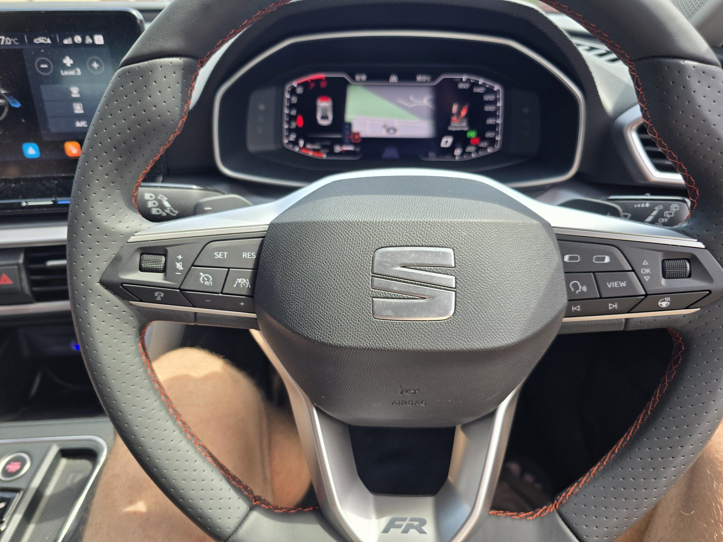

Hi. I have seat leon fr 2022 dsg and I swapped steering wheel to capacitive steering wheel.
And try to code with obd11 how it shows but its does not working .
When press Travel Asist button on steering wheel i get message on dashboard "Travel Asist is currently unavailable "
And when I press acc button on steering wheel I get message "ACC is not enabled"
In I have orange light in the dashboard about Travel Asist
Can someone help me to code?
Thanks

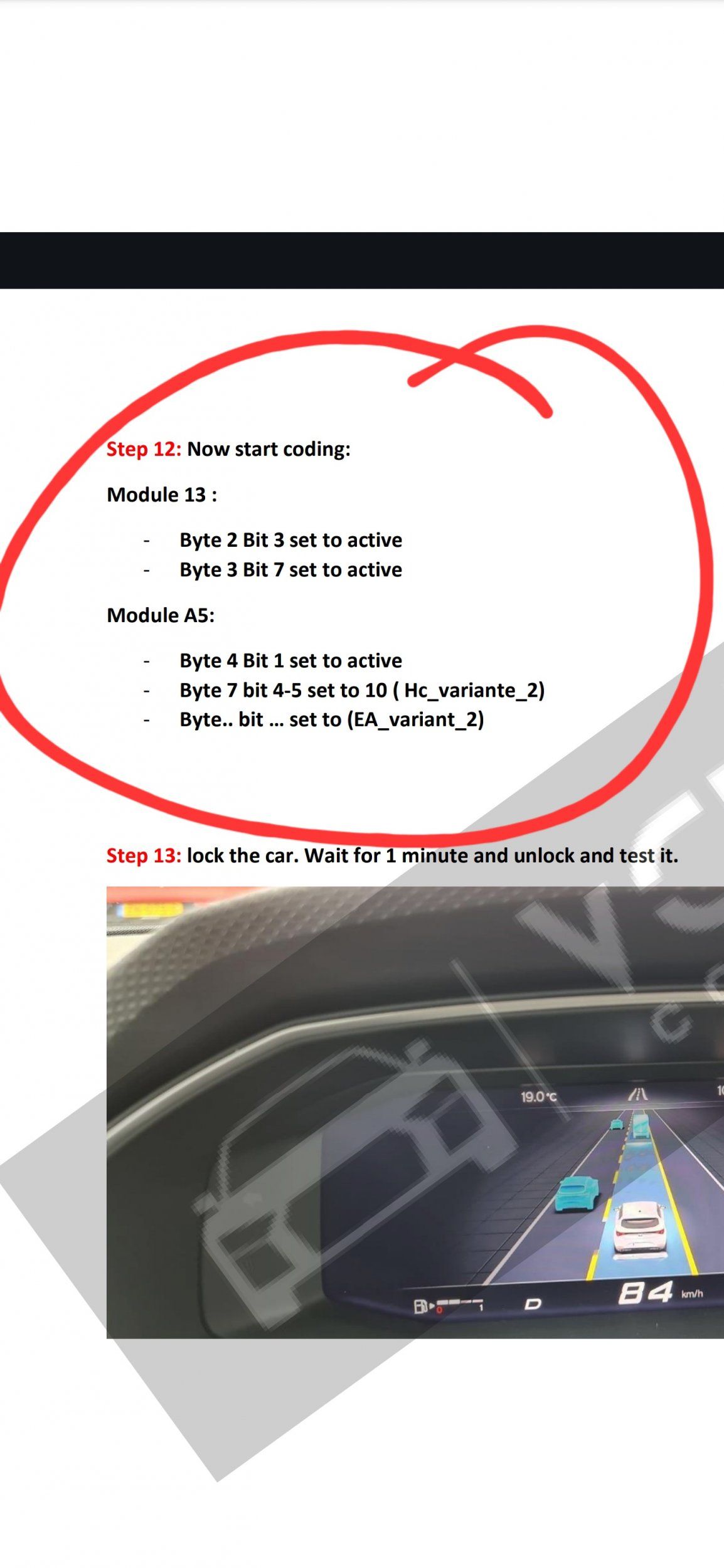

Everything you need is in this topic

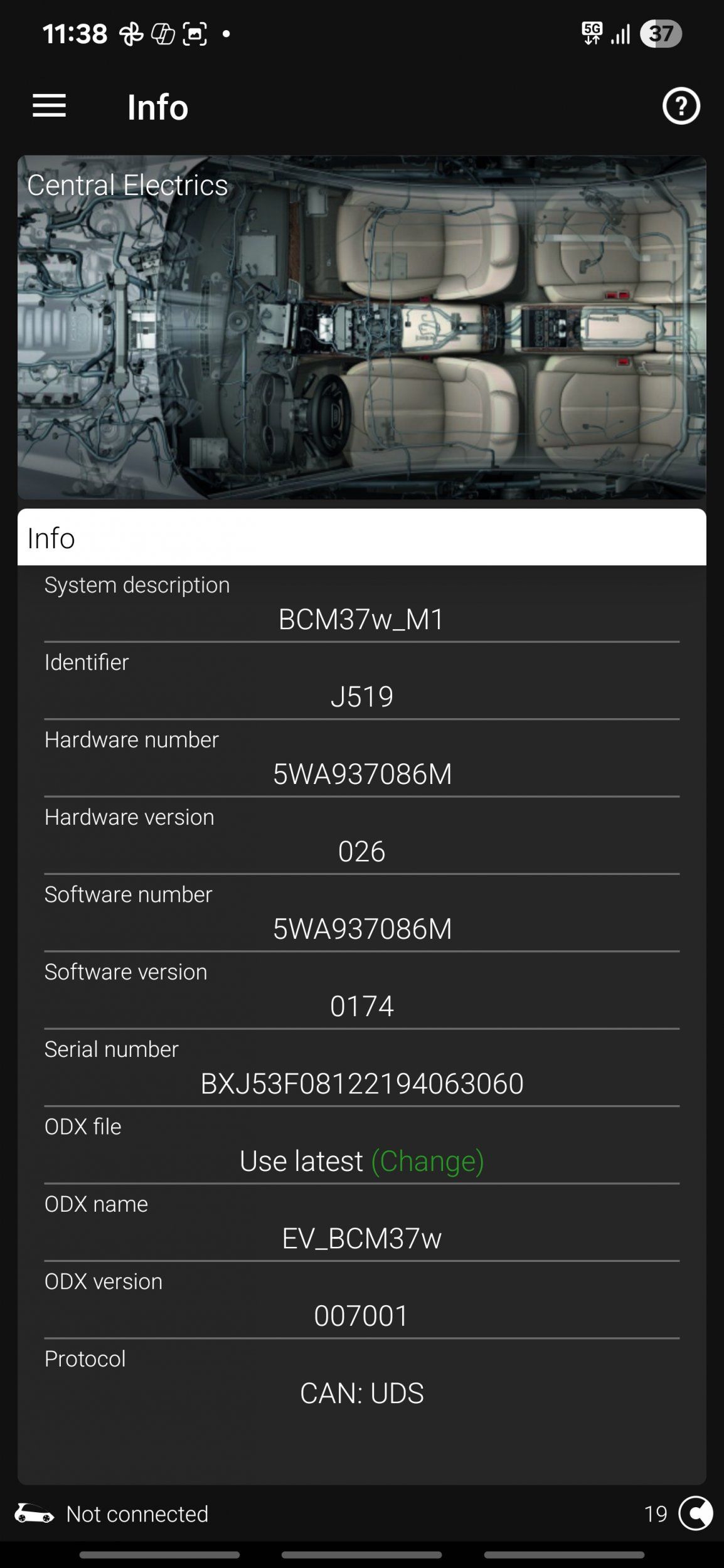

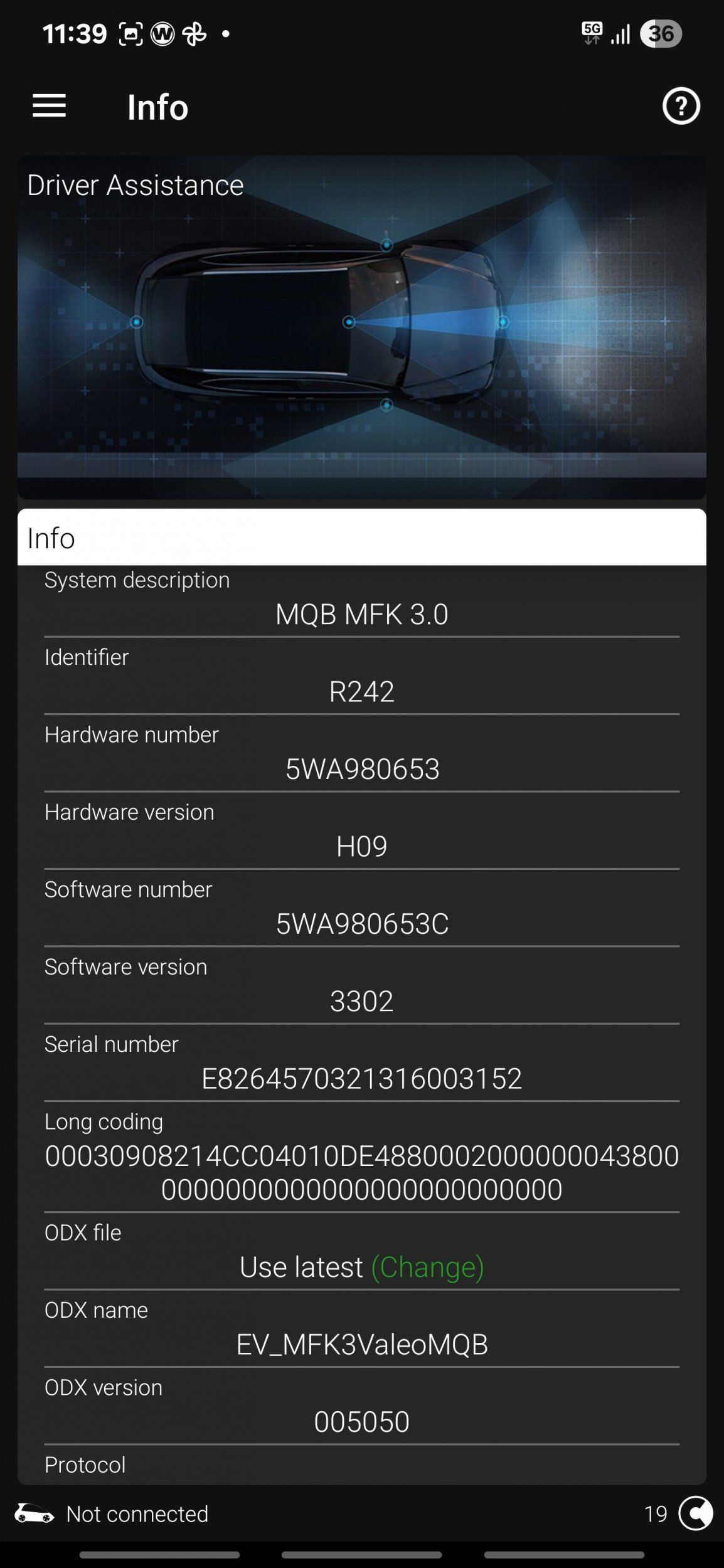

Hi. Thanks for reply.
I'm done and try everything what I found in this topic with the codin. But still have same problems like in the pictures.

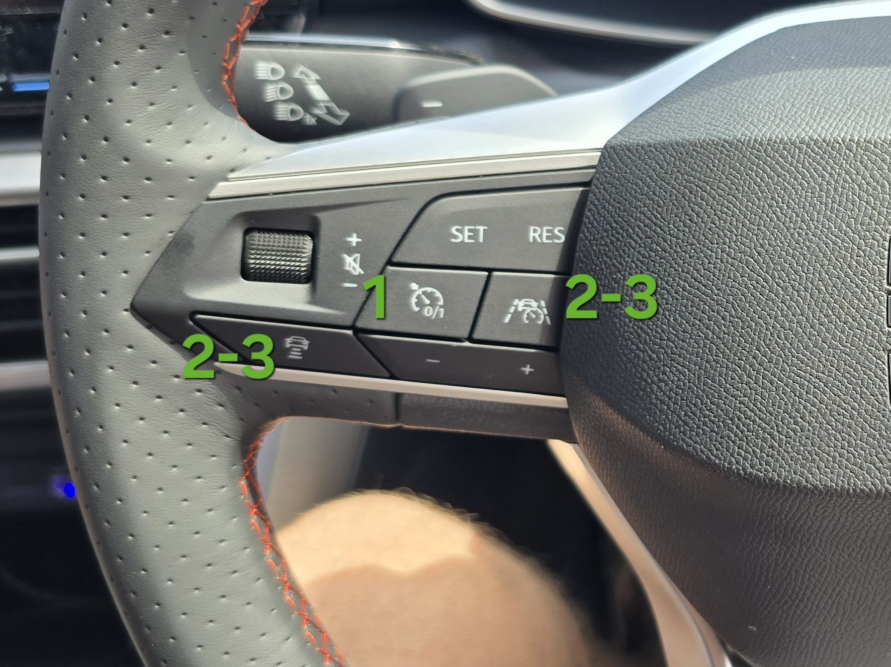

But you Turn on with the 0/1 Button?
Set Active ACC
And then travel Assist?
cairus
Jun 4, 2024
1,677
589
No, I mean the process of driving by pressing the buttons on the steering wheel
cairus
Jun 4, 2024
1,677
589

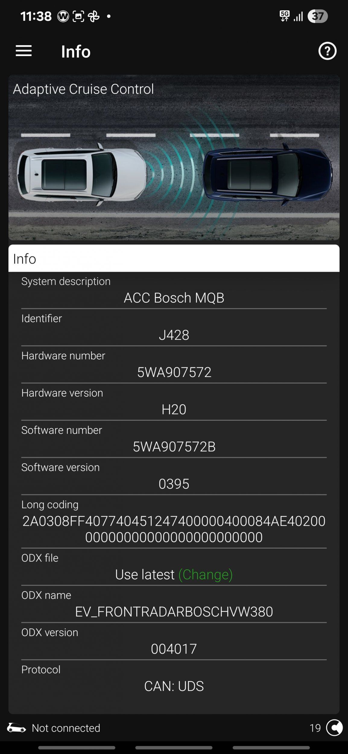

In what sequence do you press the keys? To test, set HC_Variant to 5. What are you coding with? So, which software?
Jun 23, 2025
14
Im pressing tis sequence bet I'm mixing trying all combinations.
I'm coding with obd11 ?
