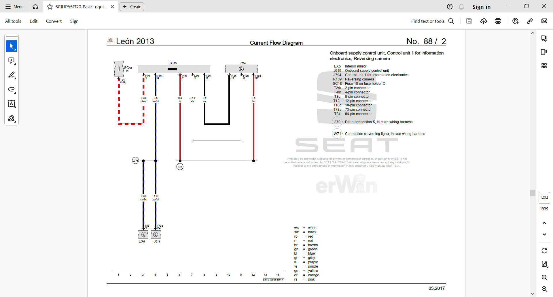

Ah perfect, Ill crack on with this and see if D can be fitted - only thing Im worried about is messing up the wiring changes - does anyone have experience figuring out what wires to splice or replace in the plug.

That kit looks like there's no splicing into existing wiring. Looks like you just unplug the main loom block plug from the MIB unit and put the cameras loom inbetween. Quite simple!

For the highline camera, there are connections to the can network at the radio connection, plus there is a connection to the steering angle sensor at the BCM which allows the lines on screen to move with the steering wheel. There is a power lead to the camera, and a video lead that runs to the radio.
Coding is needed in can gateway (to tell car that a camera module is fitted), also coding needed in the steering angle sensor module and also the infotainment module to allow display, and integration with the park pilot already in the car. Be aware that the camera will then work fine, but will throw an error code up until the camera module is properly calibrated, and being a non-genuine camera unit, calibration might not be possible with VCDS (as I found with mine)
