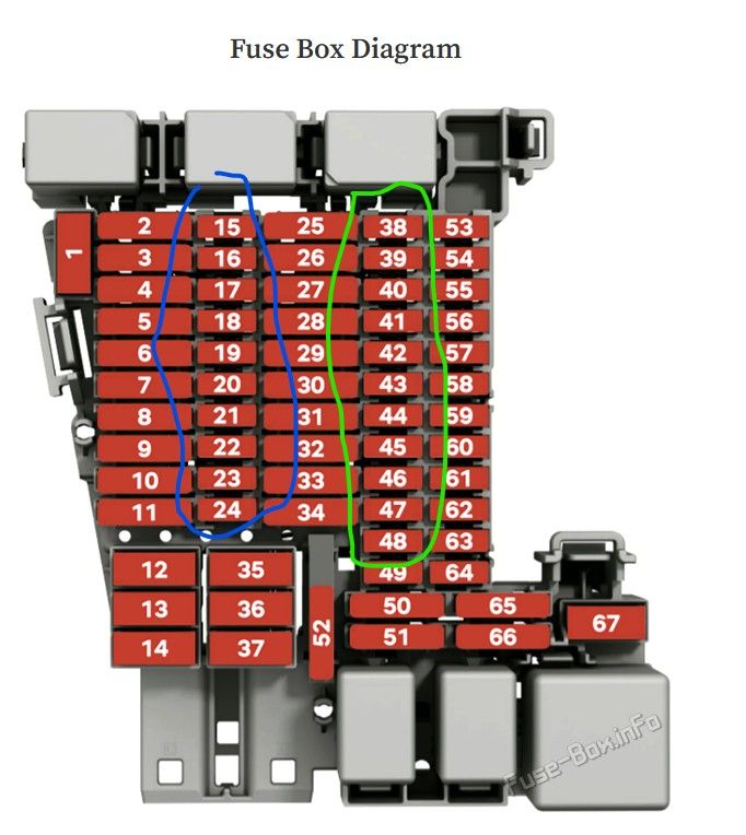

Hello,
I had everything properly connected and the system already recognises the TPMS module (see snips). But for some reason it would´t let me flash the software or the dataset with an error "no response from the ECU". Then I realize the module goes off-line. So when I start the car the module is online but after a minute or 2 it goes offline. Maybe I´m not connecting it to proper fuse? I tried the empty spaces in the 2 circles in the photo. Blue column seem to be on with the car off and green column only on when the car is on. What fuse did you connect it to?

Hello,
You've bought a counterfeit TPMS control module, the software cannot be flashed and the dataset cannot be uploaded. The software is currently S051, it will always be S051. You'll notice the info reported via diagnostics doesn't match the housing.

Are you sure? I got a whole kit like the one you posted in the manual, and that module was giving me the same error so I assumed it was faulty and I bought another one. I didn't care claiming the first one because I bought it almost a year ago and only started putinng everything together now. But I'm definetly claiming this one.
Any advice where to buy a proper one? Since Ali express already sent me 2 "faulty" ones?
It’s 100% counterfeit. Find a local VWAG distributor

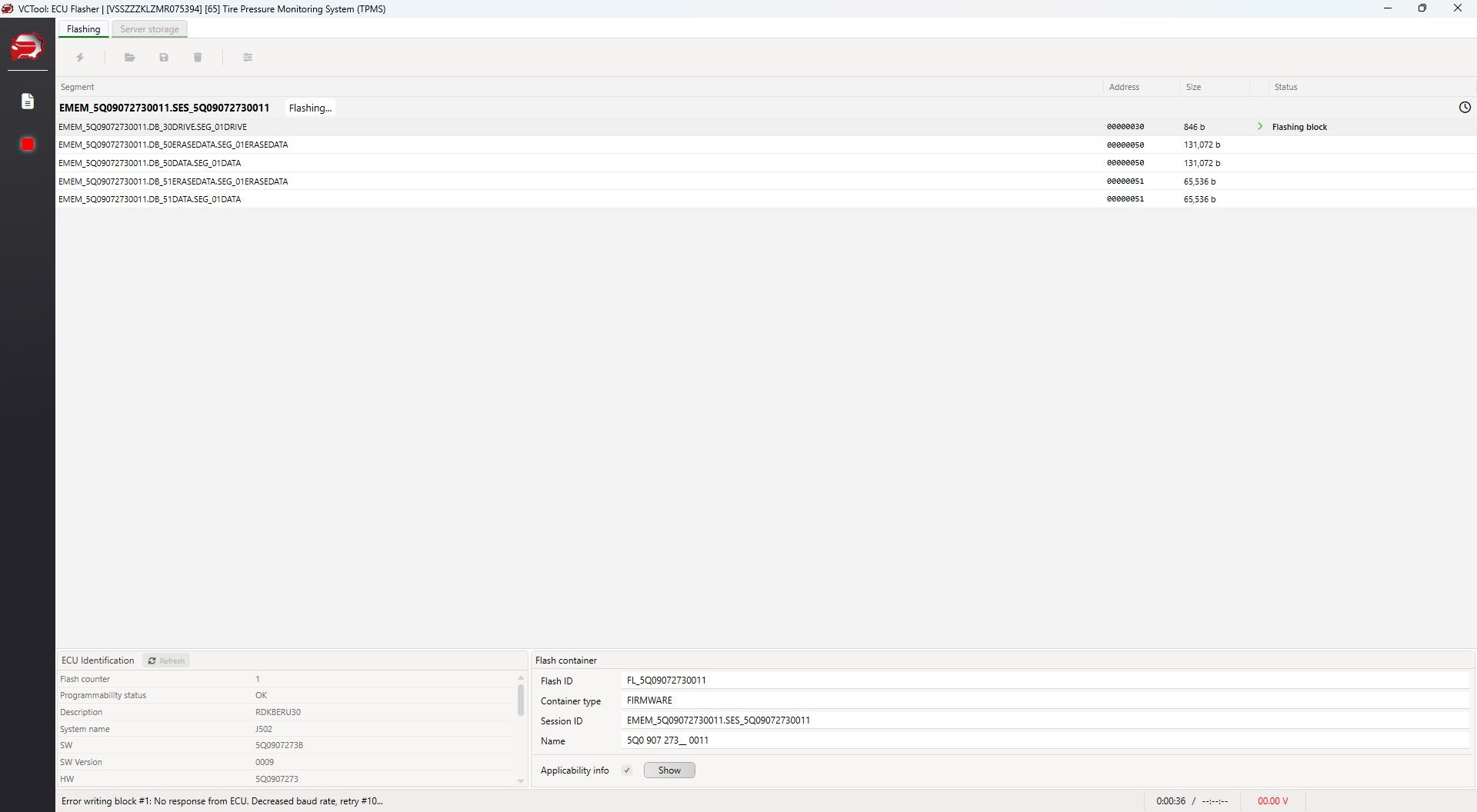

Hello everyone,
Finally got time to try this again after buying a proper module (Thanks Cairus for the link). But unfortunately now I have some other issue.
So module installed and coding done as per the manual here and everything seemed ok.
When I went to update the firmware I got the following error: "No response from the ECU. Decreased baud rate"
Got loads of errors in the car like a Christmas tree. Tried a couple of times and the same result.

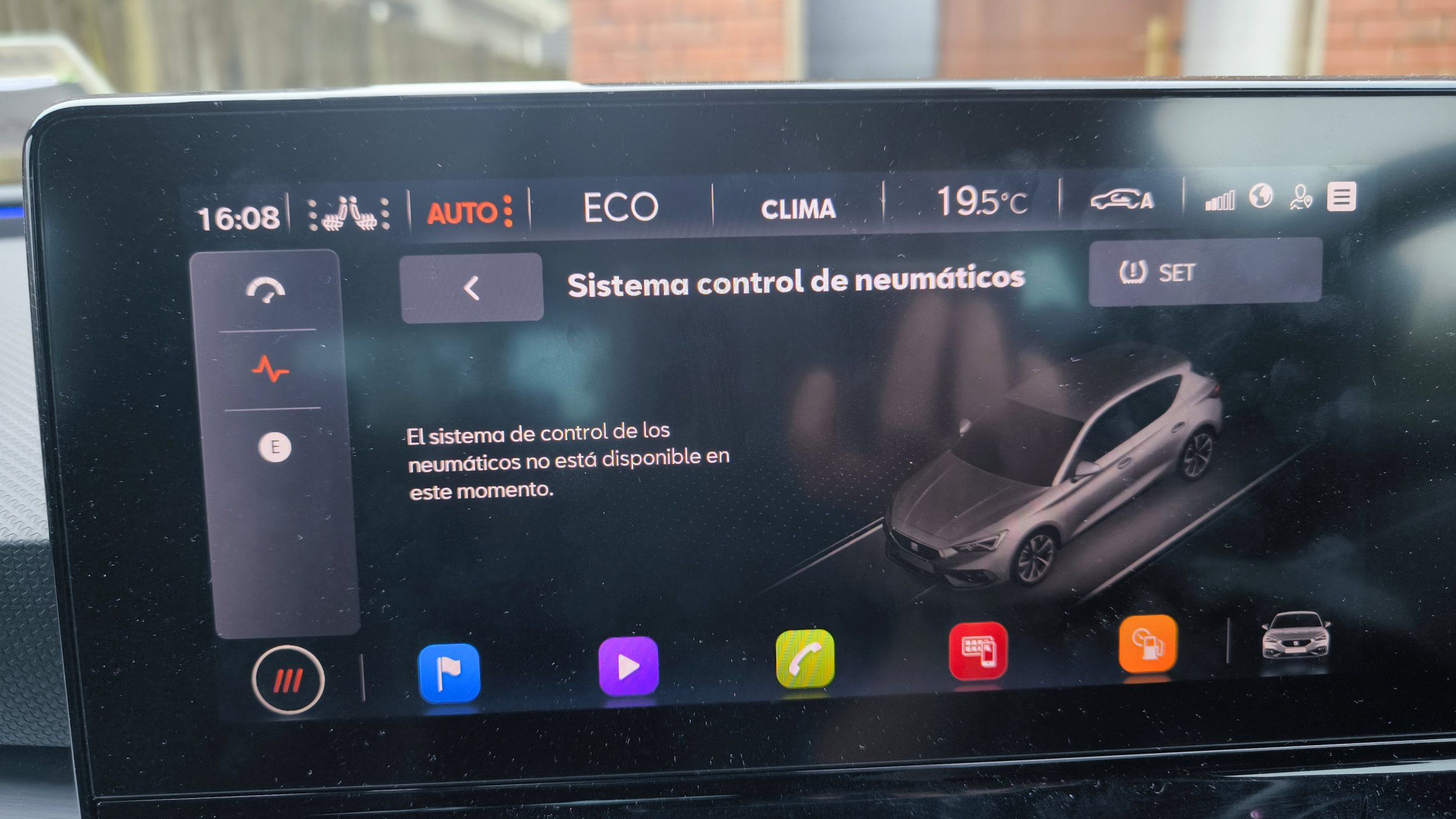

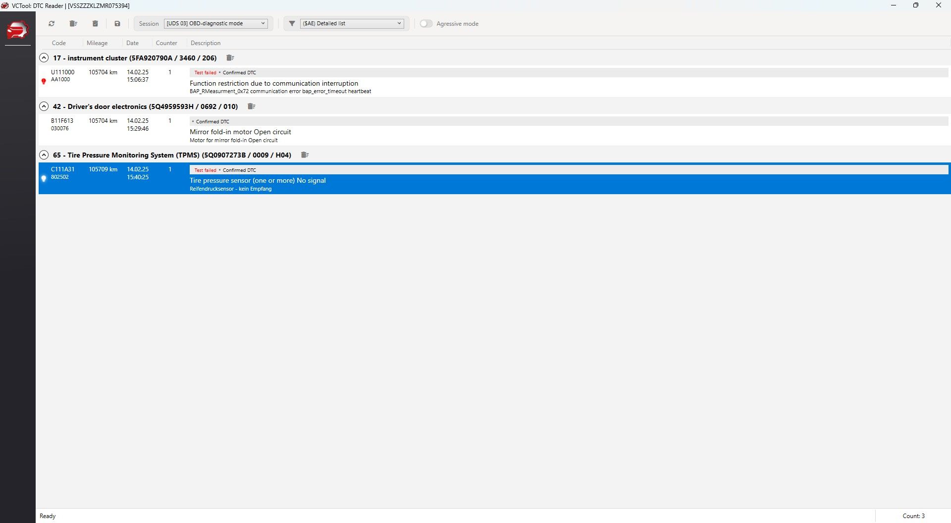

I tried to load the dataset and I was able so I thought I´m going to try to drive and see if it works. After driving around 4km it didn't show in the screen, it basically looks like I didn't change anything but it says is not available.:
and this are the errors in the car after driving:
Any Ideas what can be going wrong?

On the instructions from Antera Is one of the steps to download the latest firmware. Is not required?
