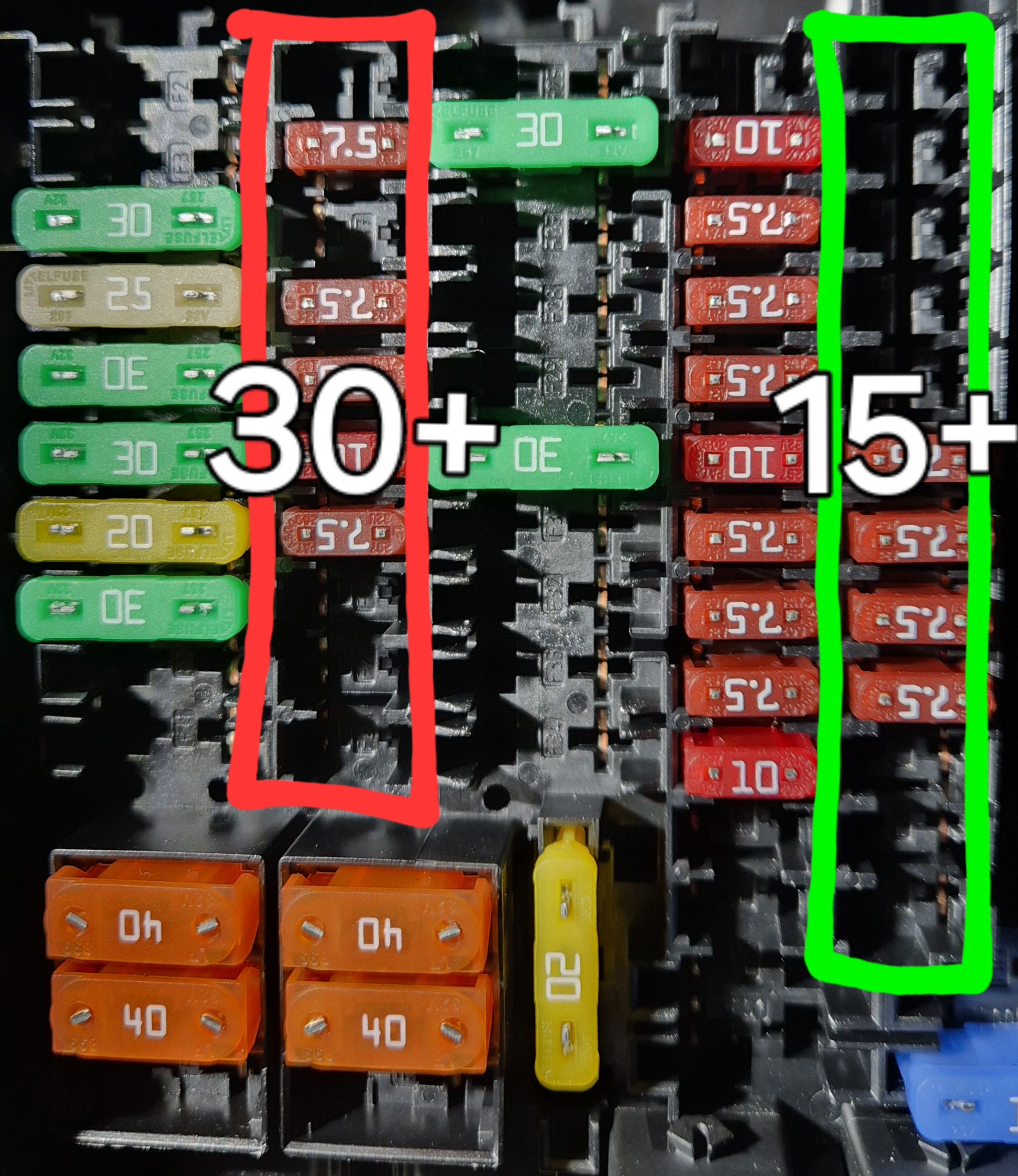

Hoping to get a quick bit of advice on hard-wiring a dashcam & which fuses to connect to for parking mode to work? Have two connecters (red & black) and an earth... sadly it's not so easy to get a Haynes manual!
The fuses labelled in red are permanently live, those in green are ignition live only.

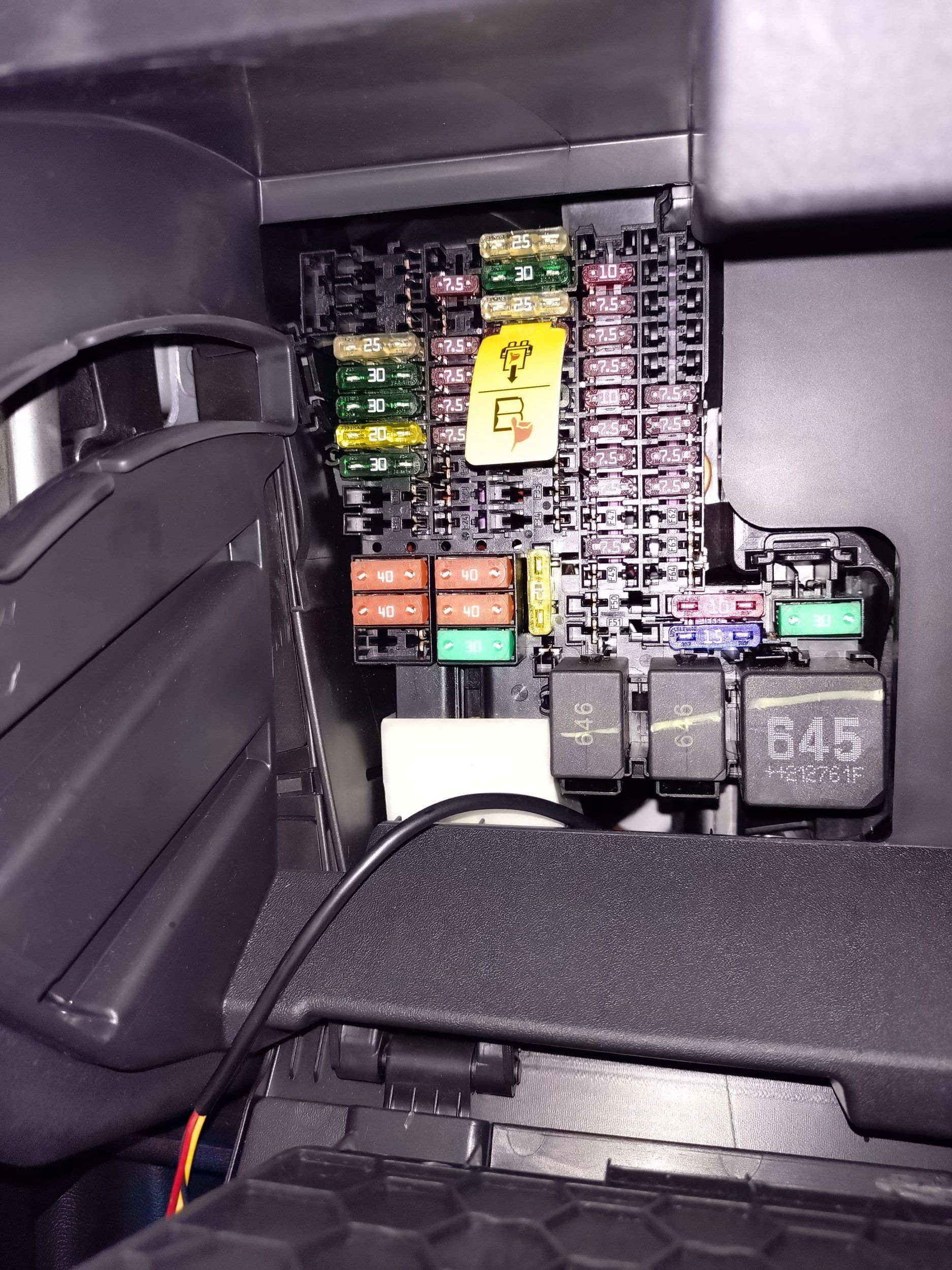

Ah, thank you. Couple further questions if I may. Do I have to use a slot that's already occupied, or better an empty? Second question... how on earth do I disconnect the car battery? I'm guessing I should do that first!
Personally I'd use an unoccupied slot that has a supply pin in it. I don't see the need to disconnect the battery if you're only wiring in a dash cam.
