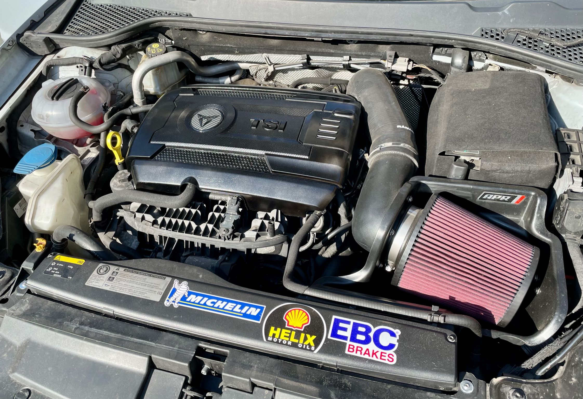

On my Cupra 280 I have stage 1 ECU tune (350bhp) APR open intake, Ramair inlet hose and turbo elbow, res delete pipe (2 res, back box and tips stock), Powerflex bushes and engine mount insert, 18 inch VW Cadiz alloys instead of 19s, painted rear bumper body colour where number plate sits, and painted engine cover.
