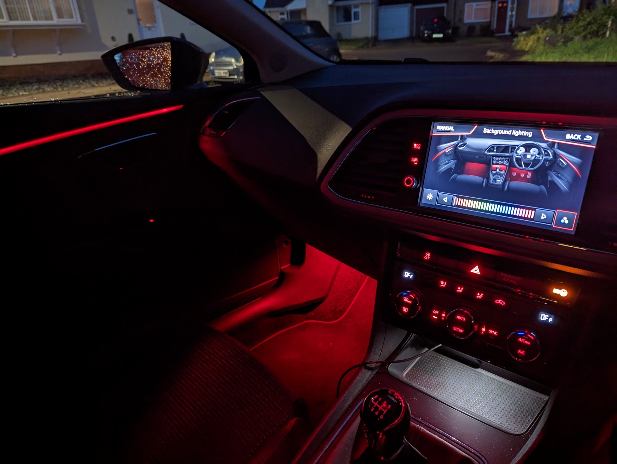

Reading up on @Chillout LIN work on another website and saw a picture of his footwell light wired up to a test rig and suddenly thought his wiring looks different to mine. Looked at my connectors and postive went to 1, LIN to 2 and negative to 4, what could be wrong? Turns out cheap connectors from Ali have the numbers on the connector in the wrong order! :ROFLMAO:
Just need to change the centre console to RGB now
But on a positive side Ive learnt a lot and managed to update software myself on the BCM, gateway and MIB. Thanks @Chillout for all your help, hard work and inspiration.

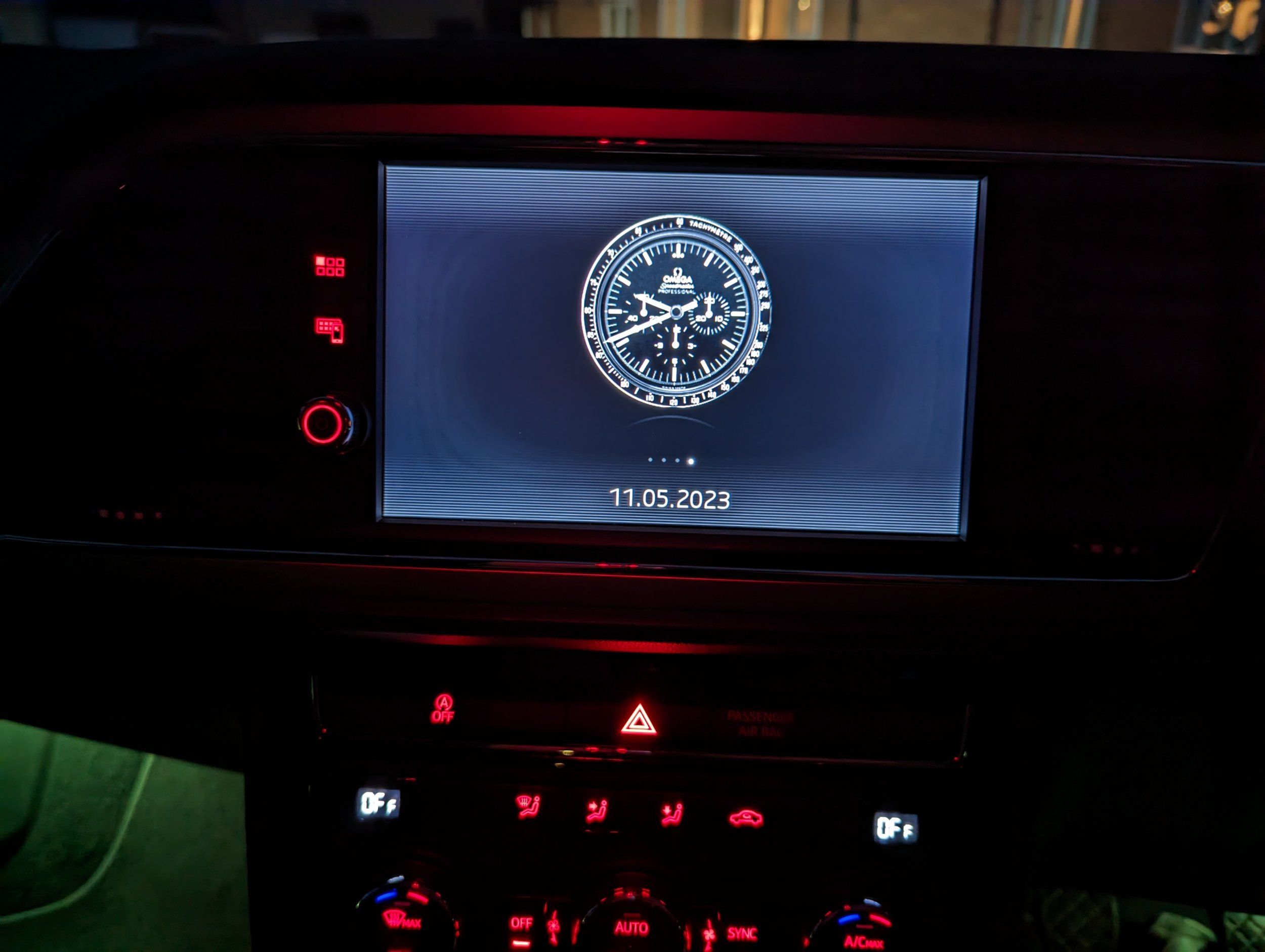

Latest creation for the clock standby screen, the classic Omega Speedmaster
