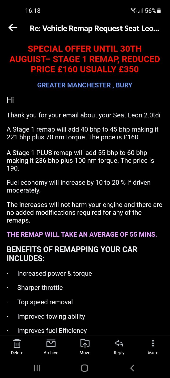

Hi everyone I have been looking at various companies weighing up my options and came across this company called rhino remaps in Bury.
The reviews seem incredible with majority all saying 5 stars. There a few 1 star reviews but these appear to be fake but just wondered what everyone's thoughts were and of course if anyone has used them.
There stage 1 plus is 190 which is 236bhp and additional 100nm of torque.
Cheers thanks

I wouldn't.
We're taking the missus' 2.0tdi for a tune next Tuesday and it'll be done correcly on a dyno, and they've said most for just software is around the 220 mark.
I really doubt they're gonna push 236 without testing it properly and if they do then be prepared for something to break.
Anything that cheap and without the use of proper testing methods doesn't sound good to me, spend a bit more and get either a Revo or Racing line map on it. Both are very reputable.

I'd personally stay away.
No one or thing is perfect and things often do go wrong. You don't know how good a company is until something does go wrong, as you get to see how they deal with it and their customer service for what could cost them money.
Going off the 1 star reviews, and how they deal with them, that would immediately put me off.
So that's the first red flag for me.
On the tuning front, do they have a Dyno? They claim to be using custom maps not generic files. So how are they making sure the maps are right? Most companies that offer true custom tuning will have it on a Dyno first. Also generic files are not all bad when they come from companies that have created these over 1,000s of miles across multiple cars, and lots of R&D, but they are generally only sold through their approved dealers (think Racingline and Revo).
So no dyno yet custom tunes? Second red flag.
BUT That is just my opinion from my own short research on the company. They could very well be an amazing company and deliver exactly what they say. The 1 star reviews may very well be FAKE NEWS, and the customer's own issues. But again, most reputable tuners will check the car over first anyway. And if there are any obvious faults, not work on the car if its detrimental to the car itself, until they're sorted.
Finally, the bit that says remaps are not harmful to the engine. Sorry but this isn't exactly correct. Engines are made with tolerances in mind, and the standard maps work to ensure the car is within these tolerances. The generics maps offered by the likes of Racingline and Revo again do something similar, which is why they will not make the peak numbers a custom tune will. But they are still eating into the tolerances. So they are putting more strain on the parts giving you less wiggle room for things to go wrong. Standard cars go wrong and fail, cars being pushed more are more likely to go wrong. You can have a standard car break within 5,000 miles, and a tuned car last 100,000 miles without an issue. you take your chances and roll the dice.

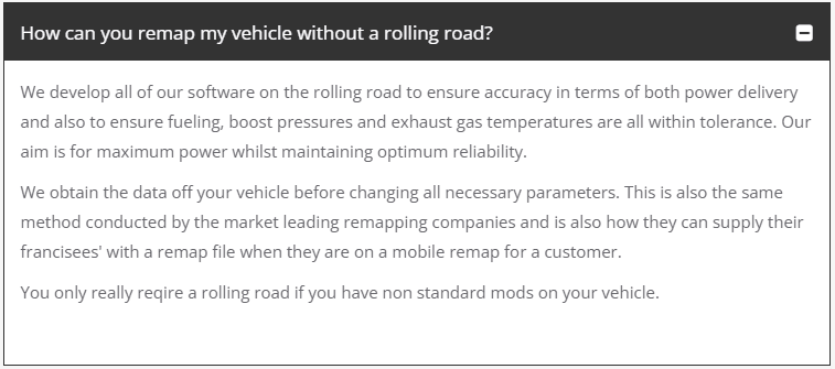

From their FAQ section:
For me this confirms they don't use a rolling road.
I have also seen communications from them about already paying for the file so you can't get a refund - so this suggests they are installing maps created by someone else.
This service will all depend on the quality and suitability of the map they are purchasing from 'somewhere' & 'who' we don't know?
Either I wouldn't believe the 236bhp figure - or if it actually makes 236 it will be seeing seriously high exhaust gas temps which will not be reliable/safe.
Interesting videos on tuning the stock 184tdi from darkside on youtube.
So they must spend a lot of time on R&D putting every possible variant of car ever sold on the market on a Dyno to create maps for every customer's car.

Why on earth would you think that 1* reviews are fake? If anything, they're the ones you'd pay attention to, particularly at this price.
I suppose it can happen mate in this day and age one thing I have noticed is his replies do seem rather aggressive lol

Their claims about improved MPG are complete nonsense. Manufactures spend tens of millions to maximise every last 0.1 of a MPG, no way a remap would increase MPG.
