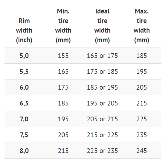

I'm looking for some alloys and the current tyres i have are almost brand new so i wish to just purchase alloys and do a straight swap.
I've found some alloys on Ebay but the rim width is 7" where as my tyres are 225 (7.5J) which is what i was originally looking for but these are really nice.
According to this pic below, 225 is the maximum limit and ideal is 205/215. I was just wondering if there are any pro's and con's to fitting these.
Any advice is more than welcome, and appreciated.

The only con might be slightly mushier turn in from the sidewalls being squeezed onto the narrower rim. Higher pressures may help. Or you might not notice any difference.
But it seems they will fit and aren't illegal.

One thing that I had not considered in the past is the effect that rim width makes to the rim protection afforded by a tyre that already has built in rim protection. My daughter bought a set of alloy rims for winter tyres, I suggested 7.5J for the 225 section tyres - she bought 8.0J fitted with 225 section tyres, these are the first wheels/tyres I've ever handled that when you stack them, the rims touch instead of the rounded walls of the tyres touching.
From the rim width versus acceptable tyre widths tables, 8.0J is okay for 225, as is 7.5J, but from what I've seen, when considering rim protection, the 7.5J rim is th e better choice.
Edit:- in answer to your question, I'd only go for 7.5J for 225 tyres as a very good balance between having an upright side wall and one that is bulging too much.

Thinking about it some more i'll probably stick to looking at 7.5J then, better to have that bit of protection eh!
