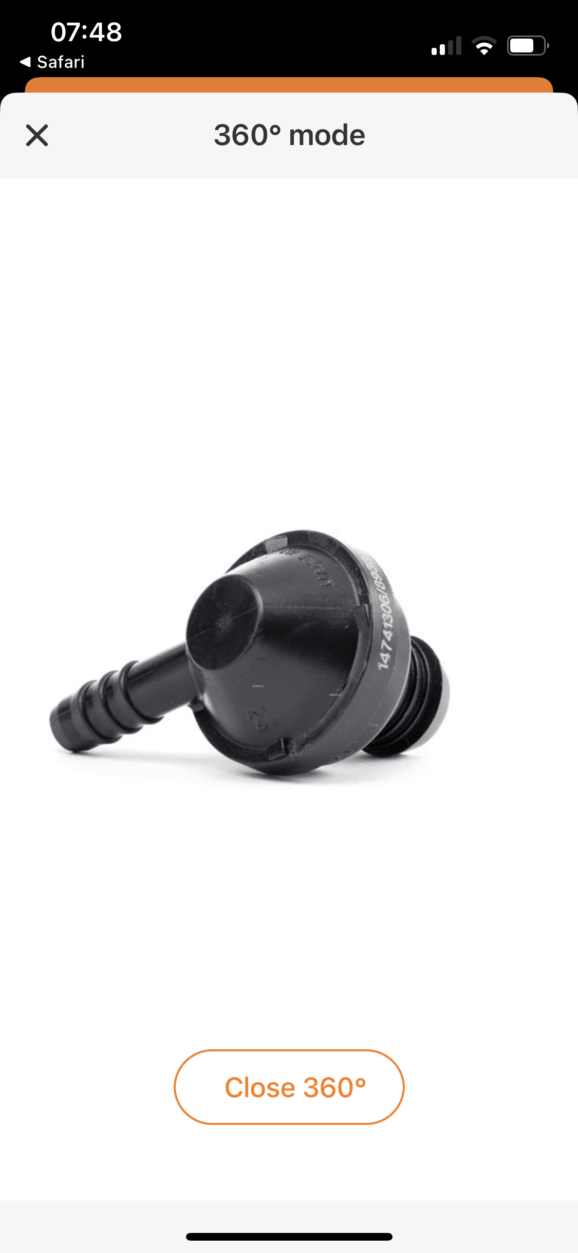

Yeah, I think it’s under the inlet manifold behind the dip stick holder? Looks like this:
Any oil leaks from around there, or the PCV hose?

Yeah, I think it’s under the inlet manifold behind the dip stick holder? Looks like this: View attachment 42702
Ah that’s not the one i was thinking. I’m not sure about that one i will check today. Is there anything else to check if it’s not that?

To be honest, I’m not sure. I only suggested PCV valve as I’m having similar symptoms n issues with my Leon 5f, and I suspect it’s my PVC valve. My PVC hose is covered in oil… And an oil leak from the transmission cover seal, and rough idle every now n then, n very occasional stalling.
Just had a look and there is a massive split in one of the pcv hoses.

Ooh. The plot thickens… Can you take the PCV valve off n shake it? Does it make a rattling noise?
I will do that soon, i’m gonna go get a catch can kit from one of my local vag tuning places and just bin the PCV system. I will however do it for science purposes :)
