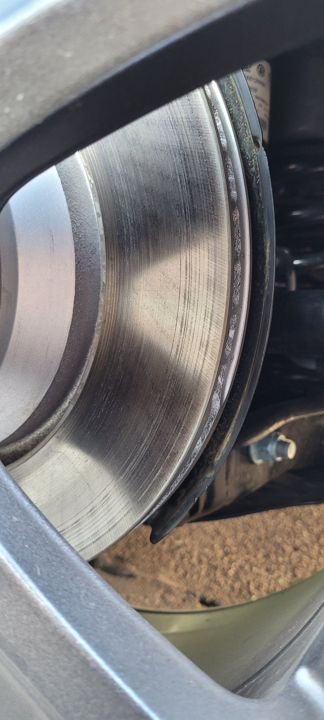

Rusty rear brake discs

This problem is normal on eHybrid and especially with 310 mm discs.
The rear breaks are not used enough and it is not possible to use them more without days downhill driving in neutral.
I believe that the uneven wear is caused by 2 springs mounted between the pads on both sides. The springs are mounted to make sure that the pads not get stocked to disc.
I have found the springs to be so hard that the brake pads only get pressed against discs closest to center. I removed springs but my discs was already to damaged for it to help.

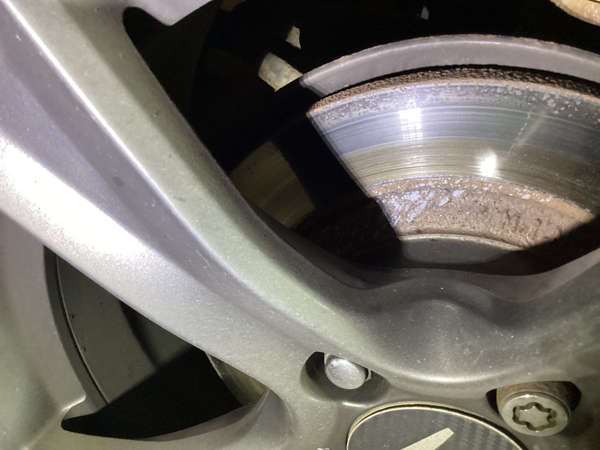

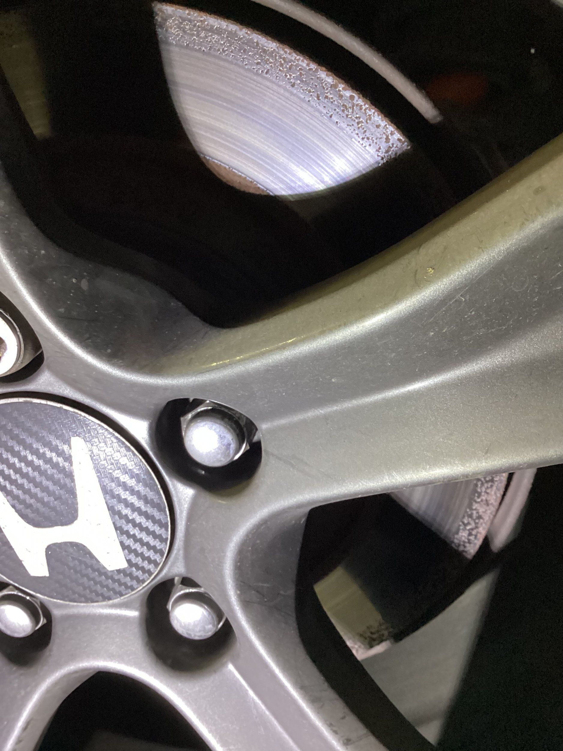

These are the rear discs on my Honda, the pads were not seated correctly in the caliper/sliders and so not applying evenly on the disc,as I suggested above I had to remove the pads and turn the pistons so the locating pins where in the right position to hold the pads parallel to the discs, this is now becoming normal wear pattern.
30 years working as an engineer in the mining industry and the 20 in the motor trade I know a little about brakes, some set ups more than 4metres in diameter, or ignore me, no skin off my nose.

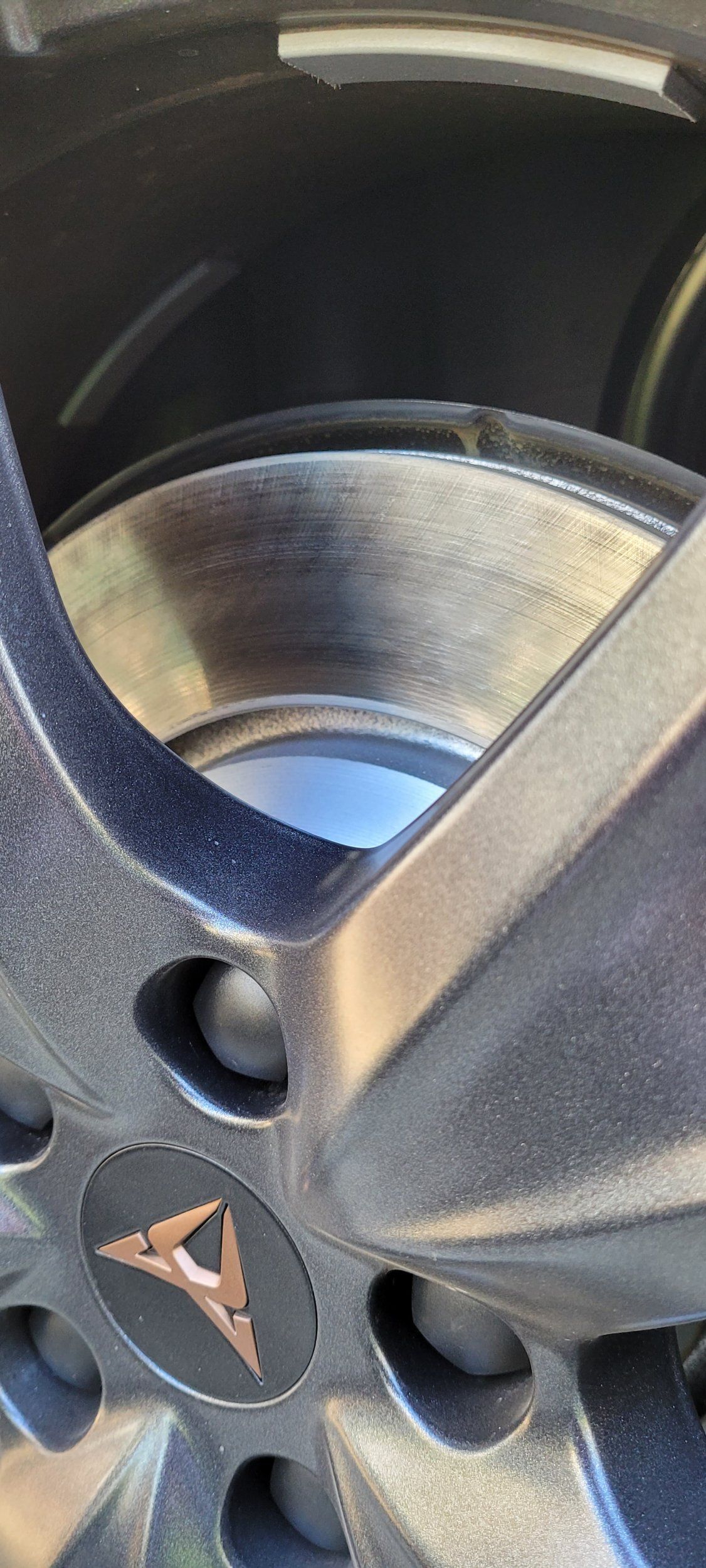

Just a quick update for anyone following this thread.
Got the car back from Cupra this morning, they've replaced the rear brake pads. Apparently Cupra have changed the composition of the pads this year and this will solve the issue.
One other thing worth noting is that the front pads were greased from the factory but the rear pads were bone dry (the contact surfaces where the pads sit in the calipers). When they've
replaced the pads they have greased them.
I've just driven home around an hour and the discs are looking almost new again!
Seems to have worked a treat.

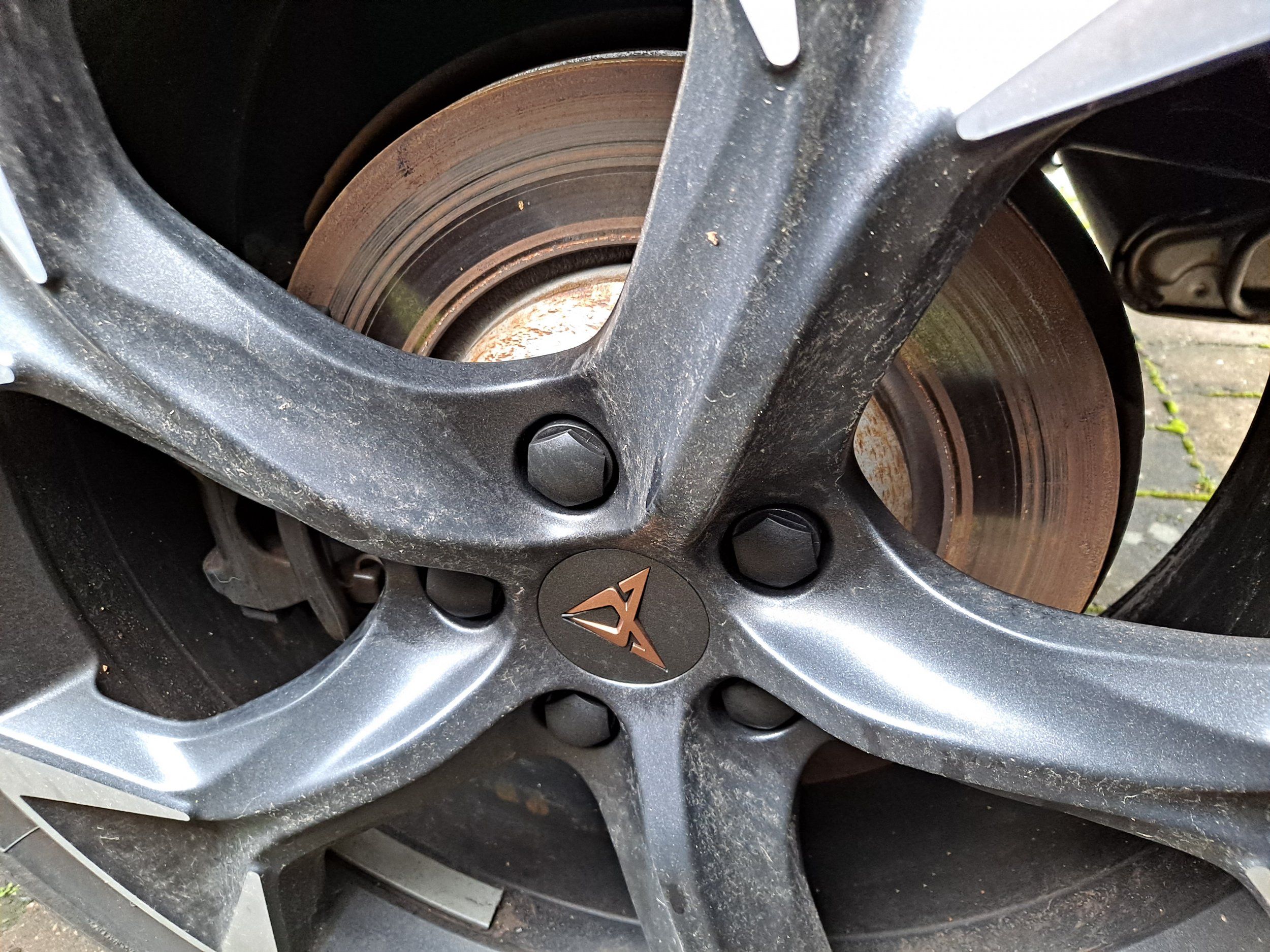

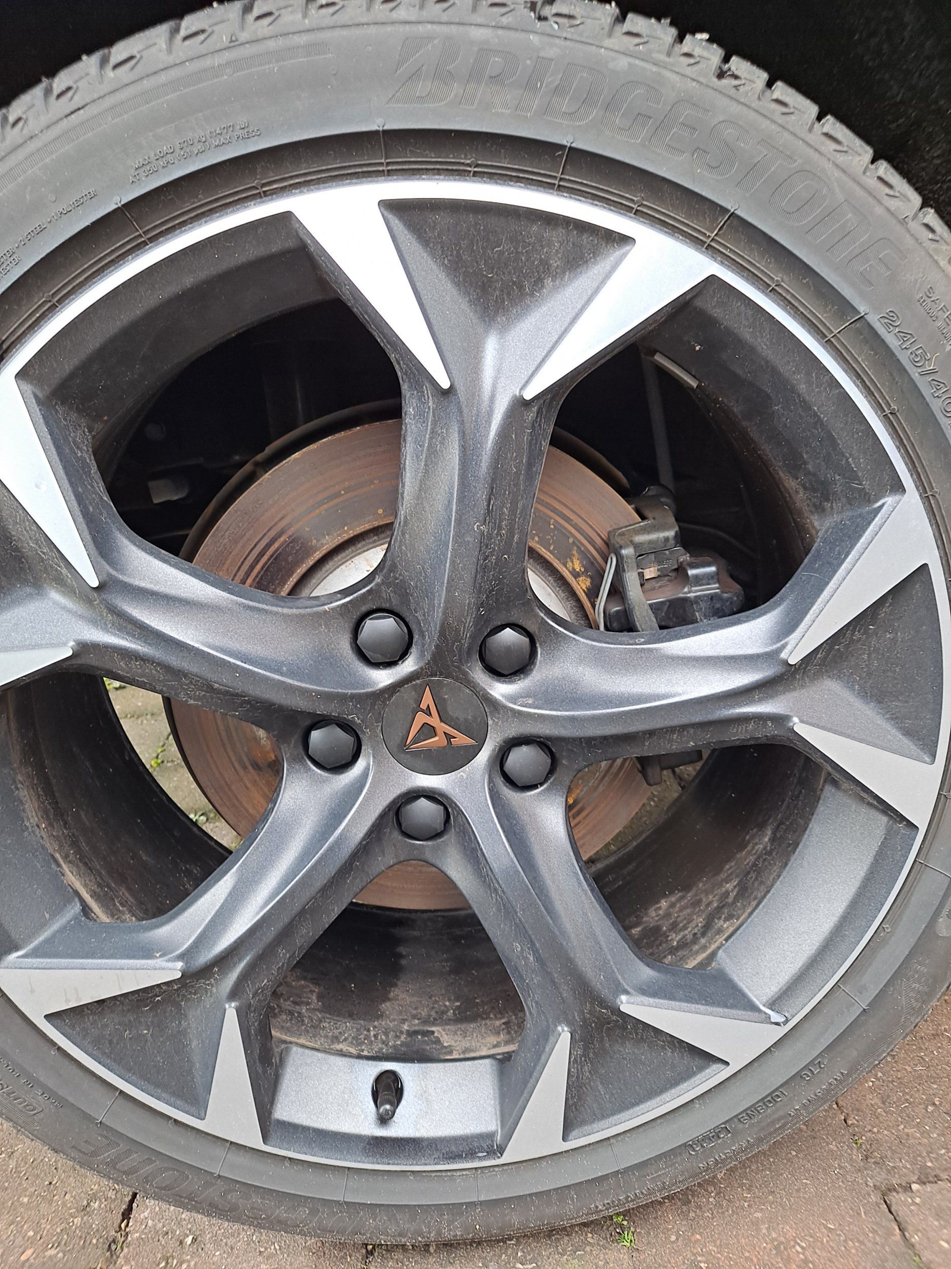

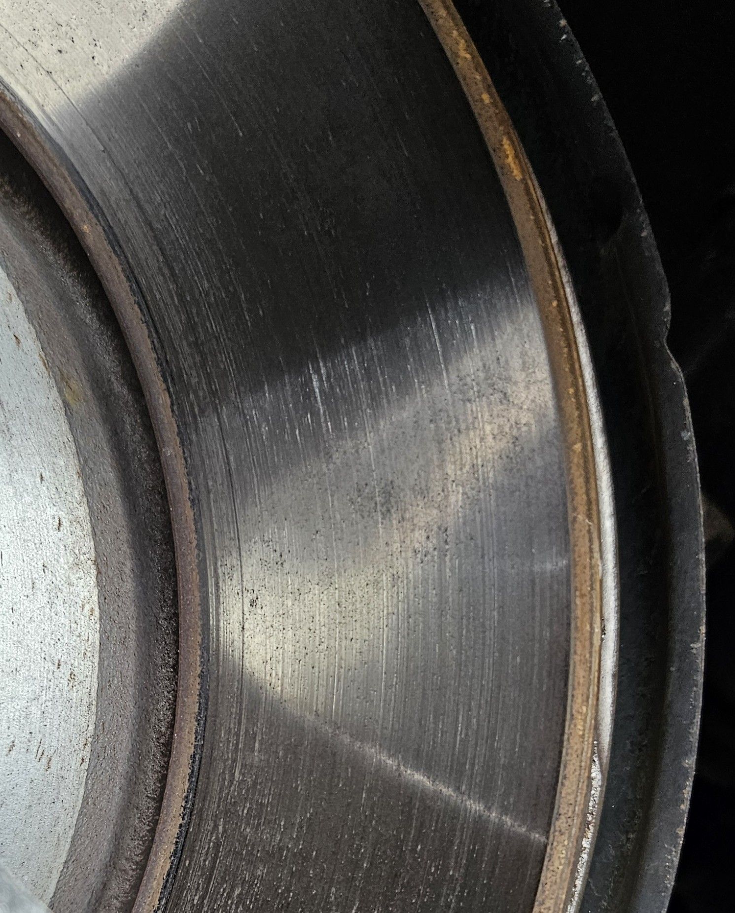

Mar 24, 2024
Hi
I have a 23 Formentor VZ2, just under 6k on the clock and not only do I have only 25% cleaning effect of the pads, but the rotors are now badly scored!
The dealer tried to tell me that is because (1) they use chamfered pads, and (2) it's a PHEV.
Does anyone know what the expected life of the rear rotors is? If I have to look at replacing them every 10k, then the car and I will soon part company!
the wheels are dirty as the photos were taken after a longish run.

These is how my rear discs both look at just over 5k miles now and 8 months on from being sorted. They are as I would expect them to be 🙂
Completely agree that they way the back brakes on these cars rust up is very poor.
