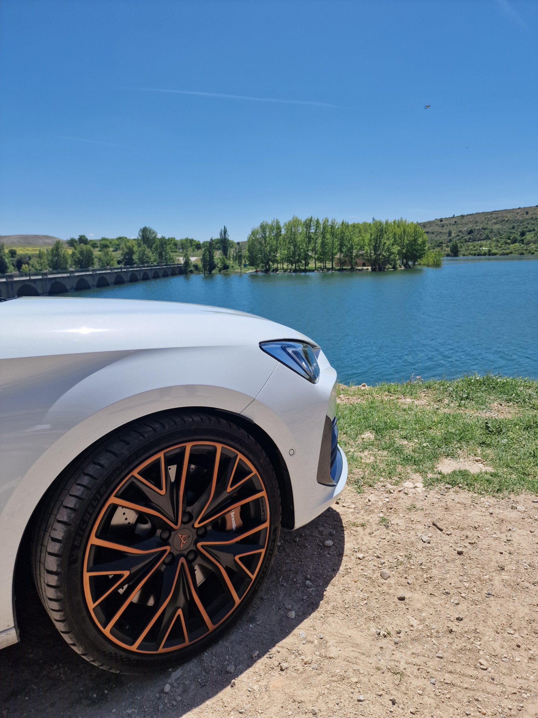

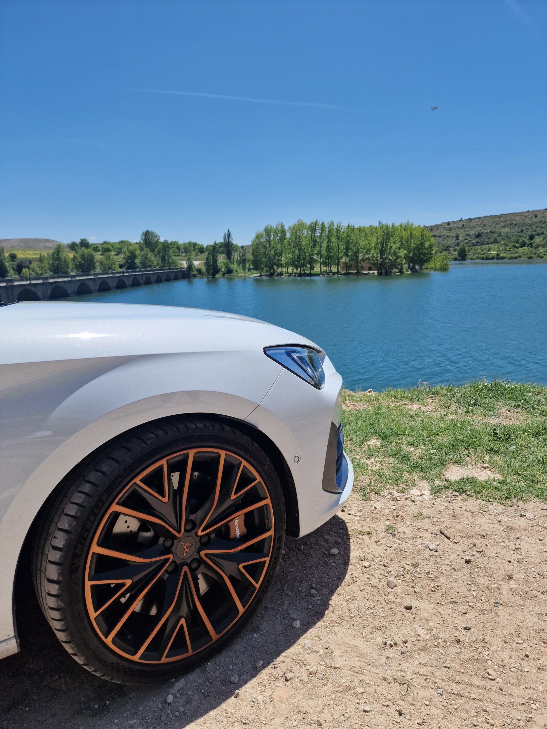

Hello,
I changed the stock brakes to Brembo braking from the 370mm Performance kit. It was replacing calipers, pads and discs. After that the brakes were bled and working perfectly.

I changed the wheels for the ones that another Leon had on me, I liked them better on the Cupra than on the 1P.
My engine code is DNNA, it is on the technical sheet, at least in Spain.
I buy the parts second-hand or from the dealership itself.
