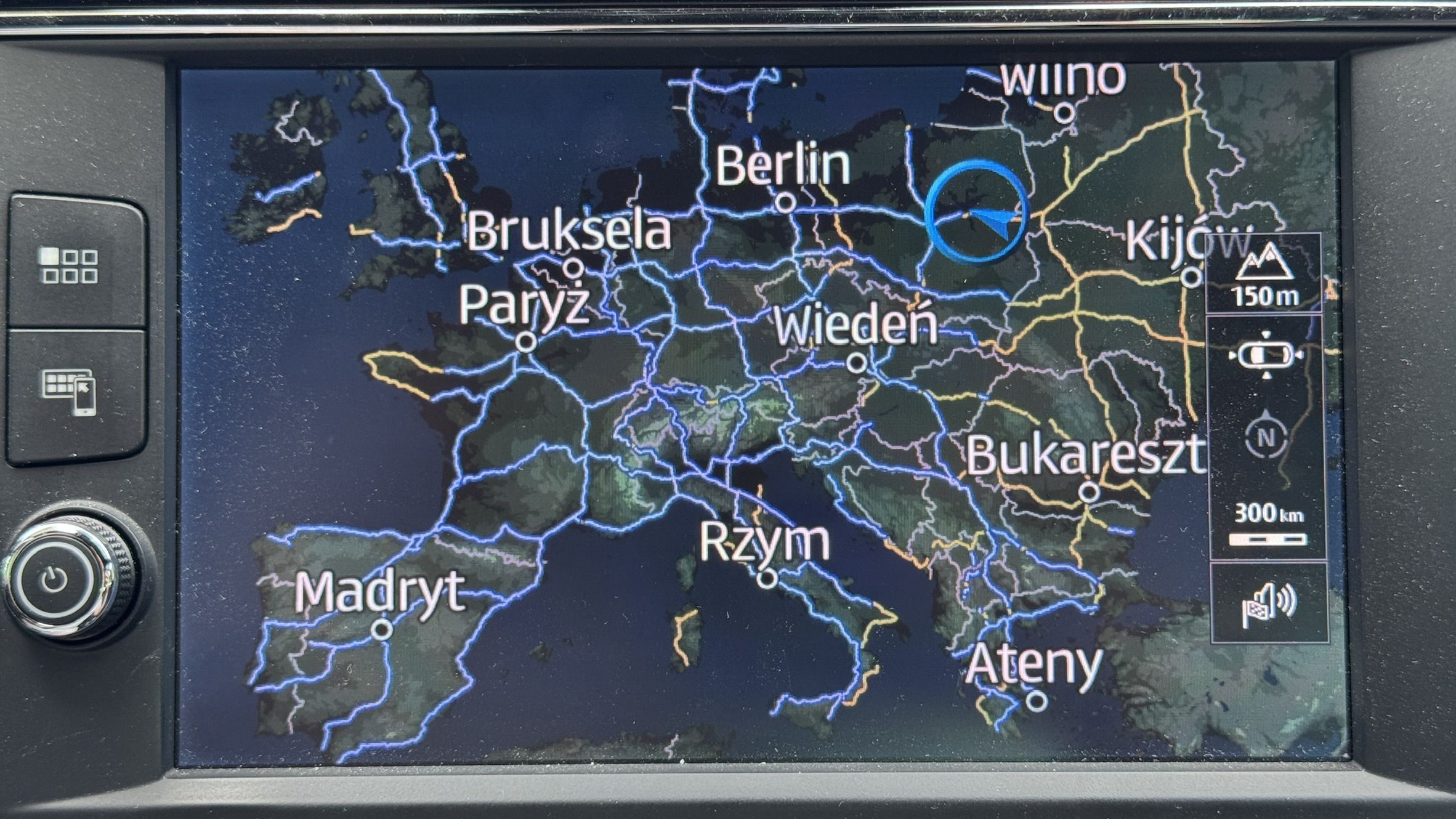

I'm glad you have all been reading the resource:
If you work through that it takes you to the mib2 standard and the latest map release which may be the last. I feel it in my bones it could be since it came out very early to June. Normal discovery methods were used by the community. Anyhow almost as if the people just got them out.
Mib2 standard take a back up copy of the SD card. Never reformat it since some format programs alter the cluster size and hack the SD. You just do a delete and wait for it to happen. Don't treat it like a floppy disk and hit format all. That is when you'll need that new SD card if it wrecks it and there are incidents.
You can buy a 32 gb Vag card, do the work around and have all of Europe rather than the zones.
The resource has all the hints and wrinkles in it and a link to the overall.nds files that works for all if you accidentally delete the one the car unit is setup to work with. Thank every body who contributed over the years on this one and Exciter / Stefan who is the master of the workaround.

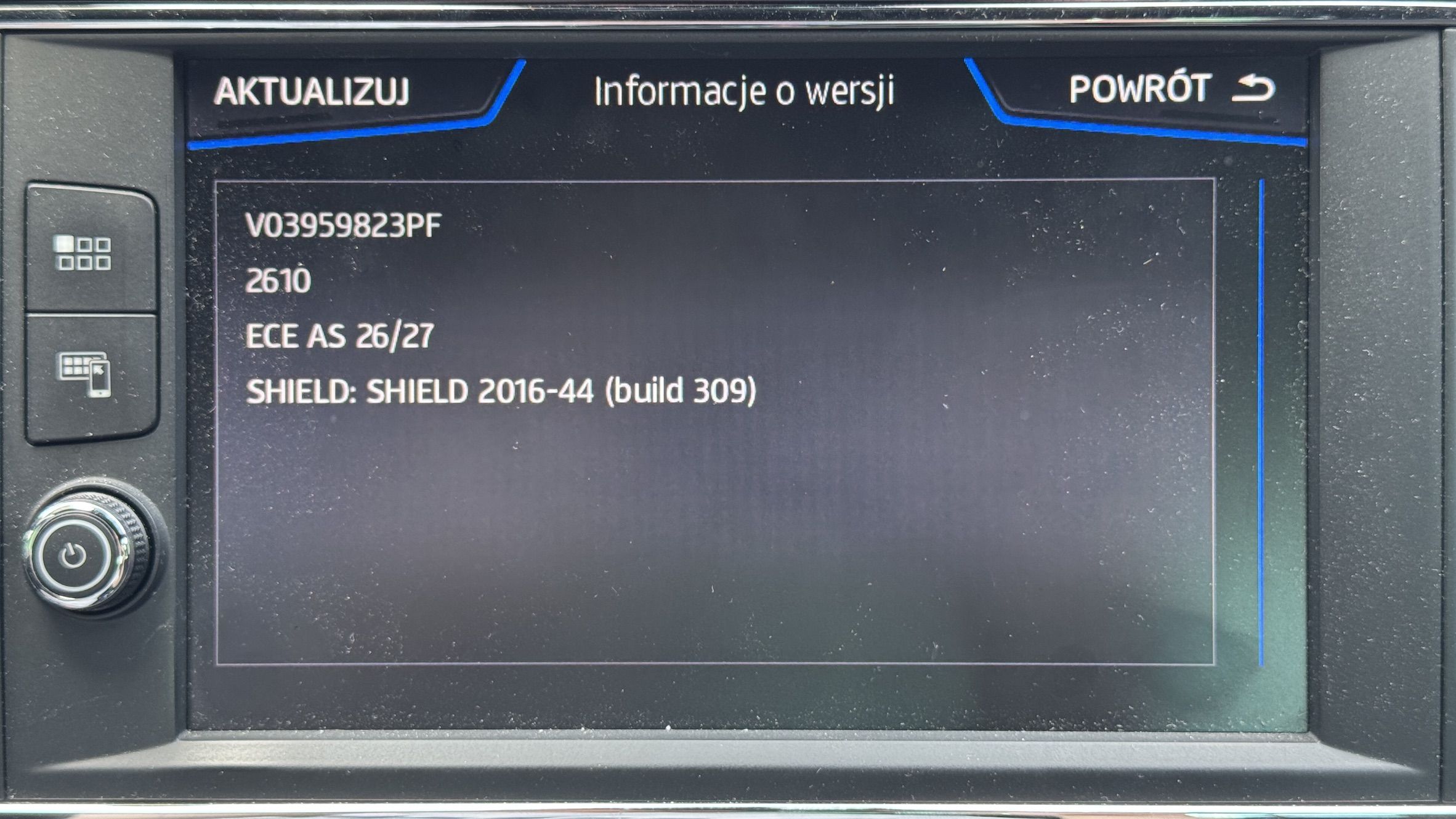

Indeed 2610 is what would have been the June 2026 release, released in February. Just did an audit to see whether we are all on the same page on the latest release. It is.
Problem with mib helper it wont tell you about the overall.nds that's only for Seat. If you got a mib2 high it wont tell you for this June release you need navigation FeC surgery. Mib2 standard the workaround as per the overall.nds trick looks after that side.
So yes, I'm not sure whether 2610 will be the final release or not. We dont have to say that too loud.
