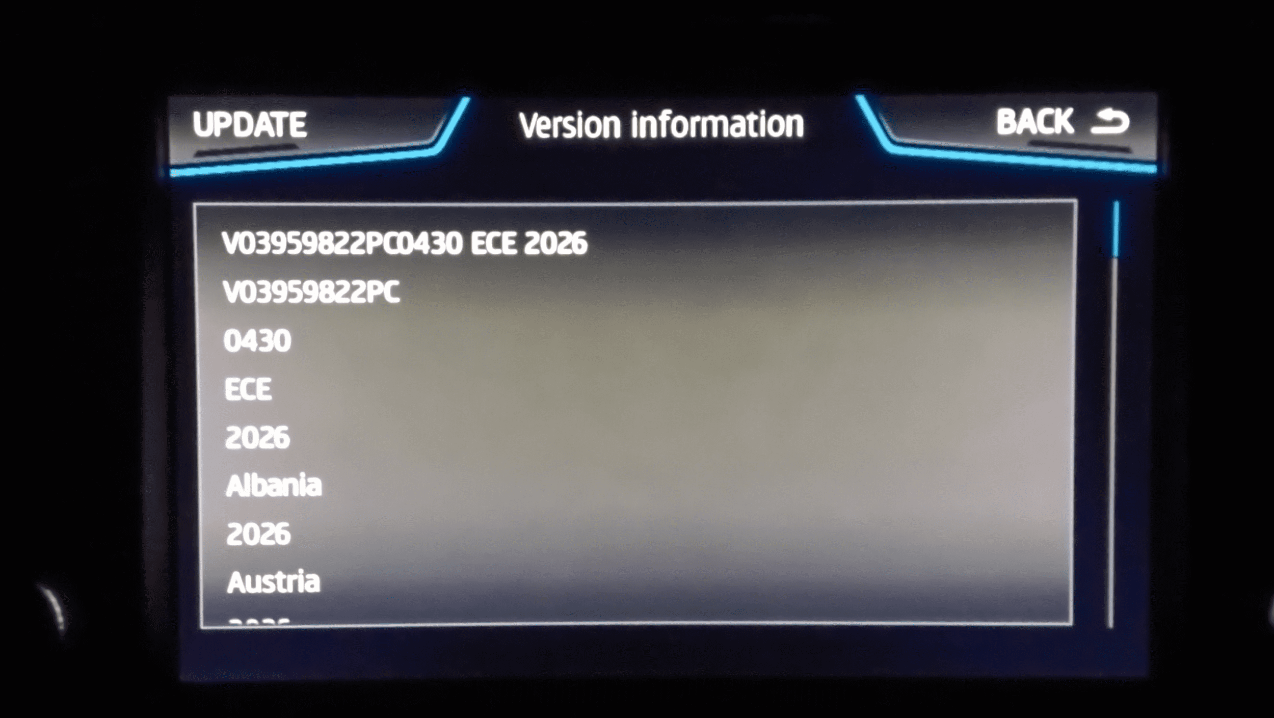

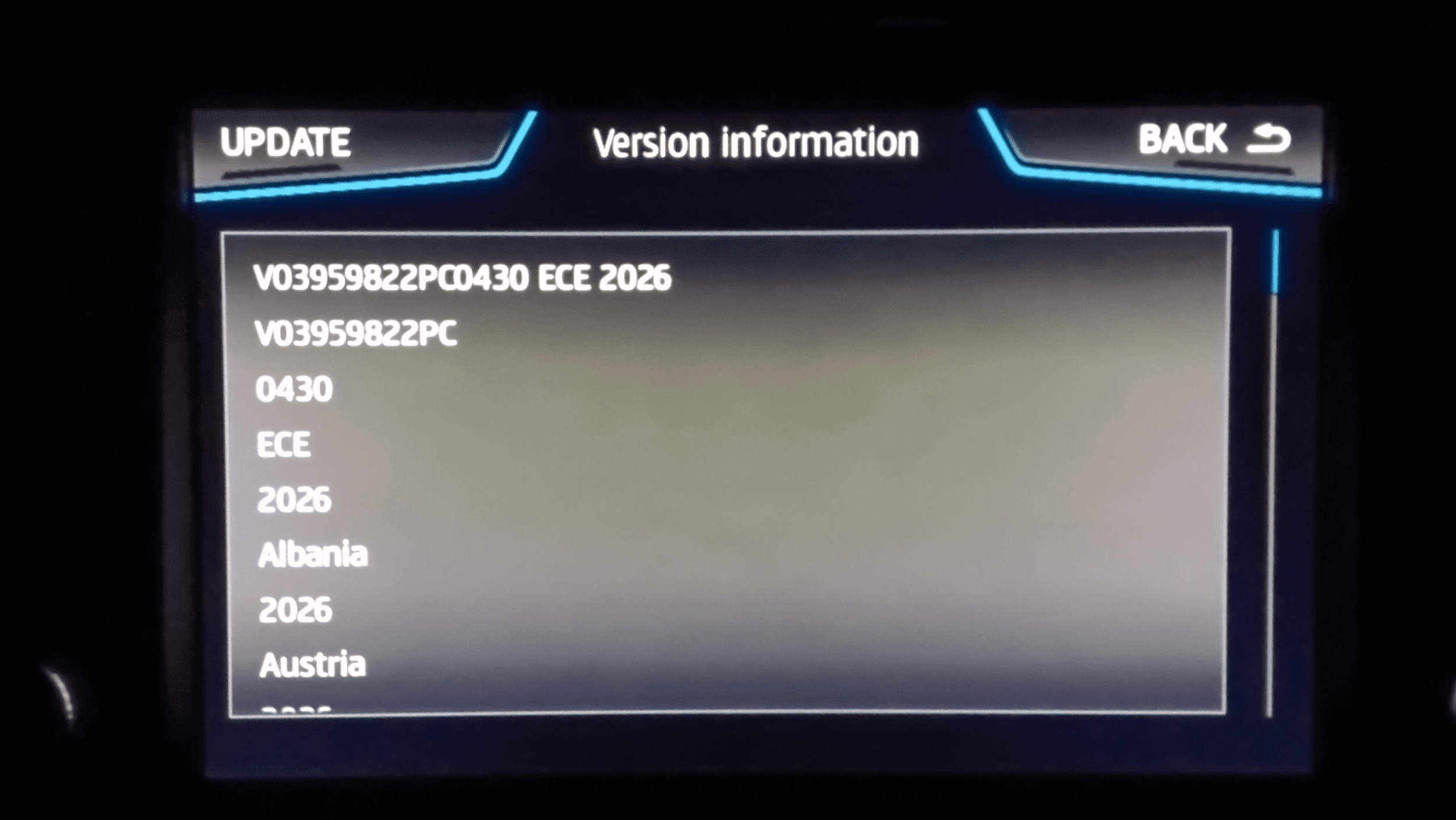

To load these up on a Seat you need the lifelong navigation FeCs else it won't work. Details in the resource.
You just need to get them unzipped and in the root directory on an SD card (or USB) as normal. Use 7zip it's faster. Metafile in the root, mib1 and mib2 are subdirectories of the root. You do need both. Note the normal Mac instructions for those using a Mac of CleanMyDrive. See resource tabbed under Overview above. TMC Inrix works as per normal with the code change. Latest maps ✔.
Normal success screen:
