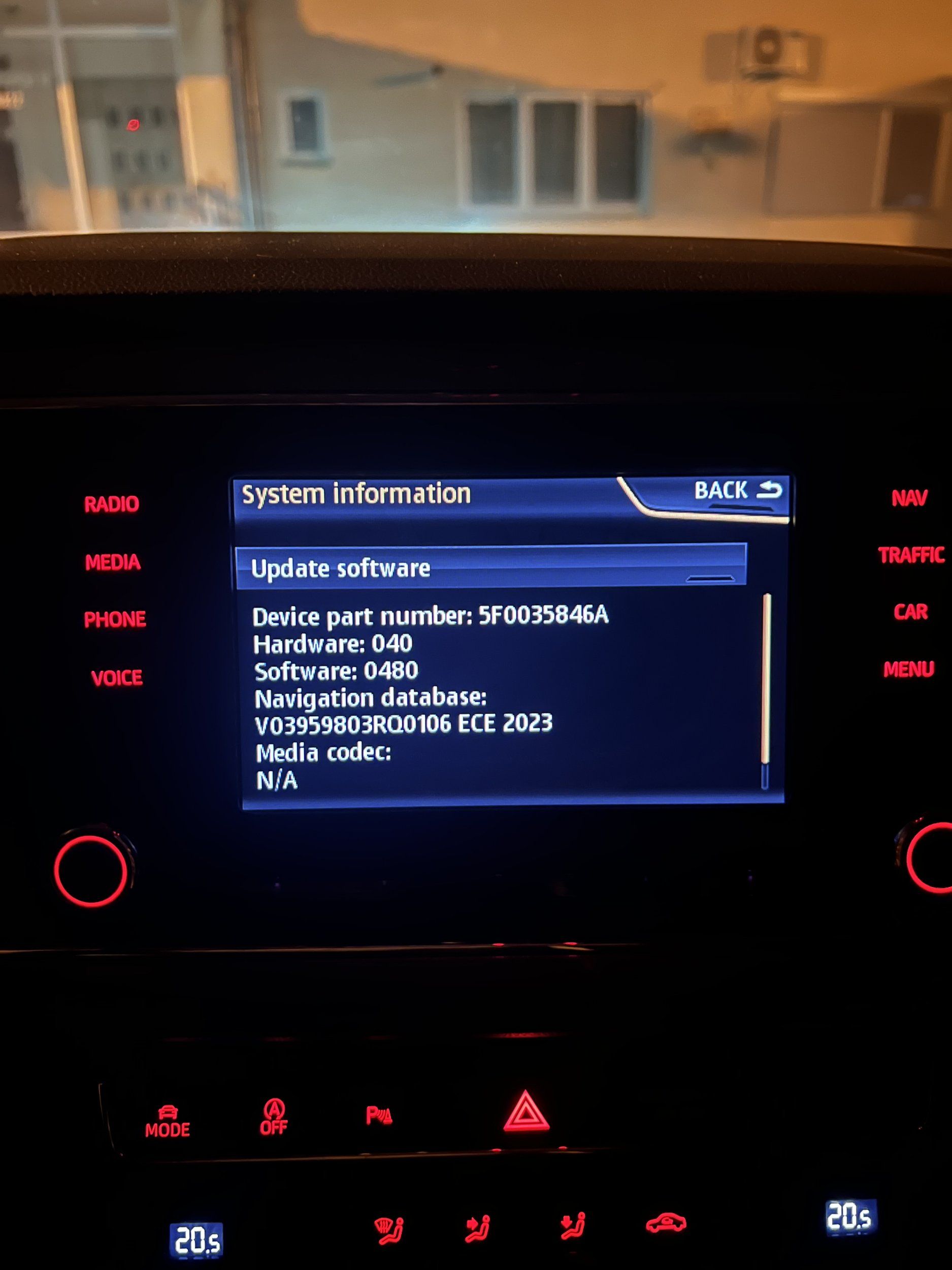

im on right track but with mega limits
Yes you have to wait out the holds with the mega limits if you dont subscribe. It gets there in the end.
Look at me now ? need other parts to invest in. Its posibole to upgrade to mib2std with this display?
Well you have mib1 2023 maps now. A lot of people did invest in mib2 who had mib1 at the time. Circa 2015 and on you will find threads on here. The board sponsor sells mib2 standard kit upgrades. @East Yorkshire Retrofits but pass of whether the screen needs changing. The interest was Android Auto and Car Play in some quarters. There are little AliExpress boxes that give AA into an existing mib1. Some people do that route.
Mib2 maps may be coming to the end of their cycle of updates although as seen a mib1 map update was released 3 years after it had got to the end of it's cycle. Mib2 high is throught to go on beyond since Audi was fitting them into TTs well after 2020. That's been said by mib2 high Audi TT owners.
Depends what you want to do. This is a map update thread. Well done for getting the mib1 map update into you unit and firmware. I did say every body had achieved it so far using @Daz3d lead.
For one thing on your Skoda which I think you have you need the equivalent to the Seat 480 firmware. The Skoda guy had that so got it all working. The map file it self was on mibsolution.one but is knocking about on this thread. I think so anyhow. I set you the task to find it.

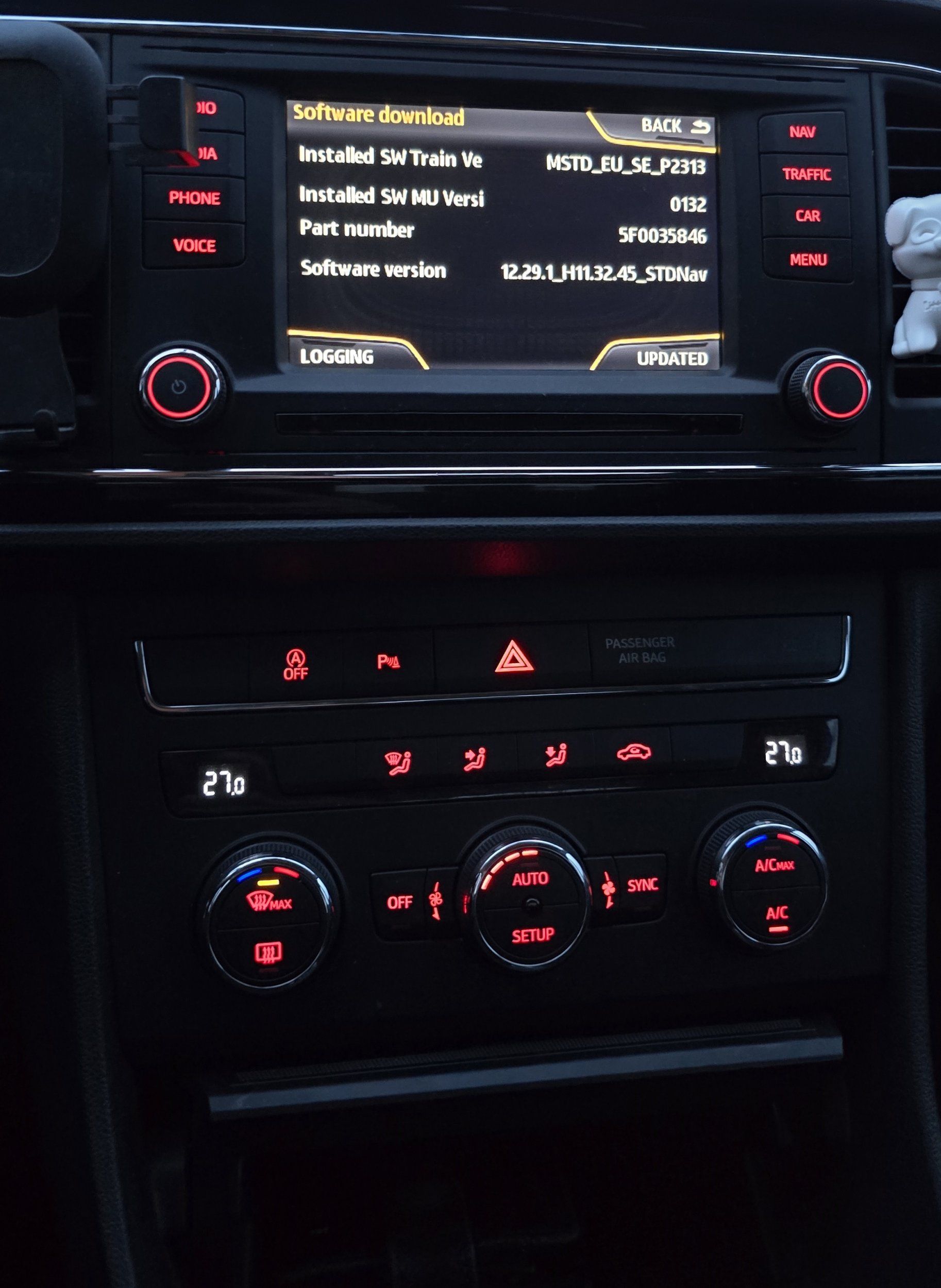

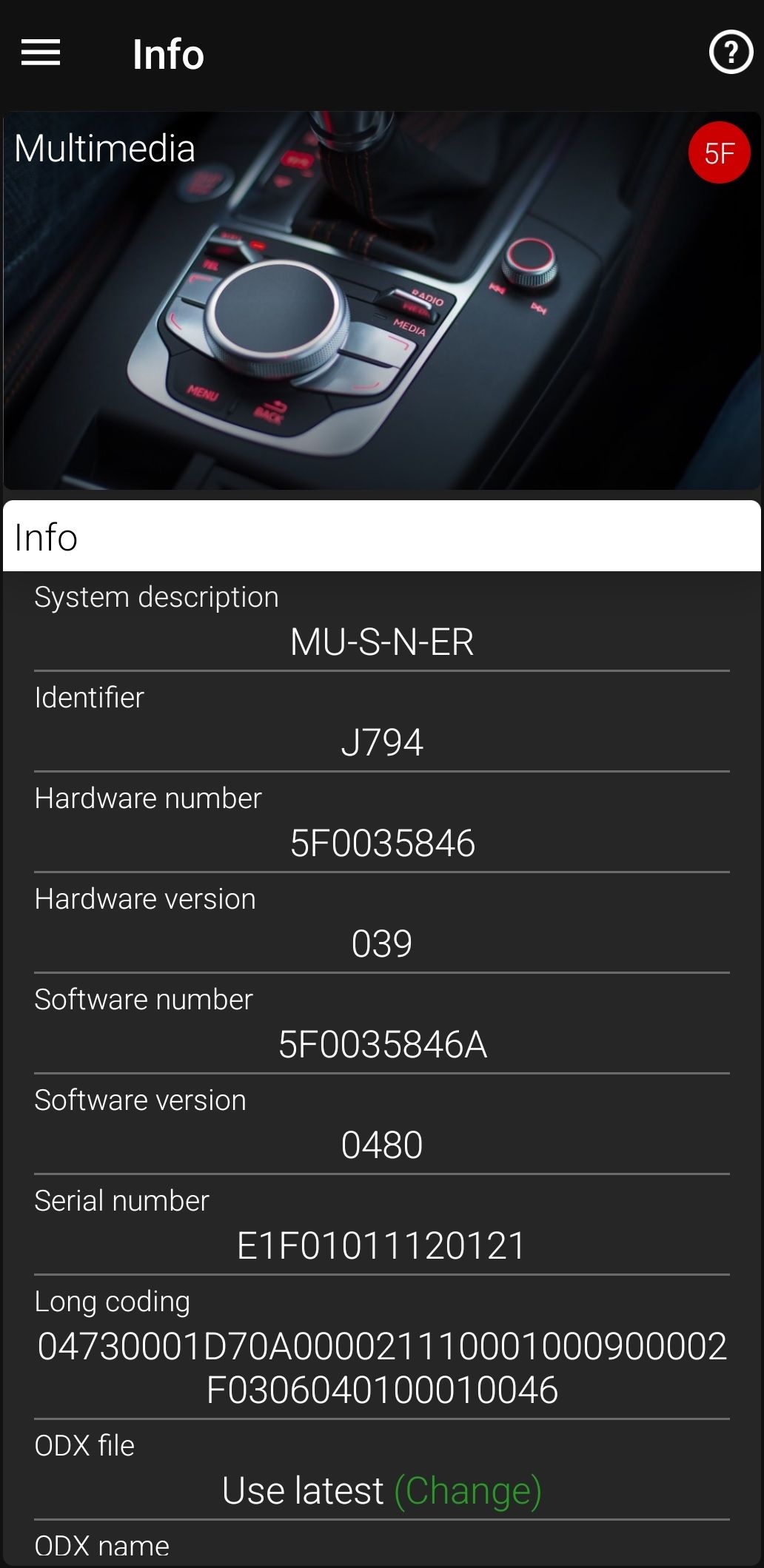

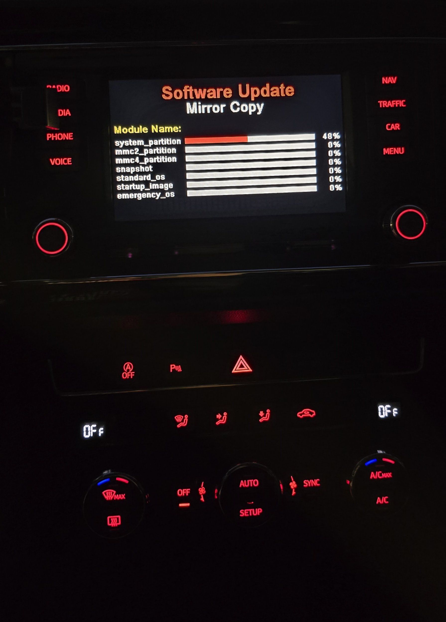

Hello guys, i have a problem with my multimedia on my Seat Leon 5F with factory MSTD_EU_SE_P2313, MU Version 0132, i tried to update the software version with rar file from mibsolution.one (MSTD_EU_SE_P5310 MU0480), everything was going well on the update but when 3 files left to overwrite all of sudden multimedia went black but not completly black and it stays like that all the time, when i try to restart it with holding power button it goes completply black and come with power again but still black and i can't do anything now, i checked it with obd11 and there is communication with 5F unit which i think is a good sign. i need your help if you have any solution...i just want to make it like it was before no need to update it, thank you in advance

As you obviously found out, you cannot jump from 01xx to 02xx, 04xx and so on.
Even though you have connection, the unit is now bricked.
I assume your best bet is someone with ODIS being able to write the correct software or then (don't ask me how) removing unit from car, building an interface that can write straight to the chip and downgrading the software via a computer, since you don't have access to the screen anymore to start an upgrade process.

Yes you need to seek help on the mib2 firmware thread
You are told n th times not to jump firmware trains. You can't as per above.
This thread is solely map files not firmware files. I believe you can open these units up and short a couple of pins out which de bricks it. You'll find instructions on the Internet. @East Yorkshire Retrofits provides a service of train jumping and has sorted peoples units out in the past where they have messed them up. Unfortunately the likes of Mr Fix with YouTube videos leads people into going up a dead-end.
Anyhow and conversation on mib2 firmware should be on that part of the board. The unit are like early computer so you write across the boot firmware code with the wrong train.
