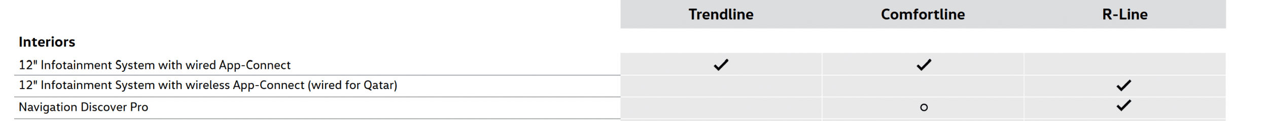

@Ammar2jz your friends car the PDF if it's the latest one:
You are looking for Navigation Discovery Pro on the spec
It is optional on the Comfortline and installed on the R-Line.
The VW Terramont is built on the MQB platform. It really dependents on the model. Prior to 2020 it will be Mib2. Mib3 on but may be old stock hanging about. R-Line is the luxury so you never know if you put the USB in it may take it. Otherwise, you are looking for a retrofitter if Mib3.

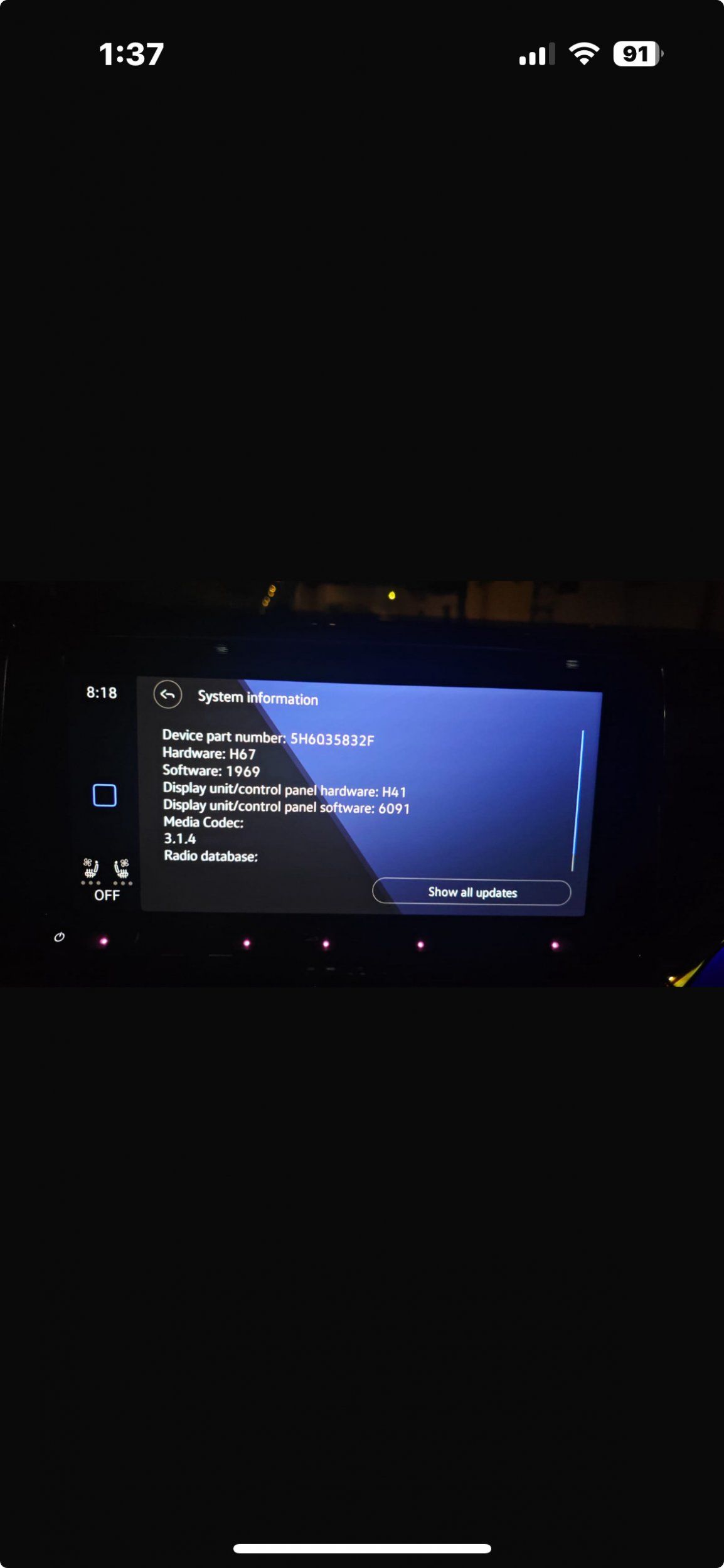

You could feed in the same details as you did to Mib helper to see whether it pins it down to mib2 or mib3. USB-C it's mib3... so you don't have to do what I said. If mib3 just try it with the USB drive. It won't hurt it.
Here you go this is a picture of the entertainment system

H67 is an interesting code. Have you tried the usb-c. ?.
The car could be one of those without navigation on the pdf. You could ask the dealer for a print out of the build codes. See what that says about navigation. Whether it's mentioned. If it's usb-c and the working usb doesn't take it then it's probably a job for a retrofitter.
I have never seen a case where it is as easy as inserting a usb stick with maps on it. Even if the hardware supports it, I don't think that the navigation FeCs are enabled.

Probably true but worth a go. Dealers will give the build codes then take it from there with a retrofitter if the guy really wants it. Retrofitter will also look up the car, if they can't do that then they are unlikely to be able to do the work. This is just like early days of mib2 high in the UK. You got to find a decent retrofitter like the boards sponsor. They will want to see that picture as well. All would not appear to be lost from the 5H6035832F device part but may not be activated for navigation.

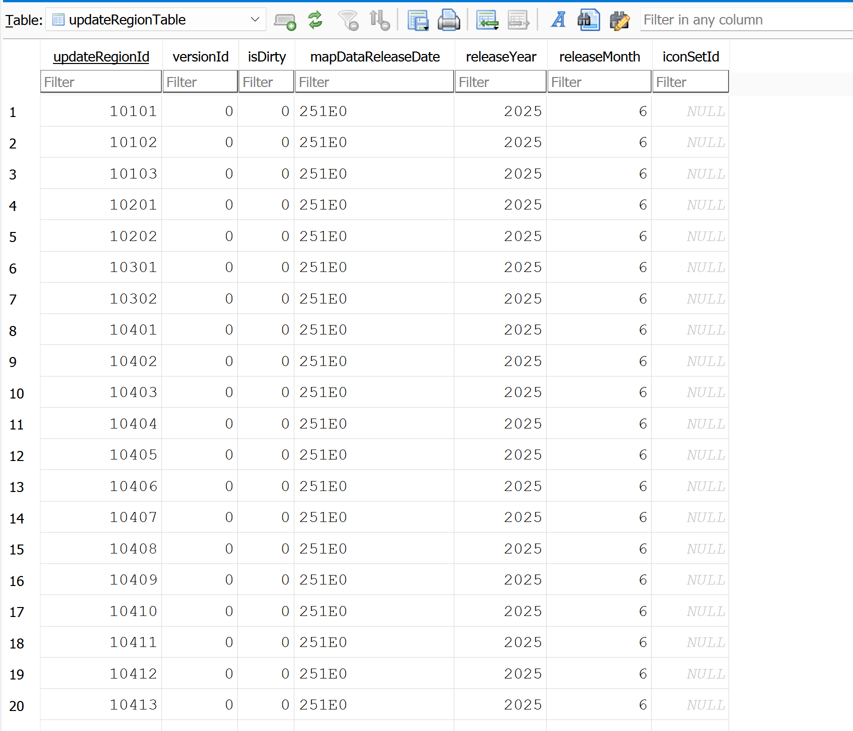

Mib3 navigation off line file release has started to show up for June 2025 reference 2025.02 - thanks to MartiniB... so far:

If you happen to live in one of those areas that's your update. These files can be used across Seat, Cupra, Škoda and VW. Because it says Škoda link doesn't mean it only works on Skoda's.
BTW I've decided with this thread I'll do it like the Mib2 navigation thread and put the latest release at the end so previous releases can be seen. Suspect it won't be long till the missing regions get filled in.
