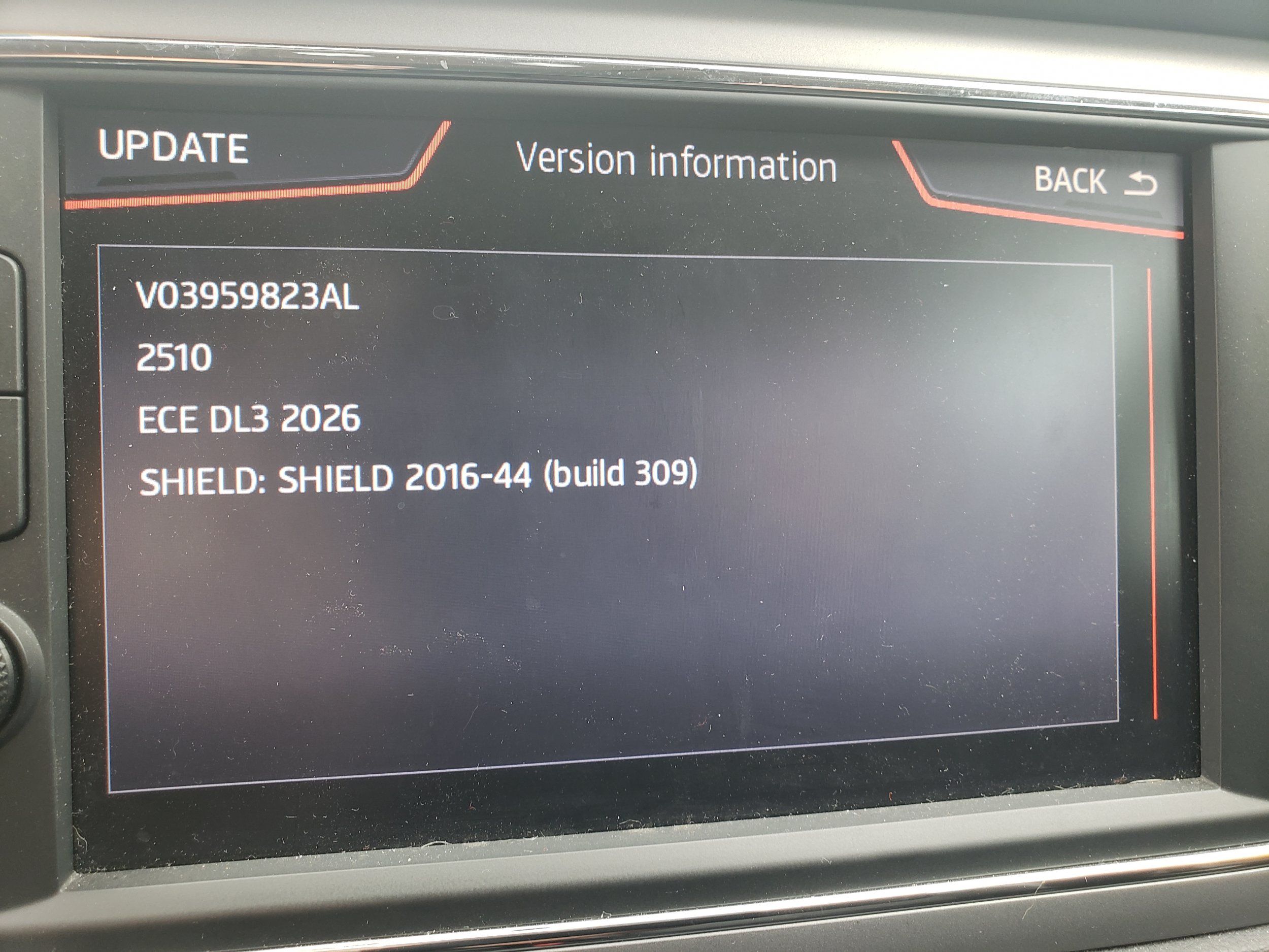

Mib2 Standard November 2025 release
I've added the Rest of the World files now MartiniB has identified them, release 2510. ECE 2026:

All good with the update, no issues whatsoever, obviously keeping the original OVERALL.NDS

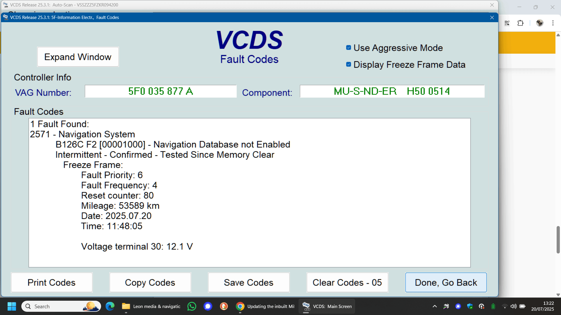

Also, @Tell , VCDS still shows the elusive error in 5F information electronics that "navigation database not enabled - intermittent" and has done since the first update a couple of years ago from factory 1030. A quick google says this is down to the Overall.NDS file, but that is the original, from the original maps supplied from the car. Is there any way of clearing this error for good - navigation never fails to work, and nothing wrong shows, just this annoying error on a VCDS scan, thanks

The error is a side effect of the workaround. The workaround generates another navigation FeC which it uses but still has the old one. Normal clear coding errors doesn't touch them. The mib2 standard toolkit is suppose to be able to clear them but doesn't come without issues. Since the error caused by the workaround isn't really an error but just a warning and the anarchy of mqb evo platform, dealers don't bother about the codes. Best to forget about the "error"... just one more error dealers see these days. ;)
