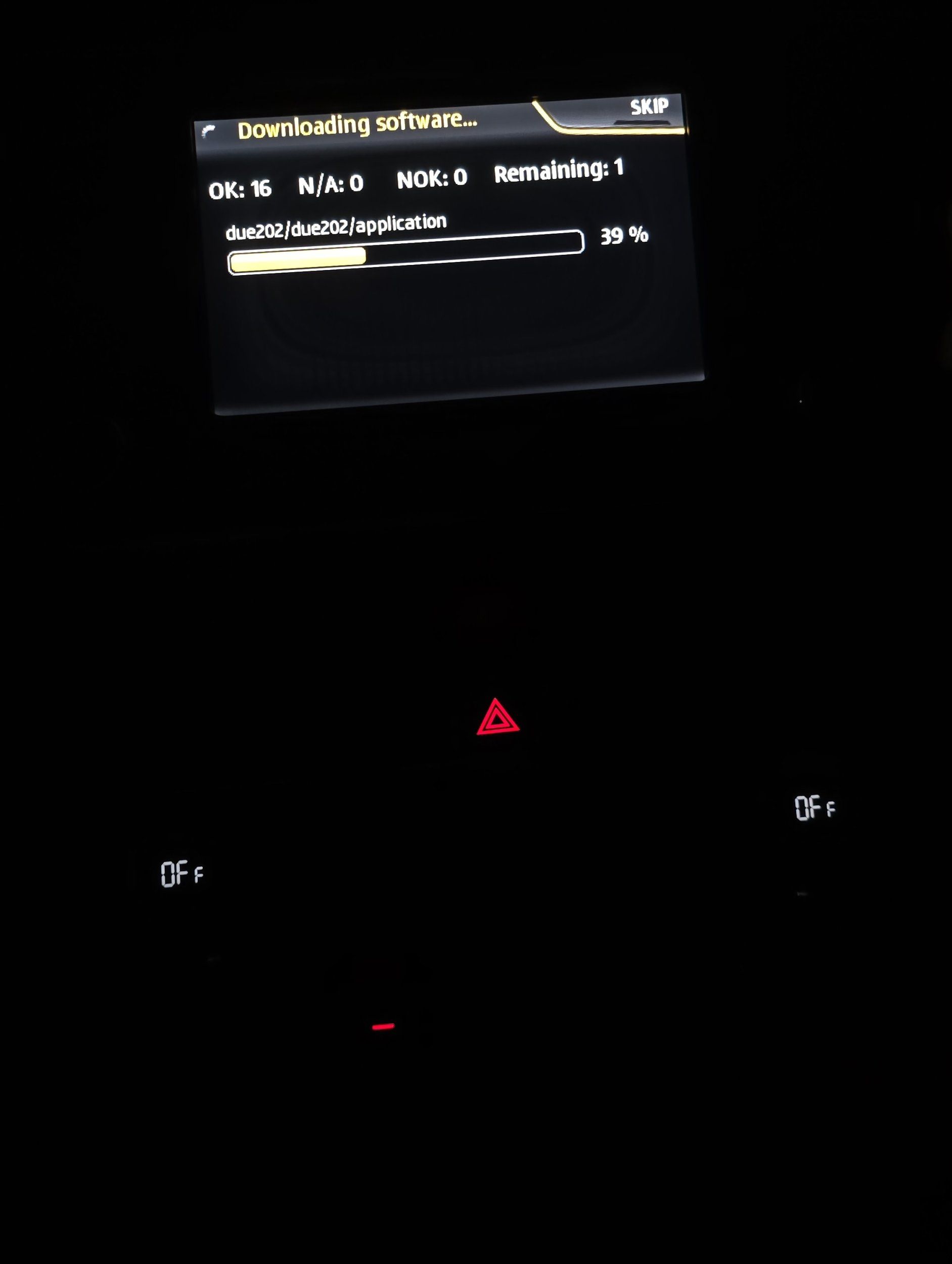

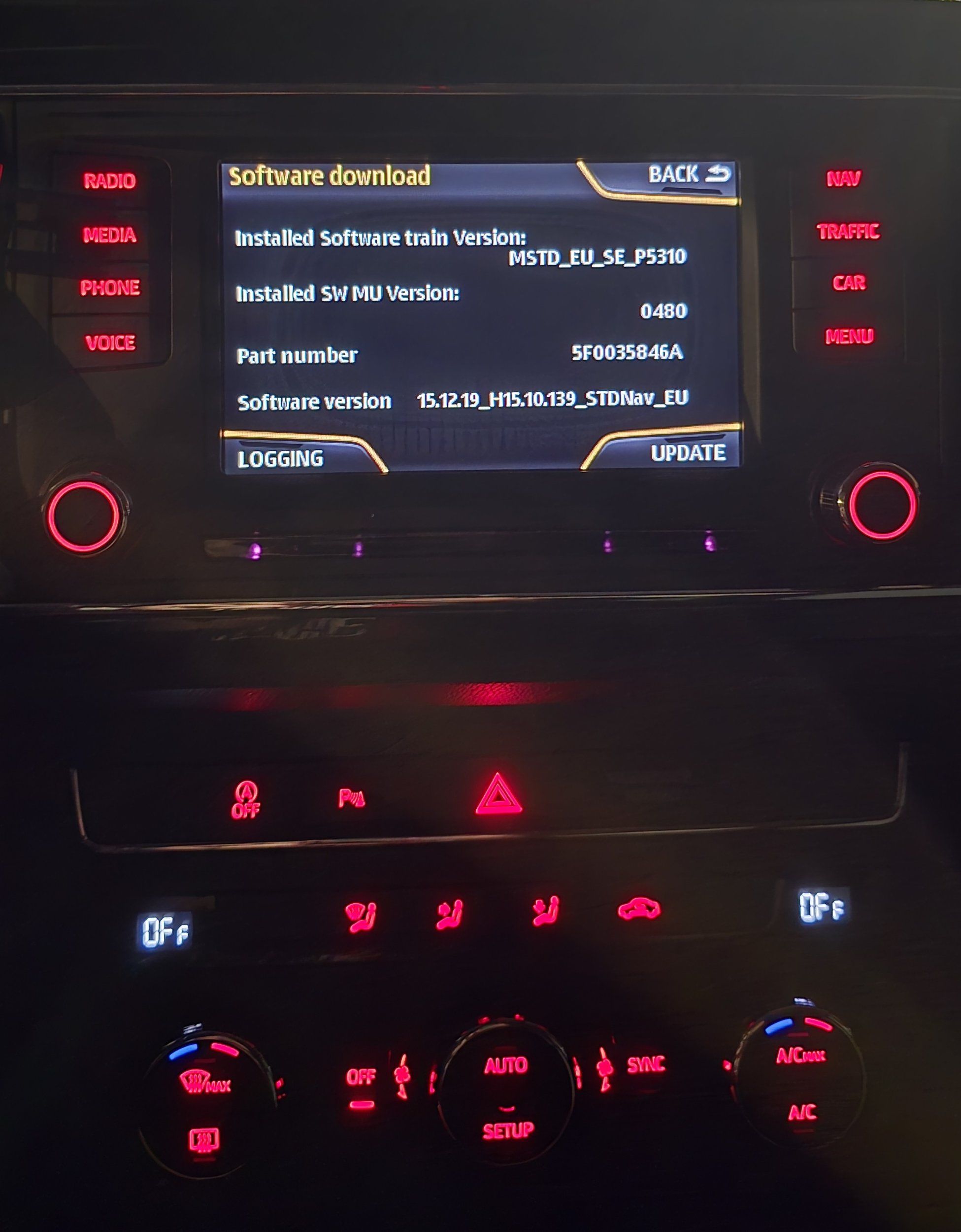

It worked, Thank you very much. I appreciate it. I did the coding how it was mentioned above and then restarted the multimedia by holding power + menu and it continued the update successfully

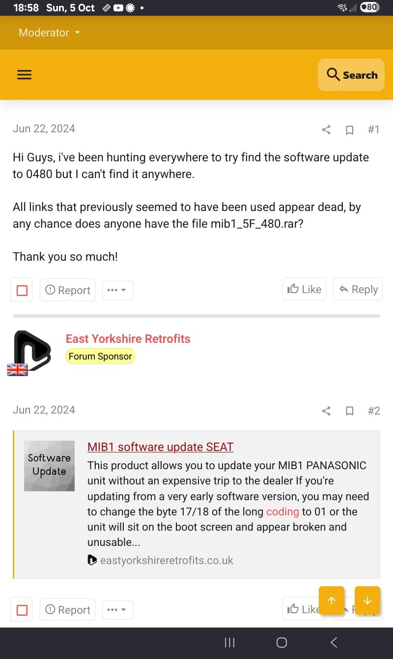

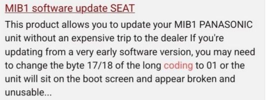

You got @East Yorkshire Retrofits to thank for that. They use to sell the software but Vag prevented them since one presumes they wanted to make it dealer visits only. Probably some note that was published with the 480 mib1 firmware at the time which said if an update of older firmware then do this which they put in their advert now deleted.
Vag changed the long string for reason which meant you had to do it to make it work. I remember it came up on their web site before they took the page down but we had never found it an issue on the navigation thread with people updating to the mib1 2023 maps but evident by that post it does effect some people as you found.
Reactions: DaveS and ak1_

We still perform software updates here at the workshop. We do not distribute software files themselves
The available skins changed, meaning the new software is trying to launch with a skin that doesn’t exist and is getting stuck

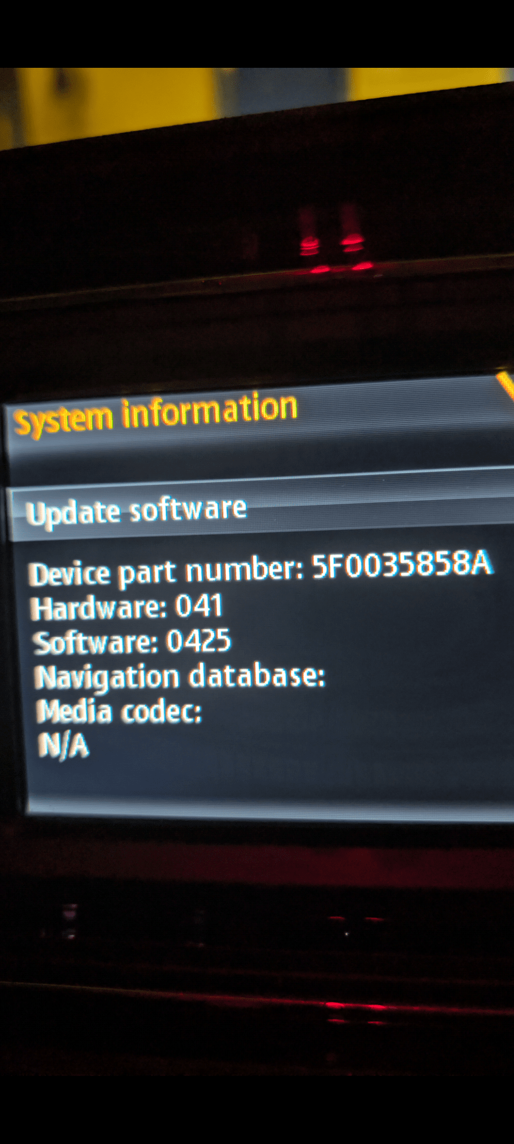

Hi all, new poster here and apologies, I'm not a cupra owner, just an SE tech 1.6 TDI 15 plate. I've got what I assume is MIB1 (8 button radio)
I'm running an old firmware and I've found the screen to be a bit leggy, touchscreen stops working on initial startup and freezes. So I'm wanting to update my firmware prior to installing the carabc wireless carplay box mod.
I've attached a photo of my current firmware. 0425.
I don't have an SD card in at present so no map data, but if it makes a difference I'm not interested in adding standard maps data as I'll be using carplay/Android Auto.
I'm a bit of a noob, but I downloaded the rar package from page 145 of this forum, firmware 480. Can someone please confirm this is the 0480 firmware for the Leon mib1 unit?
Also, regarding installation, I found this from another thread - so I guess I'm just looking for someone to say yes - the file is correct and yes - that is how to install it or if I am missing anything. Here's the instructions from other thread:

Appreciate the input. And if this is the correct procedure, thanks to @Daz3d for his upload :) one last thing- to update only the firmware, can you use any SD card or would I need to buy either a brand new one or a VW specific one? I have access to plenty of 16/32gb cards at work, class 10 I believe and have no issues formatting this and formatting to FAT32. Thanks!!

The 480 firmware if installed on systems with older firmware can appear as if the system is hung but through coding after its installed you do what is linked to here:
Read up a bit to that post where it comes up. It was known about and the solution is as discussed above there and I put it into the resource section linked.
The fix if it looks like the unit is hung after installation is this:
The discussion about it is covered on the link when I asked.

Sorry I'm struggling to follow, when I open the link I can't see the coding required? Is this done through VCDS (I have access to this, FiL has a genuine cable and VCDS and he is more clued up with coding - I understand how to format, extract a file to an SD/USB, plug in and run the software update option in settings. Much beyond that is where I'd not feel as confident.
Its that in the box above.... and below. That was from East Yorkshire Retrofit when Vag allowed them to sell software. Now the page is deleted off their website but I found them giving out the solution at the time on the board here. Reproduced it and brought them into the conversation above. That was their old advert which they cant place now else they would get slapped wrists from Vag. They came into the conversation and said you might have to adjusted the long string but didnt say what the adjustment was, rang a bell to the now deleted advert but found the information previously given by them on the board here. That then fixed it for the person with the issue.😉
The coding is for the infotainment unit. Long string. As said it only effects units with older firmware with the older string. You could look at the long string before the update since that wont change in the process. Obdeleven Pro version or VCDS etc. So you need a coding device else you could make the unit unusable without.
