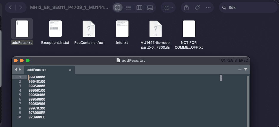

I have tried to add new FEC via addfec.txt in M.I.B but it won't apply to the unit.

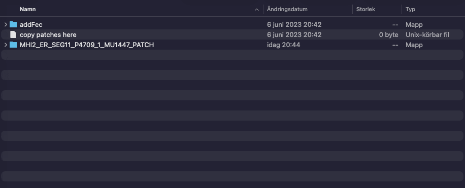

Thank you for your answer. Unfortunately, I have renamed the patch map to "MHI2_ER_SEG11_P4709_1_MU1447_PATCH" but still the unit won't update the FEC.
I will attach screenshot of the sdcard.
After I used M.I.B. to add the FEC, I used long hold for on/off, but nothing was added to the unit.
You should be able to communicate with the developer via a link on the github site. That had to be done once when someone in Australia used the tool but left them with European FeCs. I told them the issue but they were unable to do it themselves. That FeC list should preserve the line feed, carriage return that was in it originally. So the file end, however it originally ended, needs to be maintained. Old programming thing that you had to lookout for.
Basically you backup, then run that command. Then after it's done it's thing, introduce a reboot else it doesn't refresh itself.

Basically I think once you have done that backup command then it will write back to the SD card... that's the back which I think is the clue of what Taztosa is talking about. Hopefully it will stick out like a saw thumb. The program has been re-written from when I used it, so I'm not recognising what I remember which was a sequence of difference software. Been generalised now I think so it will only be after it's run with that backup I reckon you'll see what's being talked about. The source I can't see it in un run.
Hi,
I can confirm that the backup did it, but I needed to remove the previous backup before starting a new one.
So now I have the Skoda FEC (08300008) applied and maps 450.

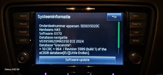

Hi everyone,
I have an Audi Q5 equipped with the MMI MIB2 Standard system, currently running the 2024 maps. I downloaded the new 2026 Europe maps from the link posted by Tell, but I noticed that the file format and structure are completely different from my current version.
Does anyone know if I need to do a firmware update to install them? Or are these new maps simply not compatible with the Audi MMI MIB2 Standard unit? Thanks in advance!

Tell, thanks for the reply! I originally downloaded the 2026 maps from the MIB-helper.com platform, and that's when I realized they are different from how the maps were up until 2024. I couldn't get them to work then, just as I haven't been able to now. I need to look into it further; I think I'm making a mistake somewhere, after all.
