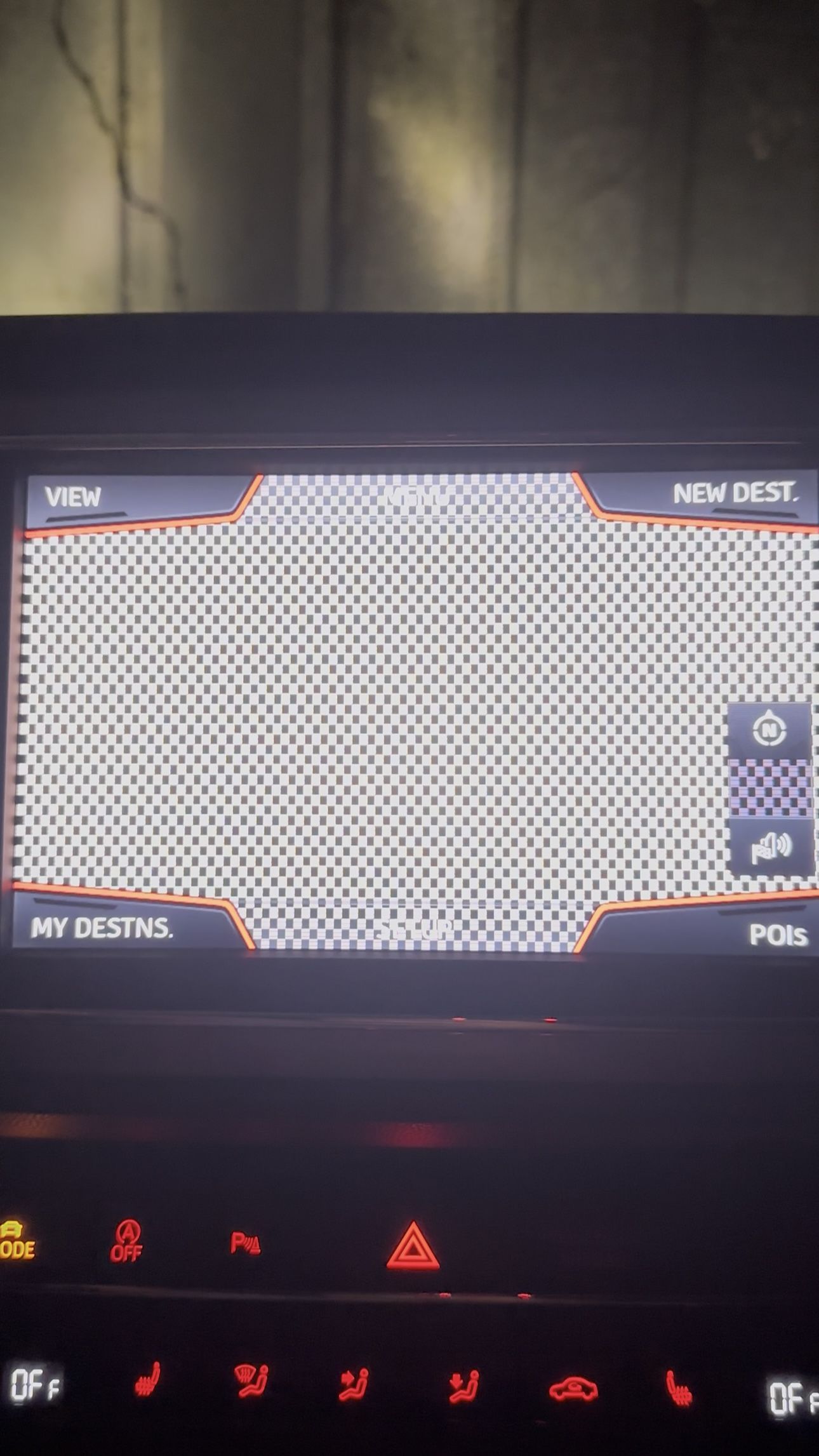

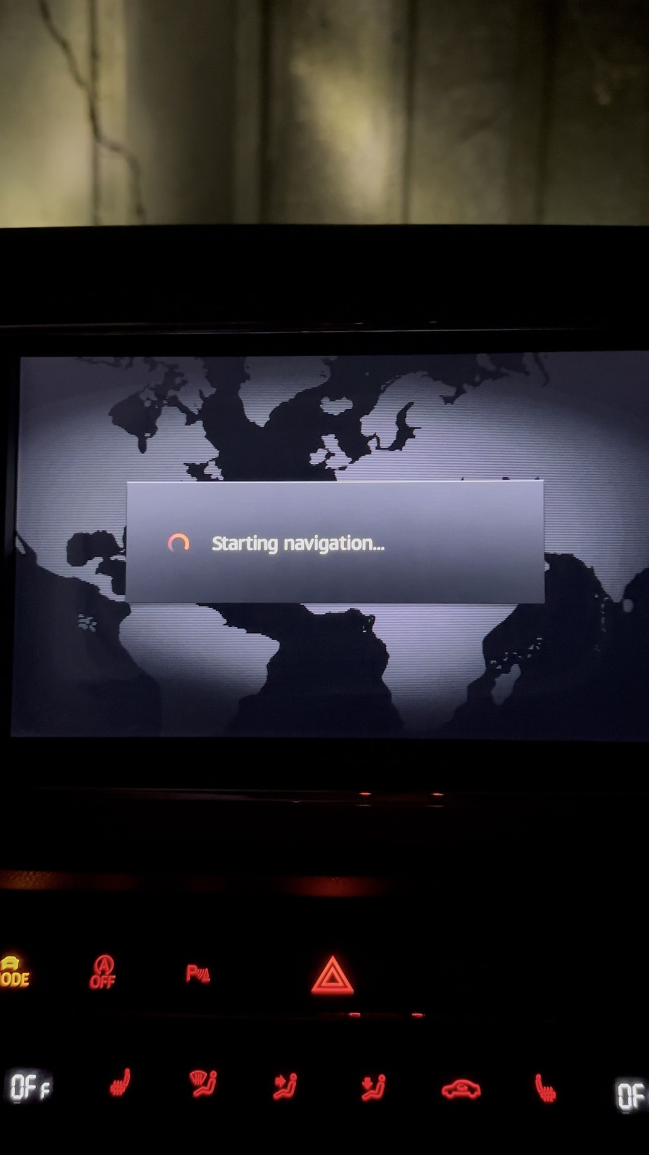

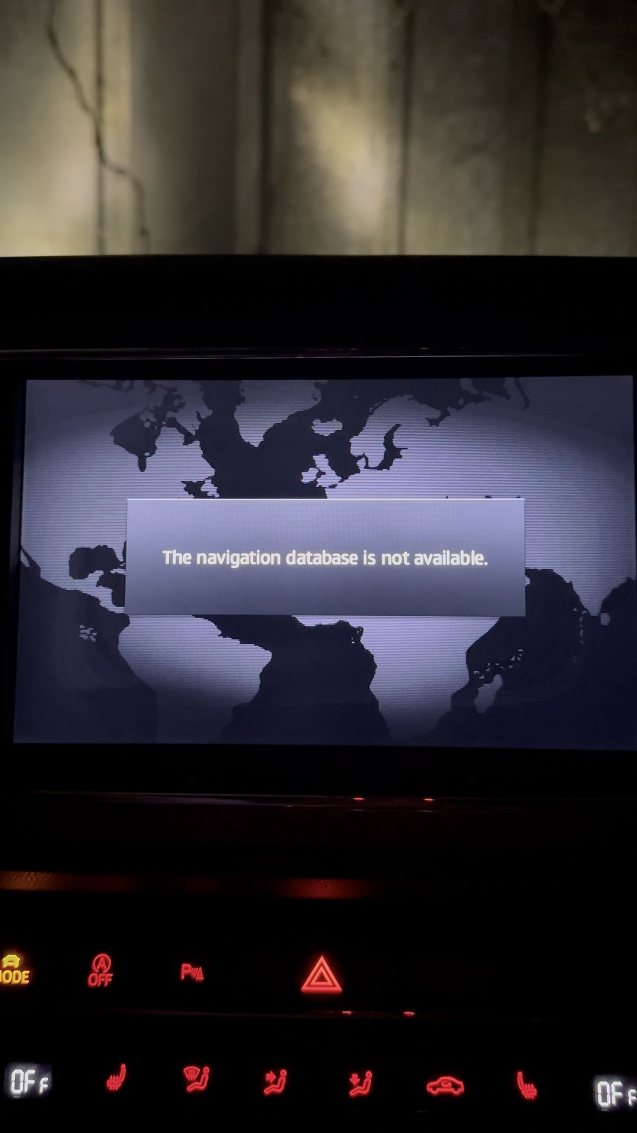

I tried the procedure multiple times and it didn’t work, then I guessed I must have an MIB 2 High unit since nothing was working.
Tried the procedure for MIB 2 Standard again and the result was the same with the only difference that it started loading in the beginning and then gave up again. (Tried both the OVERALL.NDS from the original card and the one uploaded on the forum)

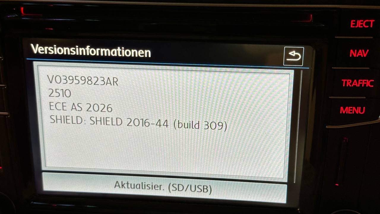

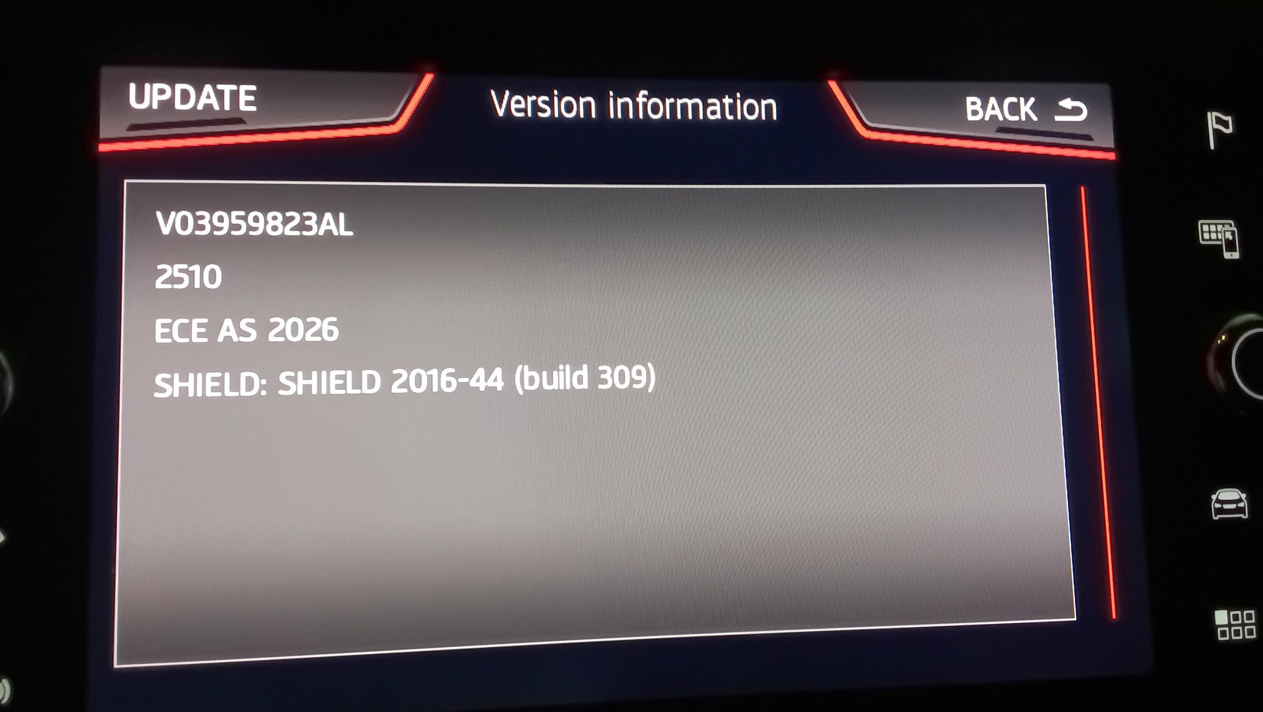

Success screen. November 2025 comes early.
