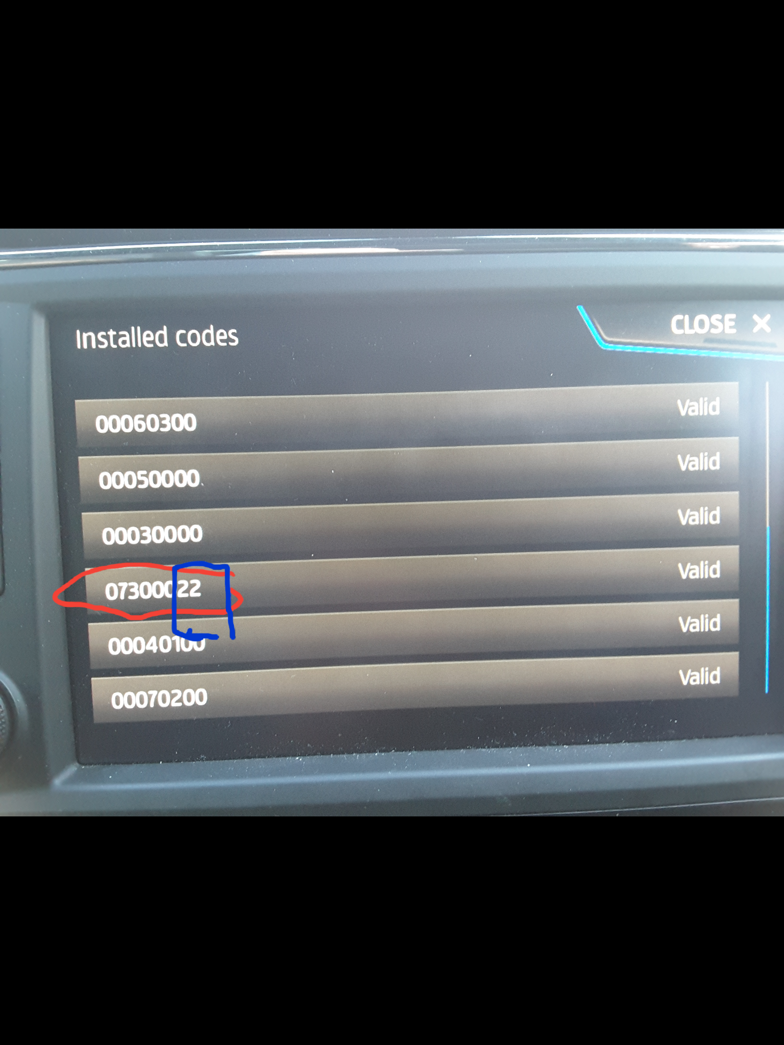

How to do it:
1. Hold Menu button until service mode shows.
2. Press "Function enabling codes (FEC, SWaP)"
3. Press "Installed codes"
Look for the FEC starting with 073 and note down the two last characters as per image example.
Use the table:

For example if the Mapcare code ends in 22 you can load up to and including the June 2019 release but can't go beyond. 16 covers June 2016 but not beyond. 10 doesn't include 2015 June. 3f means you can update to November 2026 etc.
Those people with Mapcare or retrofits can check up to when they can update their maps against the serial release.

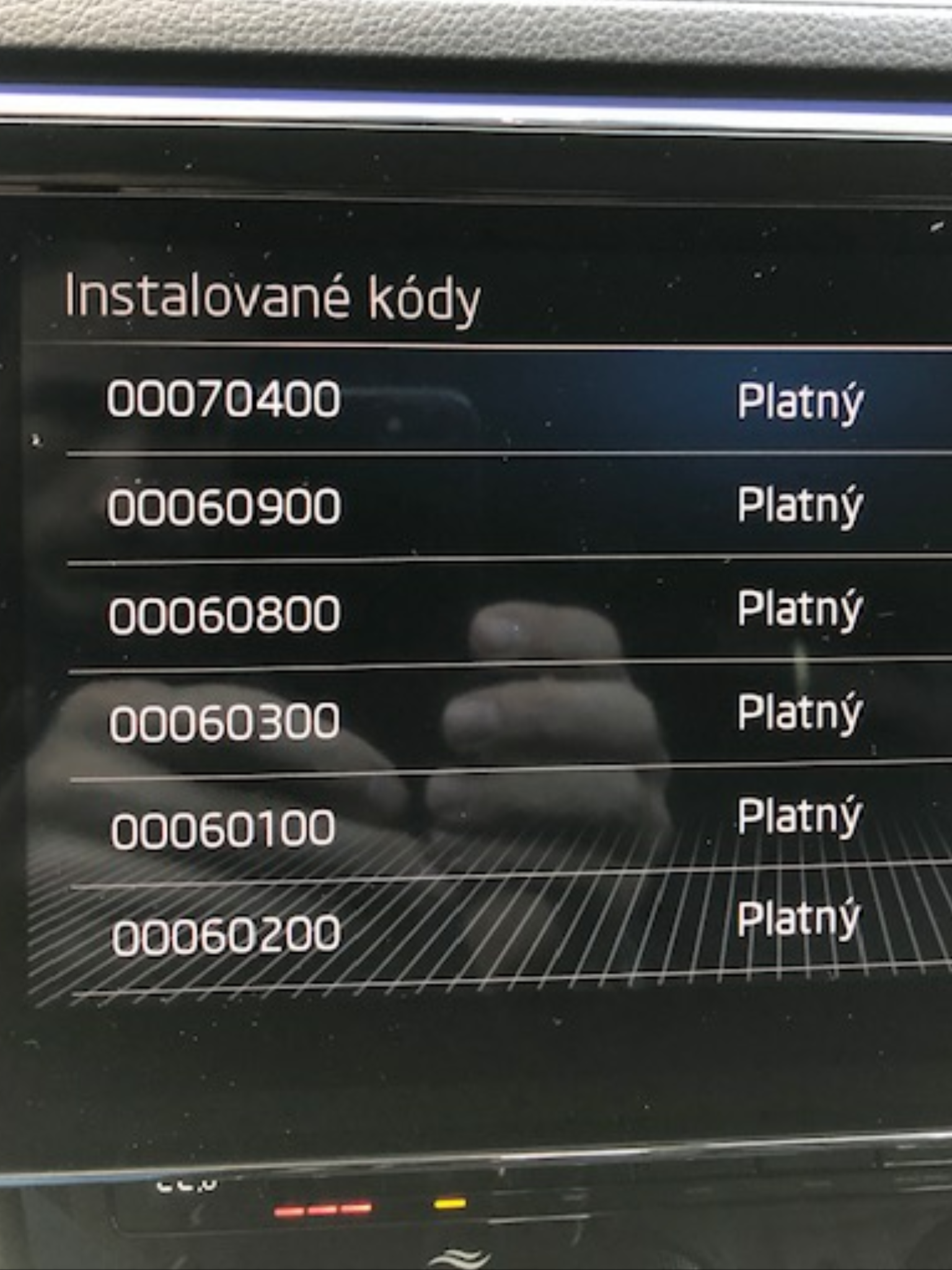

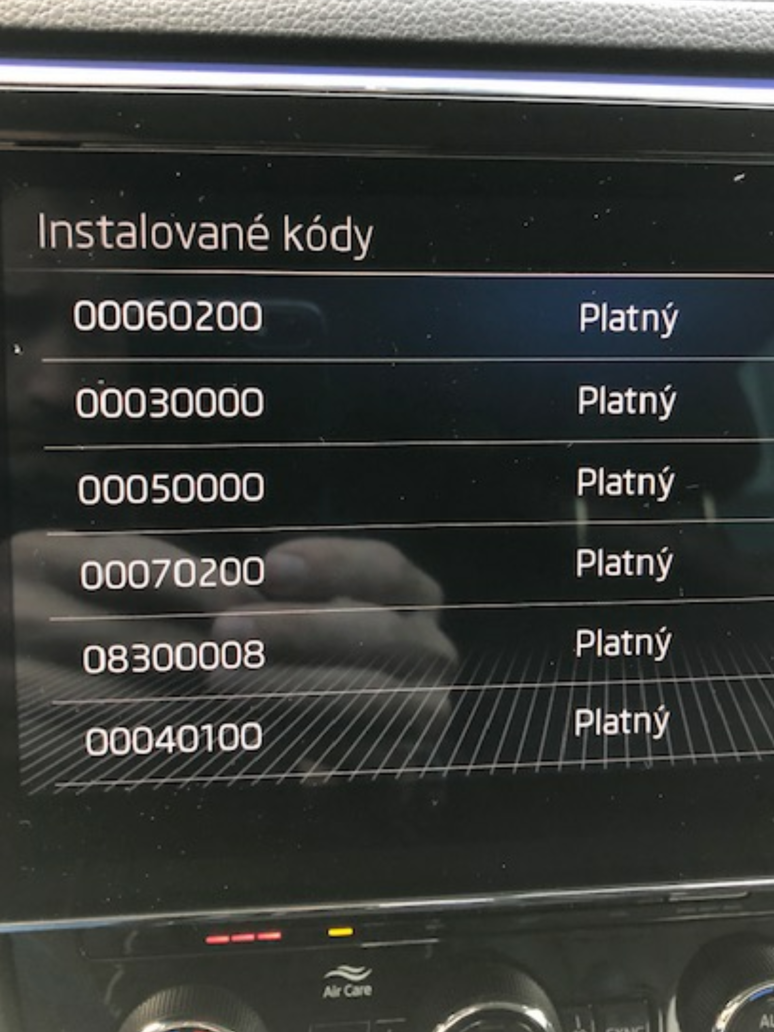

Whilst the above indicates whether you can update the Seat Plus maps based on its Swap / FEC code (100% sure how that works), I was kindly sent the Skoda Columbus Kodiaq codes where the maps can be updated for an unlimited period. For this unit I don't know whether that is achieved by the firmware version or setting the FEC on a Mapcare code low or high. If it's the latter it maybe 08300008 which looks like Skoda's version of the Mapcare FEC, which would be low (08). That's just speculation thou. I have no way of checking and mine are set a bit on the high side now .
Edit. 08300008 is the Skoda lifetime FeC - we like it.
