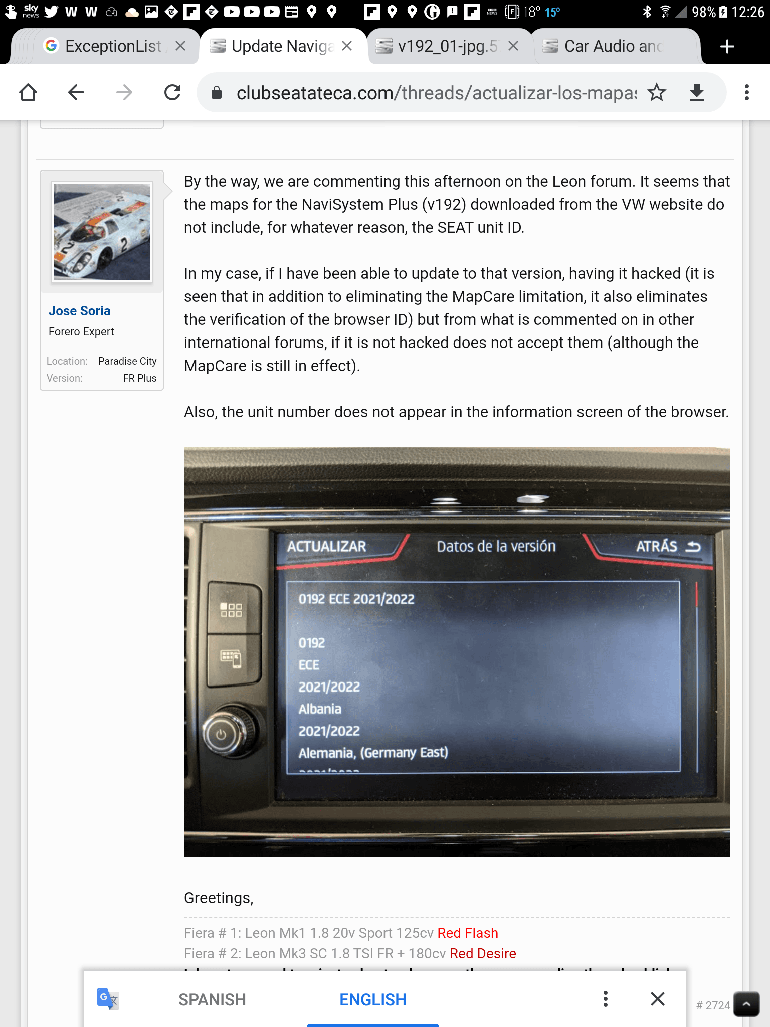

Anybody got the mib2 high navigation release 192 loaded on their modded units yet ?. On the navigation thread I determined that it was @Chillout who was posting with it working on Drive2 using his mib tool box project
(Background VAG left the Seat part number out of the map release 192 so it won't load up on stock firmware with Mapcare or regular Seat navigation FeCs.... some say Seat will fix it, doubt it myself, think they have junked Mapcare updates for Seat)
All you need is 1447 or one of the other two before + The mib tool box... I did ask for a link to the software but I think @MIB-Wiki PMed me one a few months back. Chillout doesnt say what FeCs are required....
Meanwhile Jose the Spanish Seat guy I found has it working as well on a retrofit he got done, didn't do it himself. I got him to reveal what FeCs it has in it.
So we get to this point... we don't know exactly what Jose has in his exactly but I suspect it's one of the Mega files.
There is a Digital Eliteboard thread in German which I believe may be the key ?

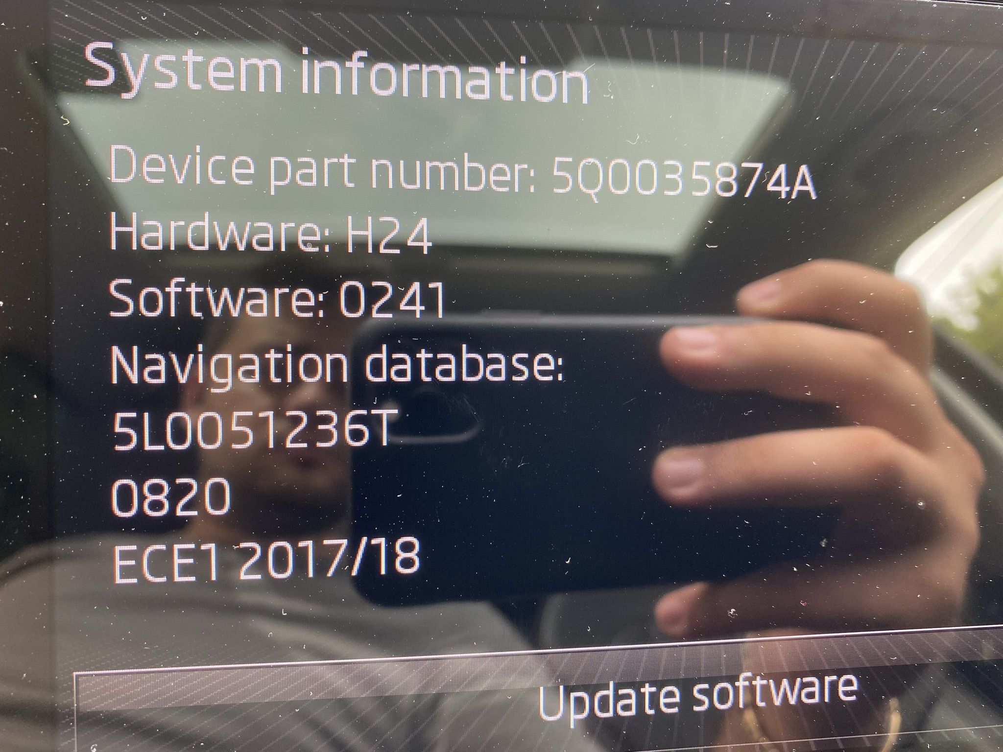

Hi @Tell ,
I tried to install the 0192 maps on my 2019 Cupra R ST with liefetime map updateservice. After inserting the card a message came up, telling that update files were found. I started the update, but after a long search a message came up, telling that no update files were found.
Tried again, but the same result. Tried again with new downloaded and unzipped files, still no success.
Then tried the 0189 files (coming from 0187) and these installed straight away. So there seems to be a problem with the 0192 files. I wonder if this will be repaired. I could only download the 0192 files from the provided link, could not find it anywhere on the vag sites.

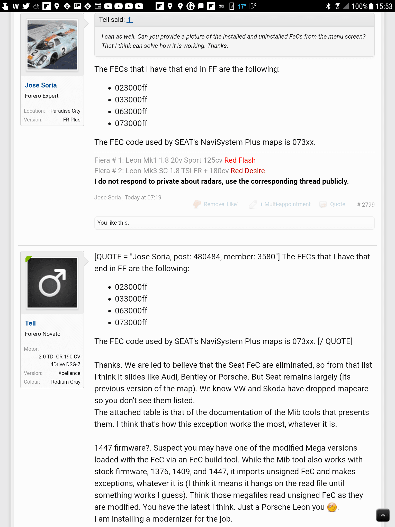

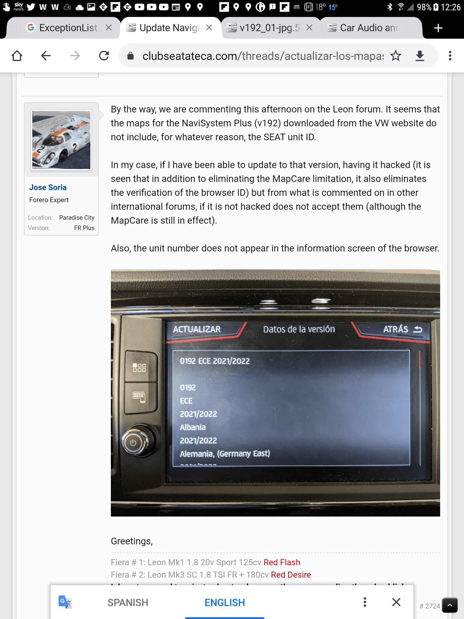

Yes the Seat part number 4 is missing from the 192 download which can be found in the dbinfo file. What that means is the units firmware doesn't know what to do with the download. The map upload files to the unit are sufficiently protected from users editing those files to put the part number back in and a mute point as to what else is missing even if you got the the part number in.
Those who have the 192 maps loaded on Seats use custom firmware. They have an exception list method which basically as understand it uses the correct part number, if not will then try for another and has the associated navigation FeCs for that. That's why you see in Jose's screen no Seat part number shown.
The only doubt in my mind with loading up this project software contained in the link is my last retrofitter statement "that after I do this you won't be able to load up firmware yourself". If it's original firmware you are coming from that's not an issue. Although the firmware that I'm on went in on a manufactured SD card rather than a D-link box. They did use the front camera port of the unit to read the units settings then went on to manufacture the upload via SD card for the firmware. Anyone, does that sound like the "D-link method" ?. Am I alright or has the retrofitter made things difficult for me ?.
Back to whether 192 is an aberration. I suspect it's not and Seat have dumped Mapcare. Either they badly got their wires crossed in the spec of 192 on what you are seeing. The release was manufactured six months ago as part of their testing programme, so for six months Seat knew that it didn't work on their units.... or should have known if it was a mistake. I can only think that the Seat Mapcare market was so small they opted to withdraw internally from the VAG project. Both VW and Skoda don't charge customers for Mapcare. May be it's an internal charging squabble that we are seeing. Now VAG have moved to mib3 they have no production requirement for the maps for mib2 high, just Mapcare.
Anyhow if people can comment on whether my old retrofitter has left me a problem in there way of working.
Hi @Tell ,
Thank you for explaining!
I still have the OEM firmware in the Navi Plus. So far updated the maps successfully from the original 0172 to 0176 to 0187 and now to 0189.
0192 is the first one that failed.
Could it be that, if there is a way to include the missing SEAT code in a specific 0192 file, writing it back with the same date and time stamps as original could do the trick?
SEAT is always far behind with the map updates, compared to the other VAG brands. Maybe they still don't know that this 0192 version doesn't work? After all it still isn't mentioned on their servers as far as I know.
Why would SEAT bother with making map updates impossible on already sold cars with a license, being it mapcare or lifetime? It would only make the navi system unusable within a few years......

It's the SLA1 signature on the end of each metaindex2.txt protects each file from tampering / download issues. They are signed with a private key but read as valid with the public key. Not convinced that something else isn't missing from those files in the Seat part number in any case. I did spend a long time looking at those files at times.
Normally you re compute the check sums but the signed SLA1 signatures if being used on that part of the update are the stumbling block. Navigation update is one of the ones that requires the signatures to be valid. POI updates, no which is how POI developers generate update files.
The VAG public key is known whilst the private key isn't. It's the same key on all VAG products.
My journey on the subject is here:
Mathematical algorithm is used with the public key to validate the signature but you can't create the signature if you dont have the private key. All VW private keys are the same since the public key is the same. You need a fair bit of computer power, £100,000 of it was a quoted figure on sla1 signatures a few years back to decode the primary key.
I did try a published exploit which is used to get mib tools into the unit to put the part number in. I think that said exploit has limitations so it didn't work. Mib tools rides into the back of a radio station update by putting the payload after the signature.... They forgot about that one in the mib2 design. If the signature was to protect the payload above that's achieved, but not anything going in after. So whilst it works to get that code in, doing that on a big map upload it didn't. They did have teething problems getting mib tools in, you can read that online before they perfected the SD import. It generated assorted error codes.
Seat are now pretty timely with the publication of the maps. They have been known to publish quarters outside of the main six month cycle on production cars. May be if it was a terrible mistake then you might see a 193 or 194 or something. I doubt it thou.
Custom firmware is the way ahead for 192 and Seat mib2 high. I could be surprised and see Seat producing the map download and it's all been a big mistake but doubt it. As far as Mapcare is concerned that will be running out on many units which is the advantage of custom software. Mib2 updates have another four years to run following published mib1 timelines. + 5 years onto discontinuation. 2025. VW and Skoda will enjoy that.
I'm still bugged by whether a full list of FeC codes messes up TSR. I'm told by a UK retrofitter that the issue of MPH signs being read as KPH is due to too many FeCs in the payload (known issue in the retrofitter world apparently). Whilst this issue may not bother drivers in Europe or those without TSR in the UK, it would otherwise. Took my previous retrofitter all afternoon to correct it with many goodbyes and returning again 10 mins latter (speed warnings at 1/2 the legal speed are pointless). Would be interesting to hear whether any Seat UK drivers with TSR have had success with this. Intend to use a retrofitter now to manage this issue in the firmware change. Others have pointed to the FeC being a European one in the past. Previous retrofitter went back to my old settings and reloaded. That fixed it (could be they studied what was in the working FeC container file and the one they put in, corrected but said nothing of their error).... hence why professional are a good idea at times ?. Mind you they introduced the problem.

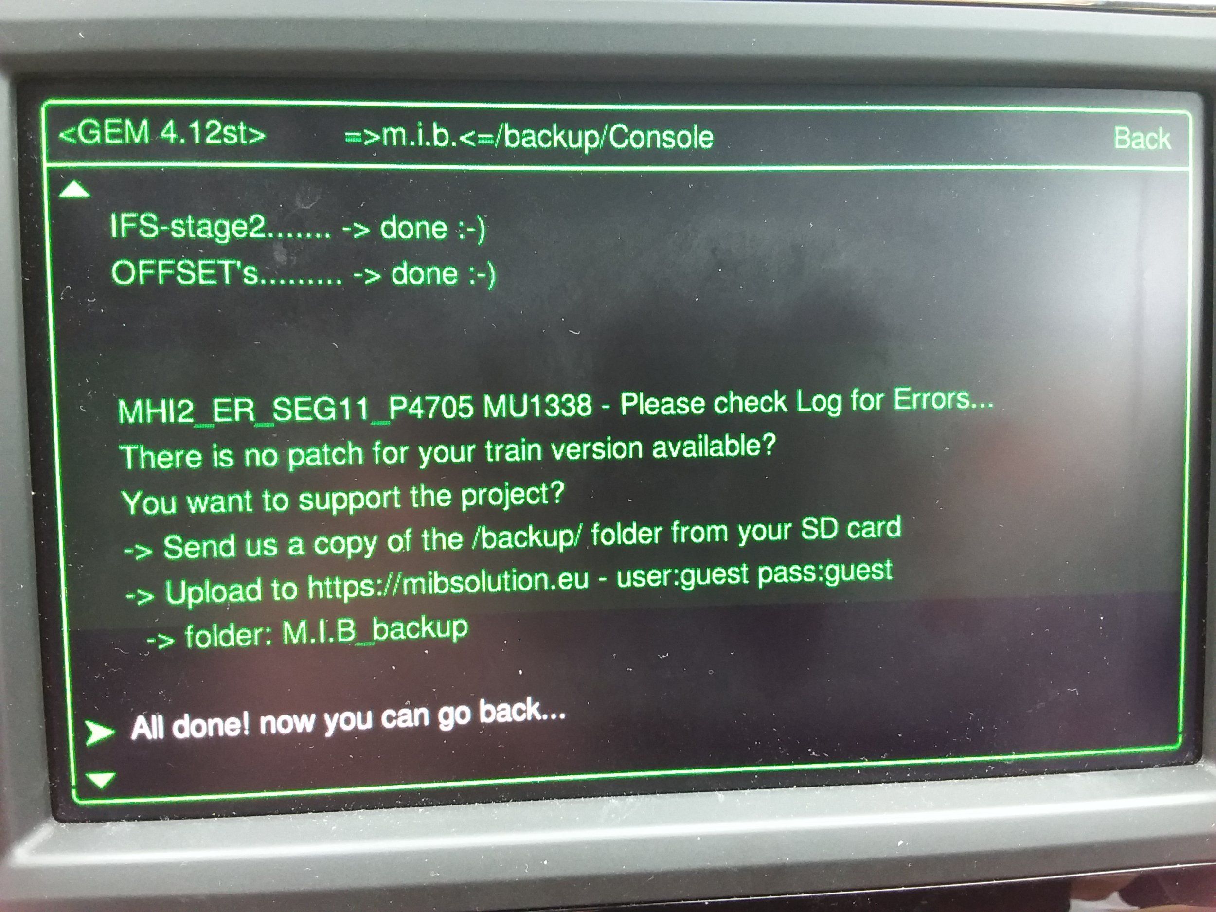

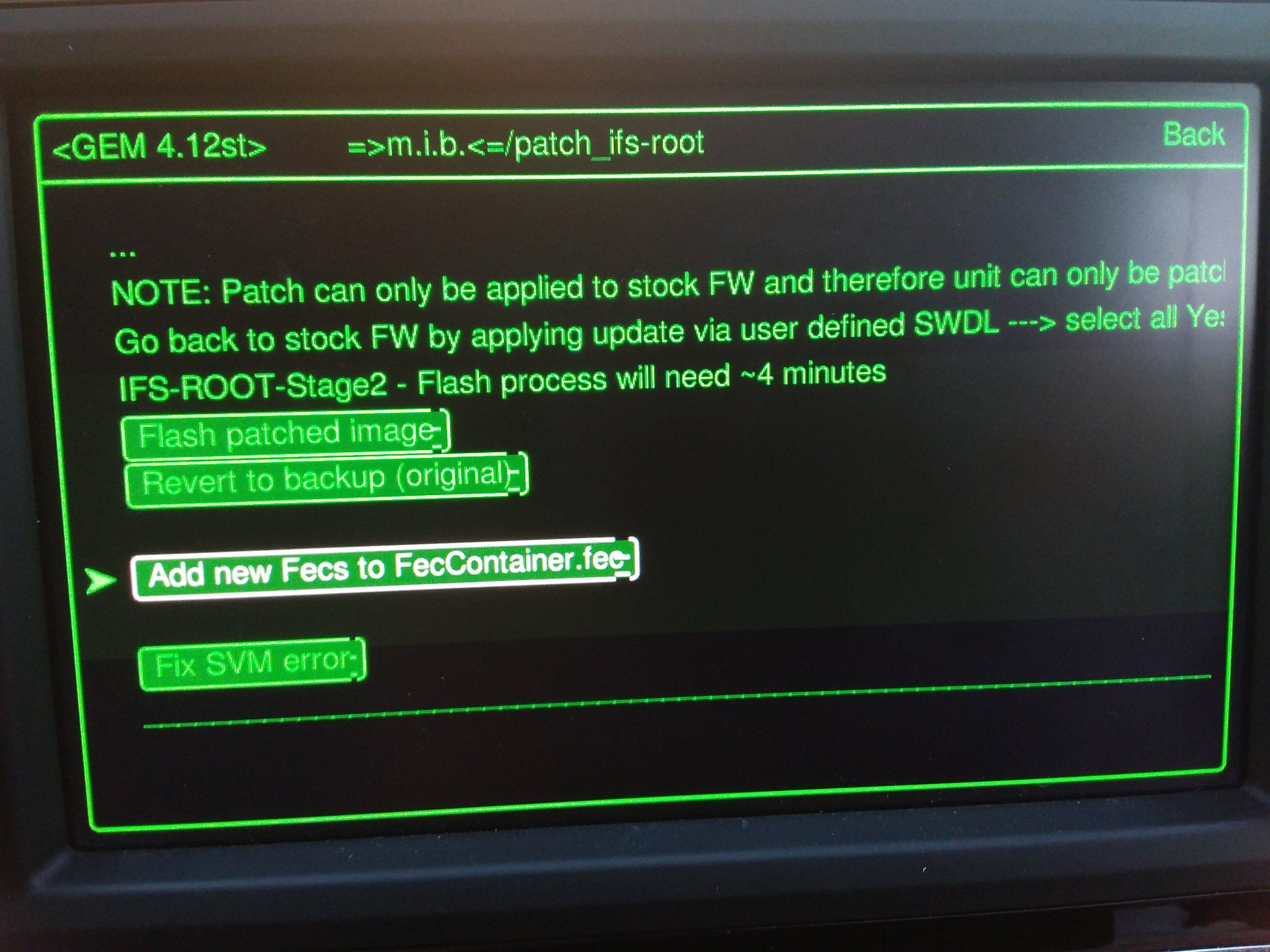

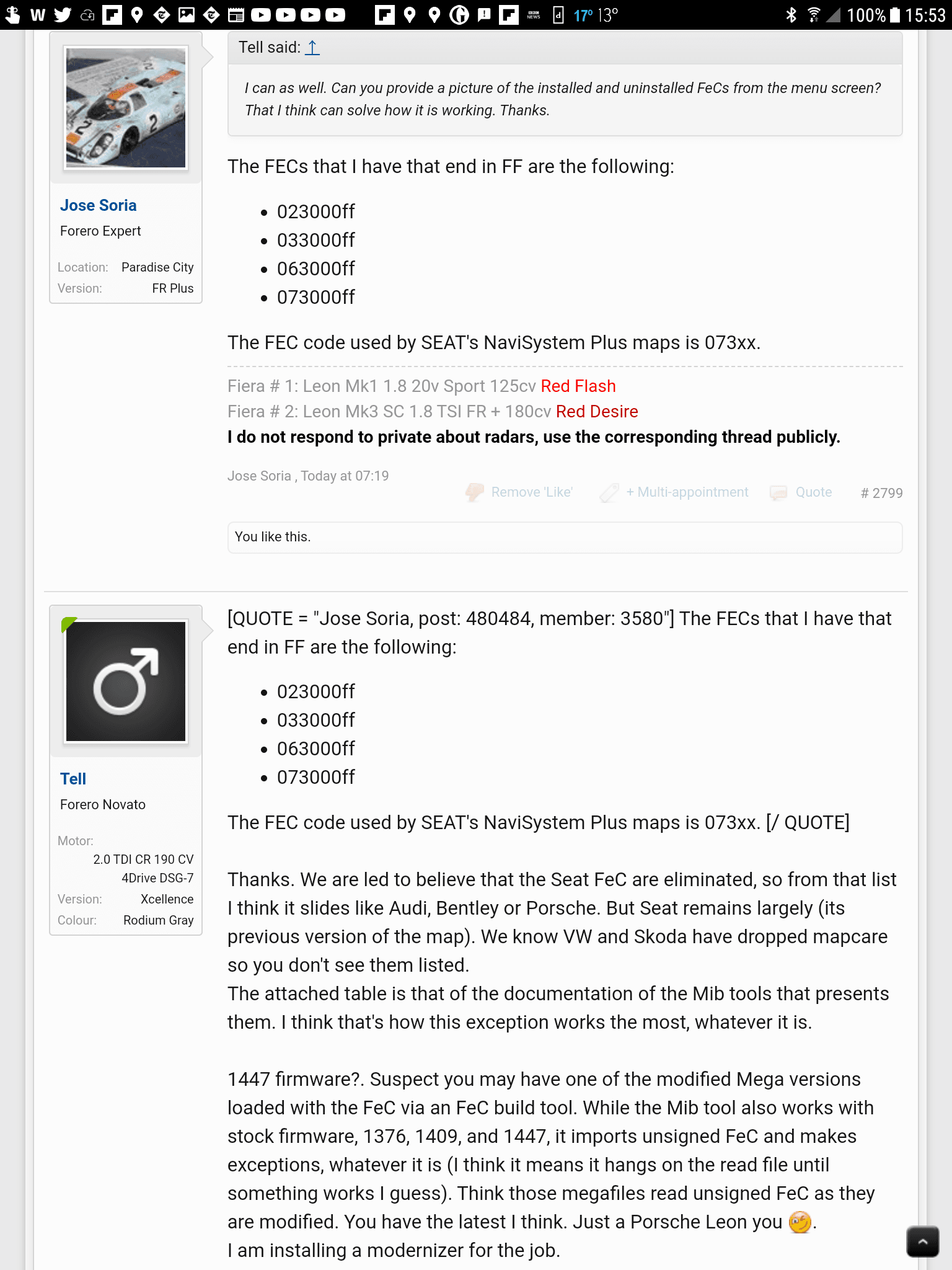

Wait as suggested by you or use M.I.B to enable supported FEC for latest maps.
M.I.B already has the SKODA Fec included for patching of Seat FW.
Alternative could be to use metainfo2 exploit and add Seat Fec to latest map update.
Somebody just would have to take the time to edit it in .

I can't enable Mib Tools because of the release I'm on so a catch 22 situation. Metainfo2 exploit if it went wrong would delete the FeCs that work....

What RCupre said at the time of a retrofitter messing up TSR in the work they did
Question is are UK FeCs being used (in Mib Tool) if that was the case. Adverse to driving around with TSR misreading speed signs and road conditions. My other theory was it was because they loaded the FeCs when no navigation map was valid which might fall into @RCupra first line of text. Other theory from a UK retro-fitter that I suspect RCupra works with is that too many FeCs were being presented in what the said old retrofitter was doing. Three theories on this one. It's no joke when TSR isn't working correctly.

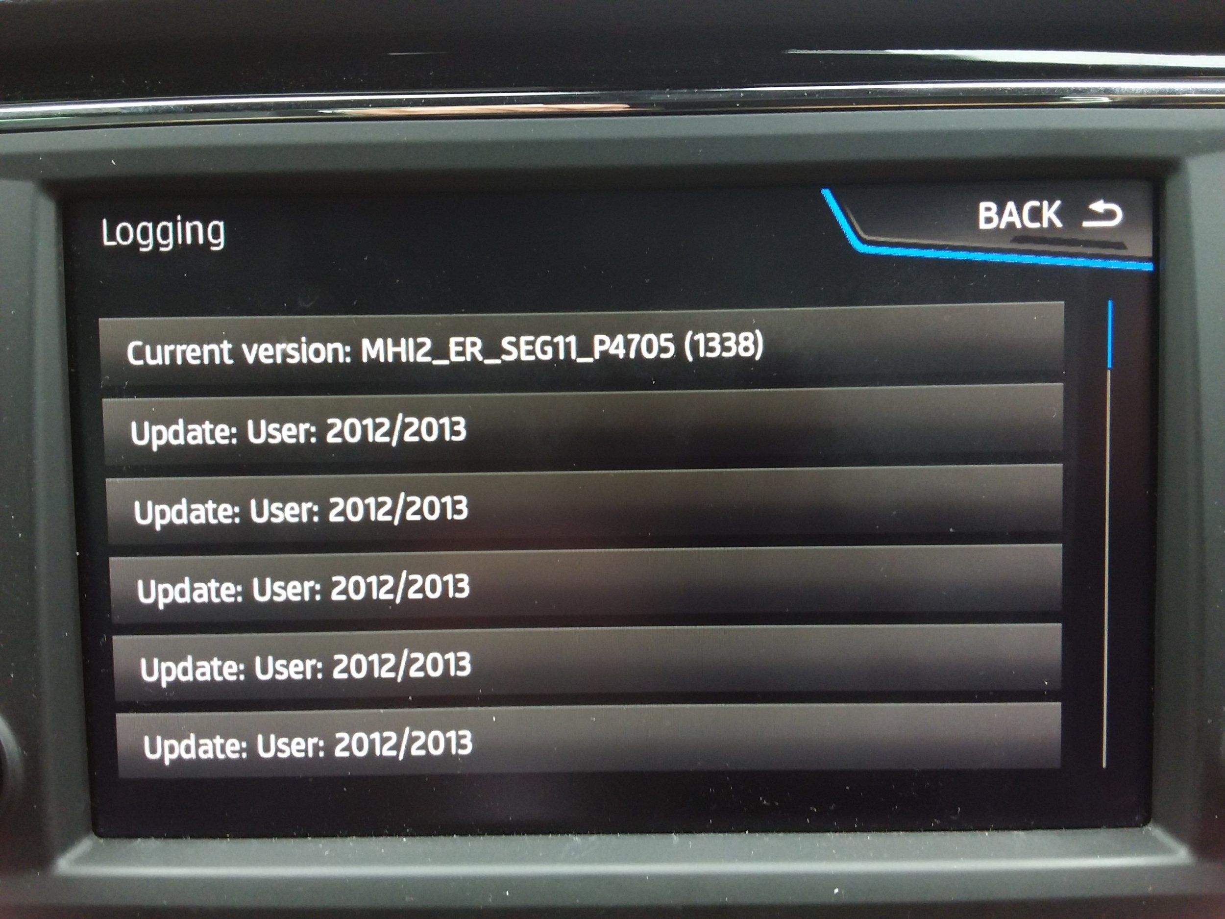

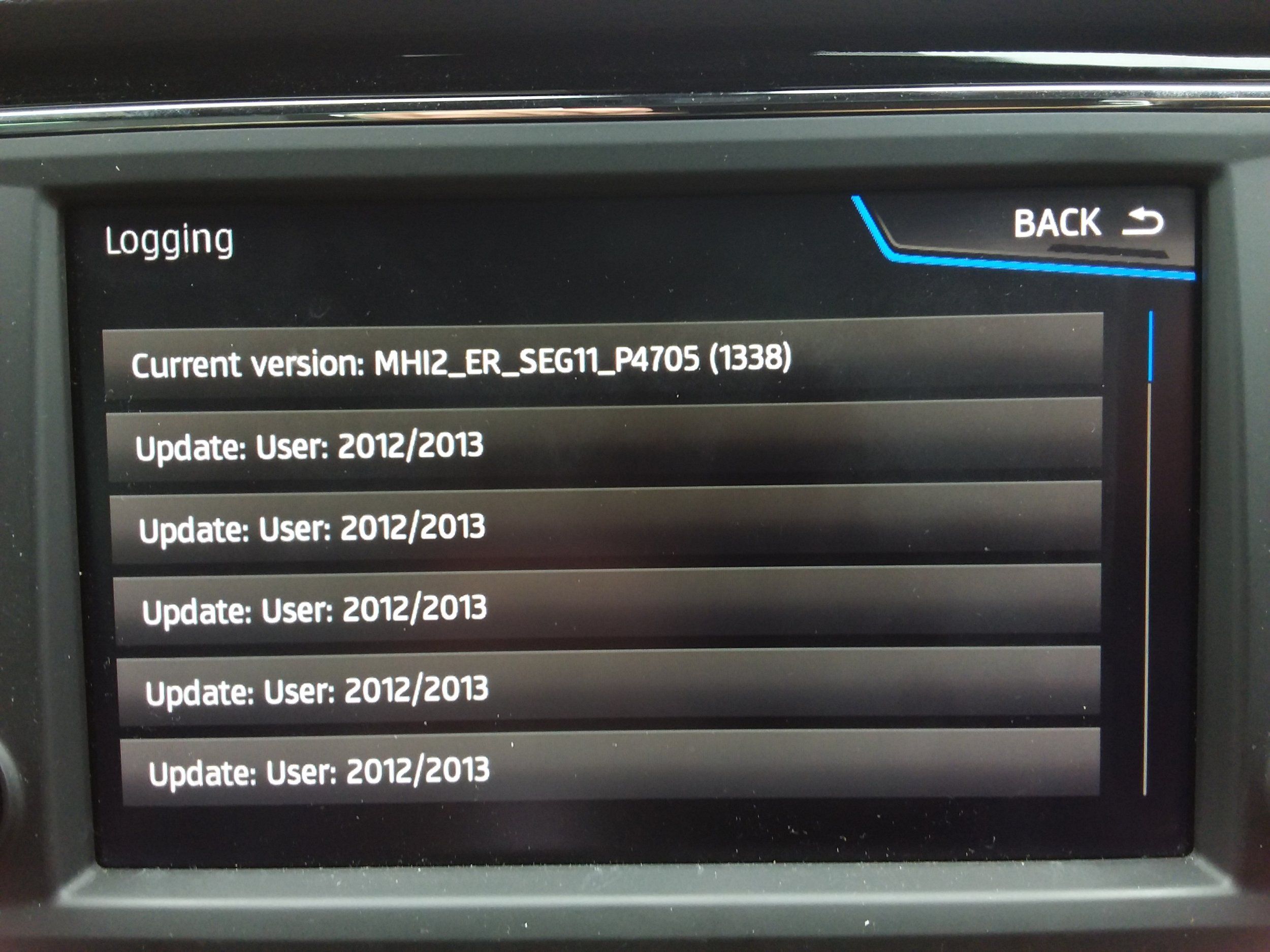

On 1338. I see OBDEleven people are on 1447 now shown as the latest... they hadn't till recently shown that one. Probably said software.

Strange that you have user updates from 2012/2013?
Ah well I thought everybody would know what they are so didn't say ?. They are the Poinspector imports. Get one each time I import user POIs.

Updating to latest FW 1447 is easy and safe.
Just grab your copy on mibsolution.eu
Afterwards, you can easily patch your unit with M.I.B.
Just a SD card needed.
And update to latest maps.
Feel free to open a new thread on 1447 FW Update I‘m happy to support this for you and all the others.

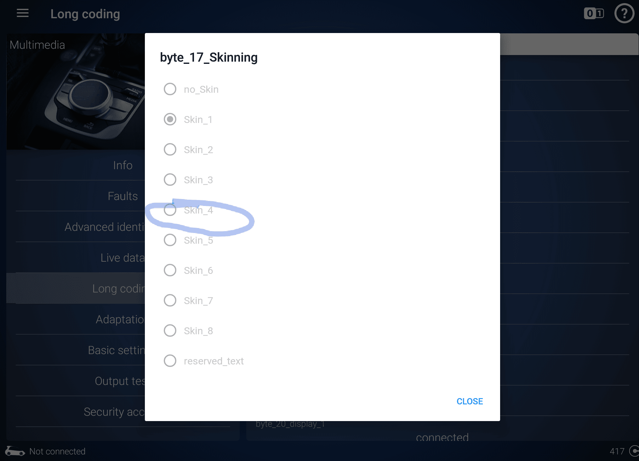

It seems a common issue is fixing the Seat screen once the software is loaded. @Chillout did make a passing mention to that I believe. That appears on the German board. So obviously a good idea to find that (again).
I think with that lined up when you can't read the screen that should bring it back.

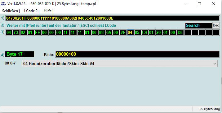

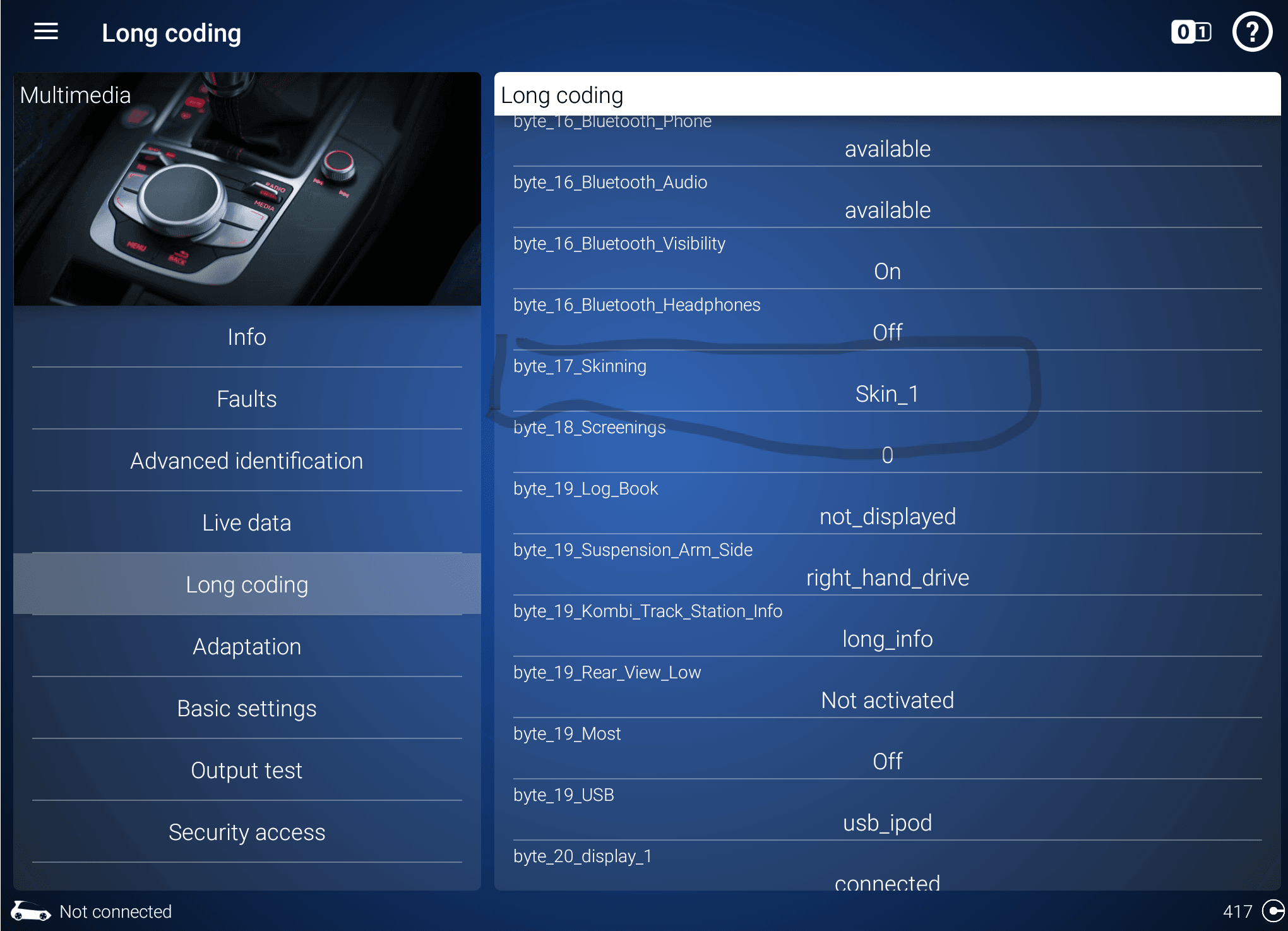

Regarding the skin issue after update (unit does not boot), just change skin with VCP/VCDS/OBD11 and unit will boot through normally.
Change Byte 17 to Skin 4 (only this one is working!)

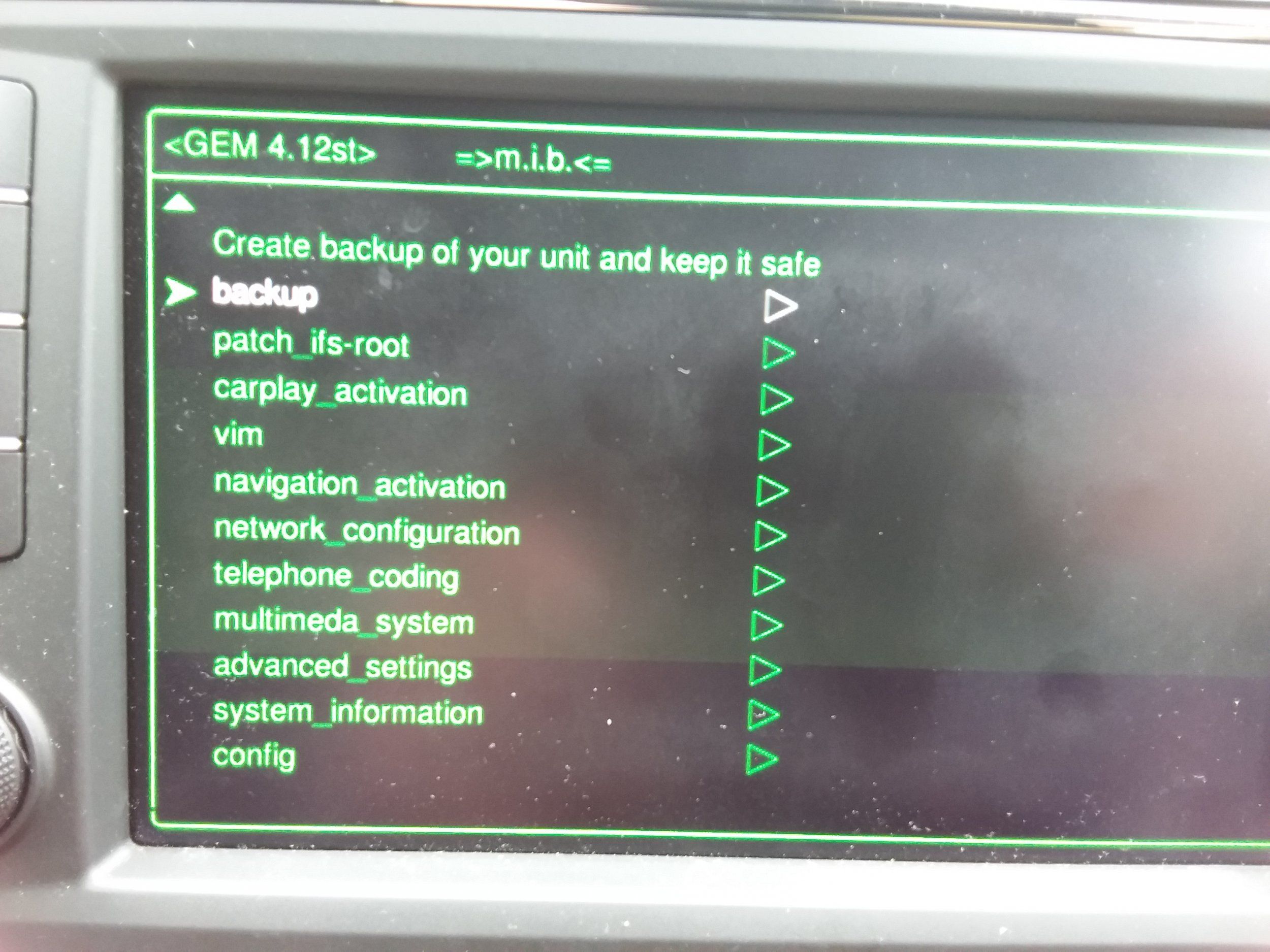

M.I.B
Download (always latest version):
M.I.B is NOT just patching:
  • Running from SD card only (NO"D-Link"/PC/Putty required)
    • during installation of M.I.B the list of supported USB devices is expanded. Cheap 5-10 GBP "D-Link" alternatives can be used afterwards.

1. Fix screen first before processing for 1447
From DEB 1447 forum: "It has already been observed twice that a unit gets stuck in the boot screen immediately after the firmware update.
If this happens to you via VCDS / VCP / OBD11: change byte 17 to skin 04 (carbon skin) and restart the system."
Pre-empt, change long string of 5F module to Byte 17 to Skin 4, save and long reboot VCDS or OBDEleven (check)
VCDS method
OBDEleven Method:

Extract all files of the M.I.B. to the root directory of a clean SD-Card (FAT32 formatted is requirement!!!)
NEW - GEM Method: use GEM
Insert the SD card into slot SD1 of your MHI2 unit.
Enter Engineering/Red Menu to start SW Update. Select UPDATE, select SD card, select "M.I.B. Launcher V1.0", START update.
Installtion of M.I.B. on your Unit will start. The unit will restart three time until update process is finished.
GEM will be activated as part of the installation.
SVM error has to be cleared via M.I.B. function in GEM after installation
Enter GEM on your unit and have FUN!
Select ==>>M.I.B.-More_Incredible_Bash<<==
See README.TXT file on the download for presentation on the SD
User video here of (similar ?) installation... stops before clearing the SVM but shows installation:
6. Backup current firmware
At this point a branch exists as to whether you really want to update the firmware or continue with your existing firmware. A screen is returned from MIB Tool if the current firmware is not in the patch database on the SD card. The patches are held in the patch directory. You are invited to submit the backup you have made to the M.I.B. team if the firmware does not exist for patches in the patch directory (e.g. not seen before).
In this instance at this time the software 1338 was unknown to the team. Check log file for errors as it tells you.
Goto option 2 below if you are not changing the firmware release.

Patches already exist for 1219, 1338, 1376, 1409 and 1447 (as of 24/06/2021). An existing patch matching the SW needs to be flashed. If a dummy patch is supplied by the team as a fix, go to addfec button direct in this menu.
The additional FeCs are populated from within the txt file in the patch. The 08300008 life long FeC code should be in that already. See FeC list attached.
Enter patch_ifs-root option and hit Add new Fecs to FecContainer.fec. After reboot the unit, long press on / off button (20 second or so) to get a reboot so they take effect and check installed FeCs. The add FeC is shown below.
If the backup is recognized, the firmware hit flash patch image.
In both sub options check the Skoda FeC has been added. Reboot then hold for couple of seconds the menu button to find installed FeC list and check. Correctly enable navigation should find a selected route for more than 30 seconds without telling you the navigation database is not valid. If the wrong navigation FeC is being used on an installed map this error occurs. If OK can now update maps.
