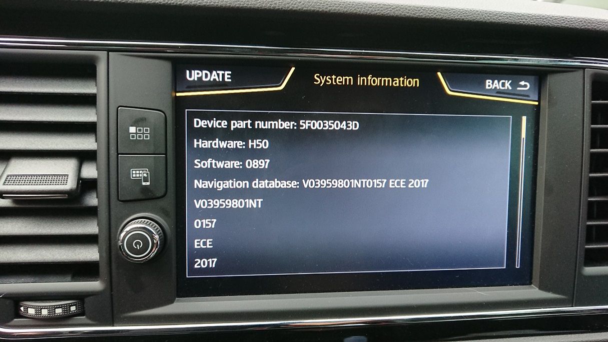

Hi guys, I just bought a used Seat Leon ST, and all i can say is the infotainment system seems pretty good! at least to my ears :cool:
It also has nav system and full link, however I was wondering if I could update the firmware to a more recent one (the car has more than 4 years).
I have seen some users updating it to 330 first and then to 369, however i cannot find the software package anywhere, can please someone help me?
Part No 5QA035846
Software 0245
HMI software H25.14.78_STD2Nav_EU
I am also looking to update the maps, however I still do not know if I have just to download them from the SEAT site and load them to an SD card.... it seems to good to be true.
Thanks if anyone can help out!

Let someone else answer your firmware question. On the maps you have standard navigation system. You must not follow the Seat map update site that's for if you have valid Mapcare which was never sold in the UK. However one guy on the navigation thread back in 2017 developed the "workaround" which side steps Mapcare. See the resource link I wrote
1520 is the current release. I give the link to that but I believe that the Seat Navigation site has that one on it but whether it's Skoda, VW or Seat all the same identical release so you go to the one that is the fastest, generally VW.
The important thing is not to delete your existing overall.nds file on the card, you will need that just to replace the one on the download. Retrofitters sell a £20 mod now that avoids copying that file out but you can save £20. Use the map card that came with the car and follow the link. How to make good accidentally deleting that file is also covered on the link. It was found going back in time was the universal fix to all screw ups with loosing the matching overall.nds file the car is paired to.

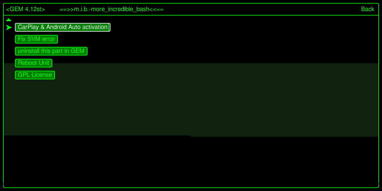

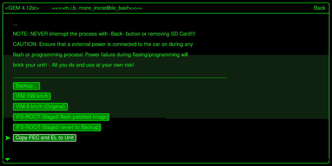

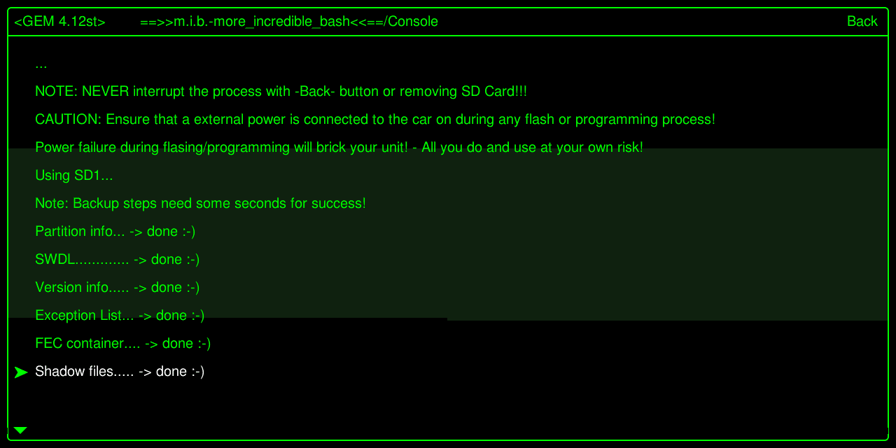

M.I.B. update!
Can now be run completely from SD card, no D-Link needed anymore for MHI2 units.
View attachment 22281View attachment 22282
NOTE:
M.I.B. is running on Harman MHI2(Q) units (MIB 2.x) only.
CAUTION:
Ensure that a external power is connected to the car during any flash or programming process!
It is not recommended to flash with running engine!
Power failure during flasing/programming will brick your unit.
All you do and use at your own risk!
Prepare SD card:
Extract all files of the M.I.B. to the root directory of a clean SD-Card (FAT32/NTFS formatted)
Patched IFS-stage2 images have to be placed on the SD card in the folder /patches
Pre-patched (CP, FEC and EL) ifs-root-stage2 images can be found for all recent MHI2 FW versions here: https://bit.ly/3nPIHl8
You only have to copy the folder(s) you need for your car(s) - e.g. /patches/MHI2_ER_SKG13_P4526_MU1440_PATCH
They are already prepared in the right way, so that the tool can use them right away
In case you want to use your own patches (not recommended) - ask us first to help you:
For each SW-train a seperate folder is needed e.g. /patches/MHI2_ER_SKG13_P4526_MU1440_PATCH
The folder has to contain the patched ifs-root-stage2 image with the following naming syntax:
"MU-version"-ifs-root-part2-"image start address in hex within RCC"-"image length in hex" --> e.g. MU1440-ifs-part2-0x00ba0000-1C06F300.ifs
image length is on byte 0x20 position 04-07 in little Endian of the original ifs-root-stage2 image (e.g. fresh from FW update)
NEW - GEM Method: use GEM
Insert the SD card into slot SD1 of your MHI2 unit.
Go to SW Update, select UPDATE, select SD card, select "M.I.B. Launcher V1.0", START update.
Installtion of M.I.B. on your Unit will start. The unit will restart three time until update process is finished.
GEM will be activated as part of the installation.
SVM error has to be cleared via M.I.B. function in GEM after installation
Enter GEM on your unit and have FUN!
Select ==>>M.I.B.-More_Incredible_Bash
