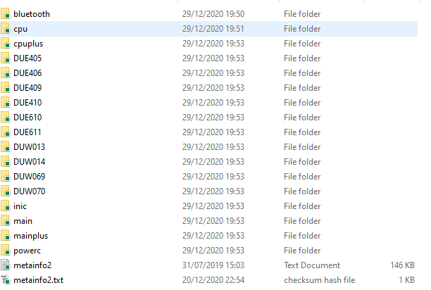

Sorry if this is already made clear in the earlier post(s) but I have read so many now :).
I am also updating from 0462 to 0479 on my 17 plate Leon. I have located the file in the MEGA link and unzipped and put onto a SD card. is this the only file I need and then just follow the update process once I put it in the car?. Thanks in Advance.
Carl Levoir
Jan 2, 2019
76
25
Once you unzip the files, they will be in a single folder. You need to copy all files from the single folder into the root directory of the SD card
So by searching your SD you should have the following folders:-
