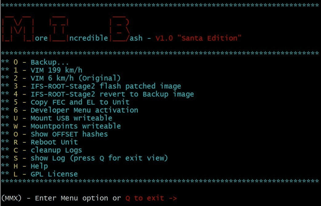

You should see (a more colourful) menu with the following content:
Code:
__  __     ___           ___
|  \/  |   |_ _|         | _ )
| |\/| |    | |          | _ \
|_|  |_|ore|___|ncredible|___/ash - V1.11 "Santa Edition"
**    0 - Backup
        Runs a full backup (RCC, MM, EEPROM, ...) of your unit and places it into the folder /backup/"your hardware ID"
**    1 - VIM patch (199 km/h)
        Writes custom Video In Motion (VIM) speed of 199 km/h (yes, too slow for German Autobahn) to your unit
        Unit will automatically restart to save changes permanently
**    2 - VIM Original (6 km/h)
        Writes factory default Video In Motion (VIM) speed to unit
**    3 - IFS-ROOT-Stage2 flash patched image
        Will create a backup if it was not already created before
        applies patched IFS Stage 2 image - containing patched MIBRoot - to the unit
**    4 - IFS-ROOT-Stage2 revert to Backup image
        Applies original IFS Stage 2 image - containing original/stock MIBRoot - from your system backup to the unit
**    5 - Copy FEC and EL List to Unit
        Copies ExceptionList.txt and/or FecContainer.fec placed within
        e.g. /patches/MHI2_ER_SKG13_P4526_MU1440_PATCH to the unit
        if no FEC and/or EL is inside /patch directory, files from /backup folder will be used
**    6 - Developer Menu activation
        Developer Menu will be enabled - no need for VCP/VCDS or OBD11 ;)
**    7 - Ambient Light Buttons Original
        When you see this, first take a look on https://www.glaskugelservice.de/codierung/ambientbeleuchtung
        it is some special coding only for Skoda Octavia 5E, yet!
**    8 - Ambient Light Buttons patch (first, set to Original)
**    U - Mount USB writeable
        makes USB devices writeable
**    W - Mountpoints writeable
        make some Mounts writeable on the unit
**    O - Show OFFSET hashes
        some Unit and flash informations, e.g. RCC Image address or image length
**    R - Reboot Unit
        restart the Unit
**    C - cleanup Logs
        delete all inside /log directory
**    S - show Log (press Q for exit view)
        show all our Logs from this Unit
**    H - Help
        this here...
**    L - GPL License
        please take a look and note our license

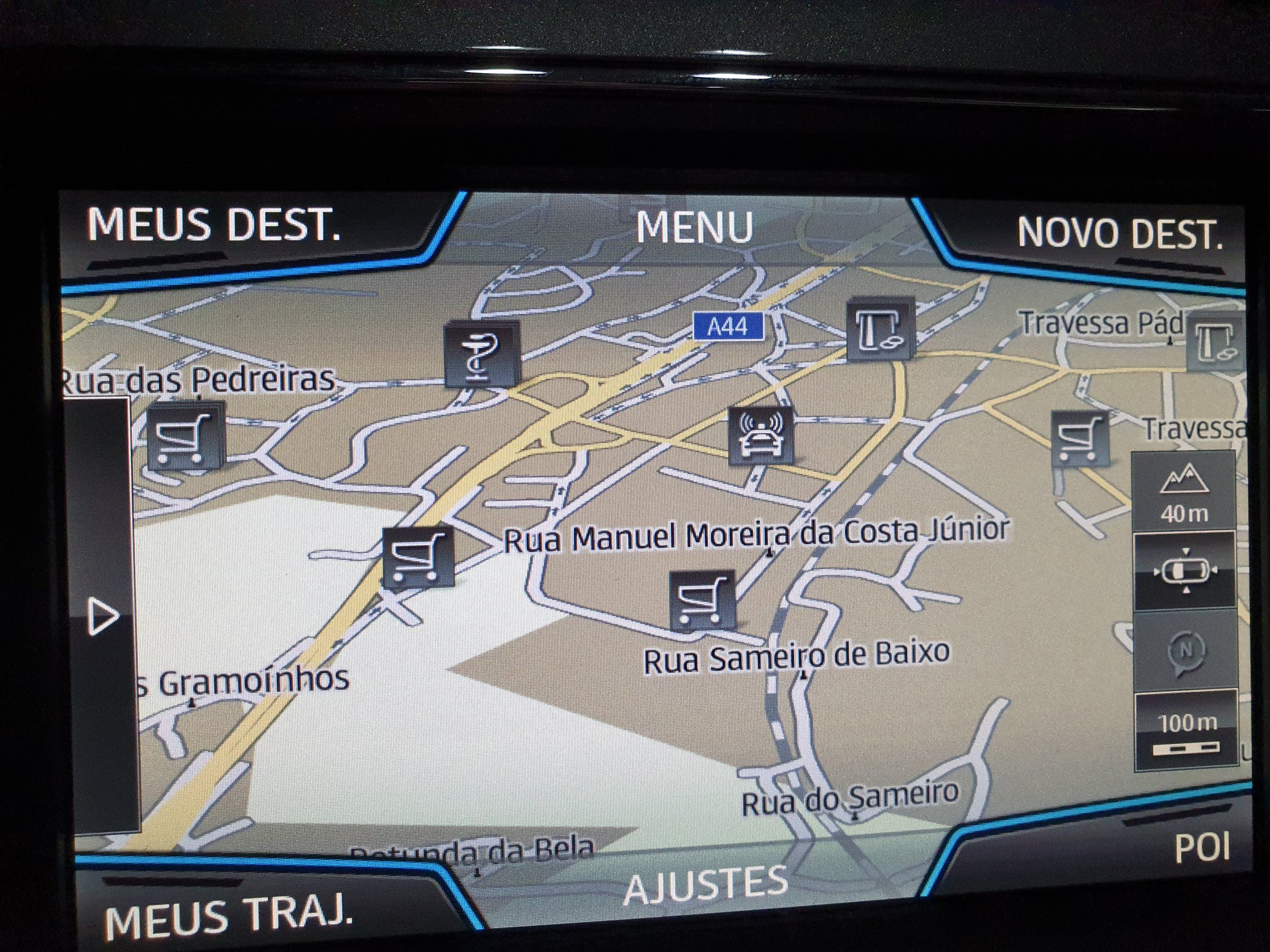

Well got news about this. I reverted back to 252 from 346 successfully and easily. Dunno if it was luck or not but everything is working properly.
My radio stations are finally working properly. Only thing I miss is the way the sat nav worked on version 3.
Reactions: Tell
That's good news!
Did you download 0252 from one of the MEGA links above?
What differences are there with the SatNav?
Ah well the retrofitter sharks that you see swimming in the waters got it wrong :sneaky: . They would be arguing that the releases were incremental going forwards.
Does that mean that sat nav doesn't work completely or the screens are different. Former would be the FeCs... may be that's the thing that becomes out of step if you go backwards the license doesn't downgrade. That's the danger of these software libraries without the guidance you are on a one way trip then the retrofitter picks up work. Others will be clear about we can sell you the upgrade which you can to yourself plus have clear web pages for that on their site. Seen those.
Give me a few days and ill post the images of the system. And how i reverted back. I used the files from mega.

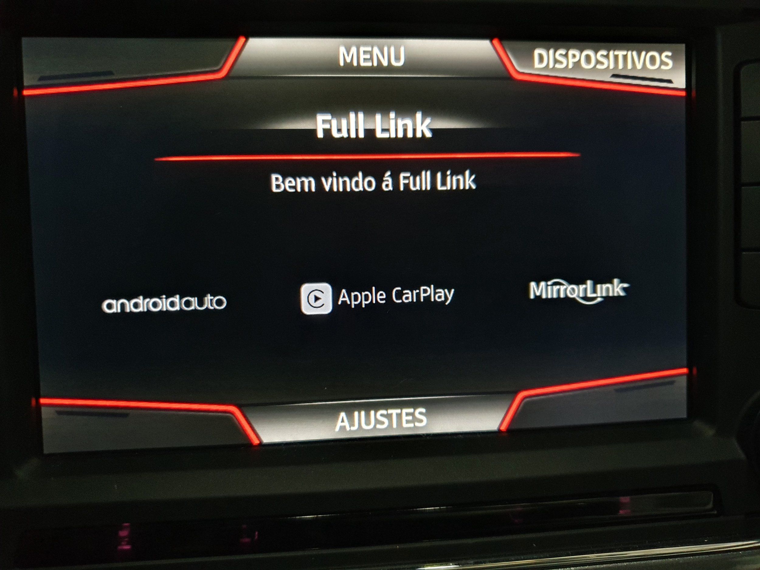

Everything is working as supposed. The version 2 on nav you have to type the country then district then address... on version 3 you would start typing the address and it would give you the matches. Thats what i miss.
I have no troubles with nav no troubles with stations no troubles with full link nor dab. All working 100%.

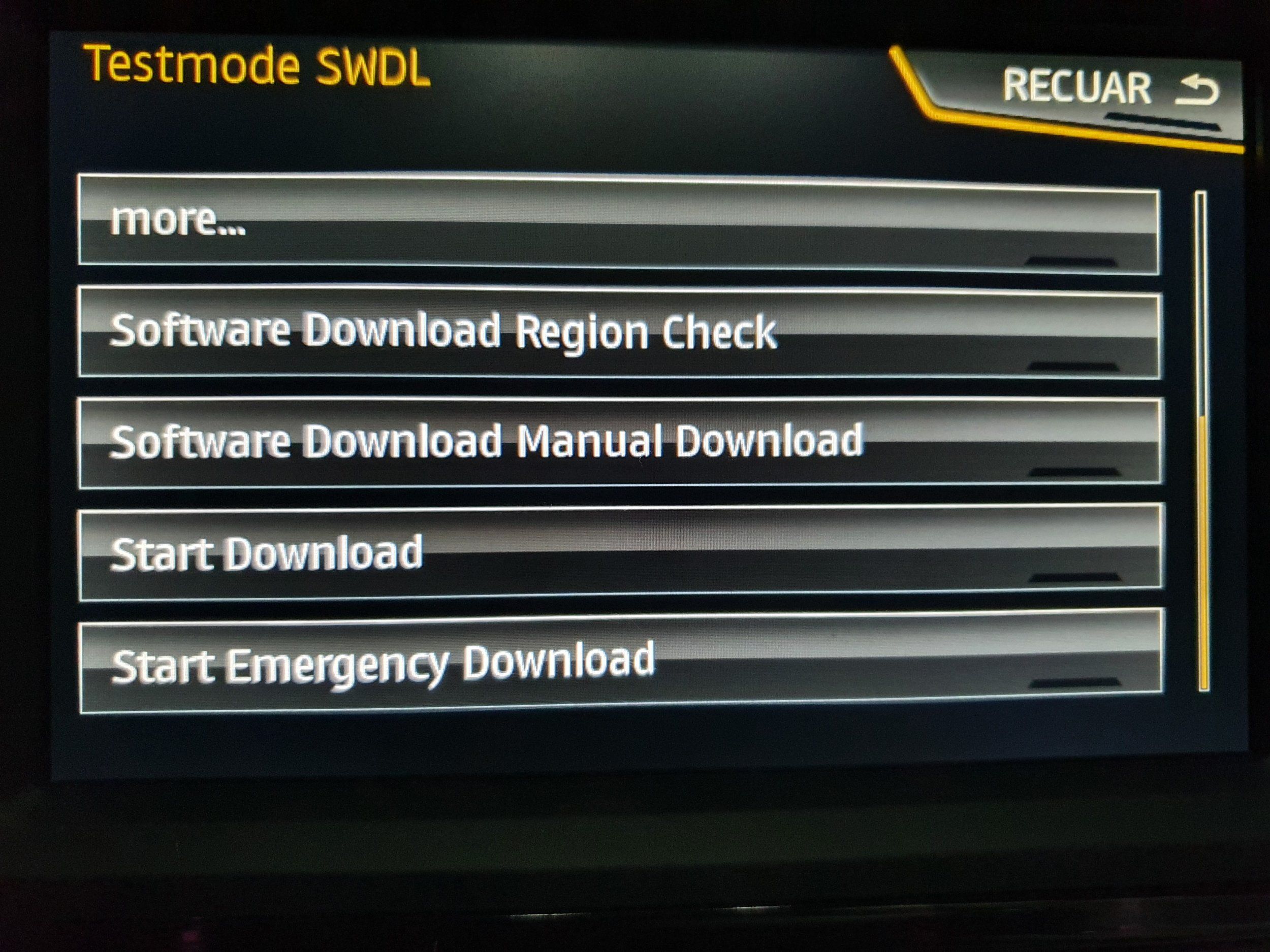

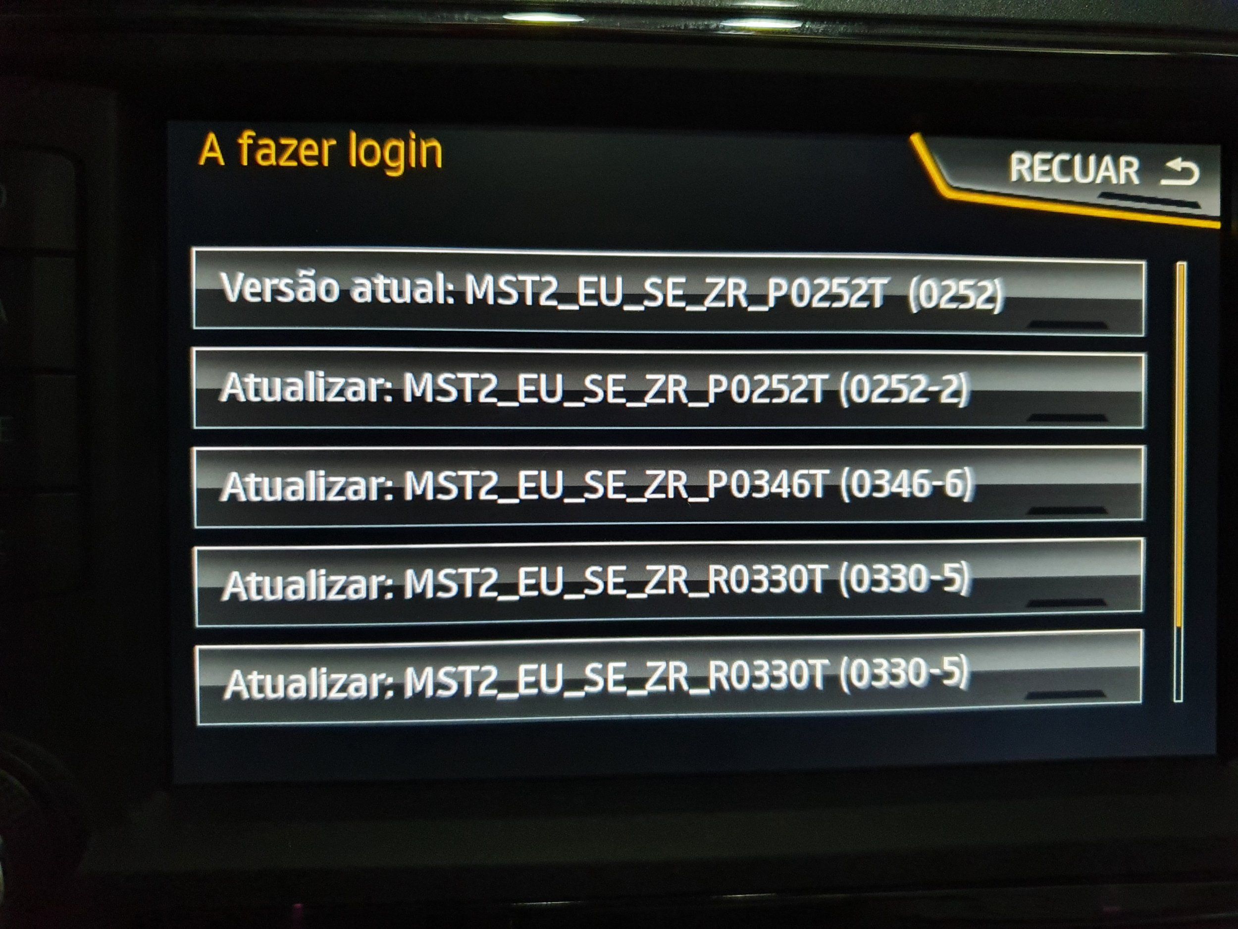

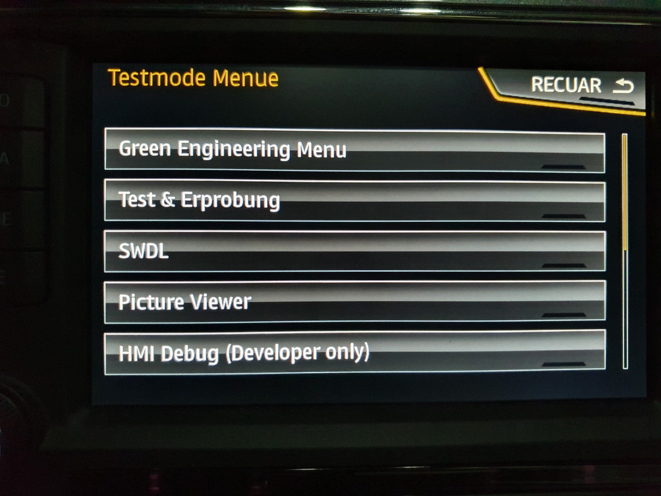

So here i leave the process i did to update/revert the firmware. Before throwing disbelief comments i leave the updates history of my unit.
The upper version is the actual version.
So walkthrough:
1. Download firmware version. (Used Mega)
2. Format sd card and move files there.
3. Press menu until you enter extended service menu. Don't remember if this option is available by default or if I made it available with obdeleven on the first upgrade.
4. Pressed SWDL
5. Press start download. Select sd card. Select all and start update.
Wait for a few minutes 15-30 minutes to complete process.
At the end everything working.
This is my testimony don't want to say that this will work for everyone, but for me it worked perfectly.
Regards.

On 3. They are shipped with the engineering menu level 2 turned off on mib2s. Mib1 it was on. Yes as you said you thought you turned it on via Obdeleven (You did). Long press on the menu button reveals the second menu with the SWDL command which you then used to trigger the software change. Same long press you use on retrofit highs to do the map updates via the SWDL command but you can only do that on high units where the navigation FEC covers the map update period... said that just in case anyone does that on a mib2 high and wonders why they are locked out of navigation. Was the path I took originally to enable the SWDL menu.
Good you got it all working going backwards.
Is the SWDL command used because the software was being downgraded? If I was upgrading, I assume you just hold "Menu", press “software versions/updates”, press “Update”, press “SD”, select the software version It presents and then press "Start".
I believe that is the case. Probably why people say it can't be done because that menu isn't offered but only in the backend which needs enabling to access and that in a high unit takes a weird amount of time to be first enables.

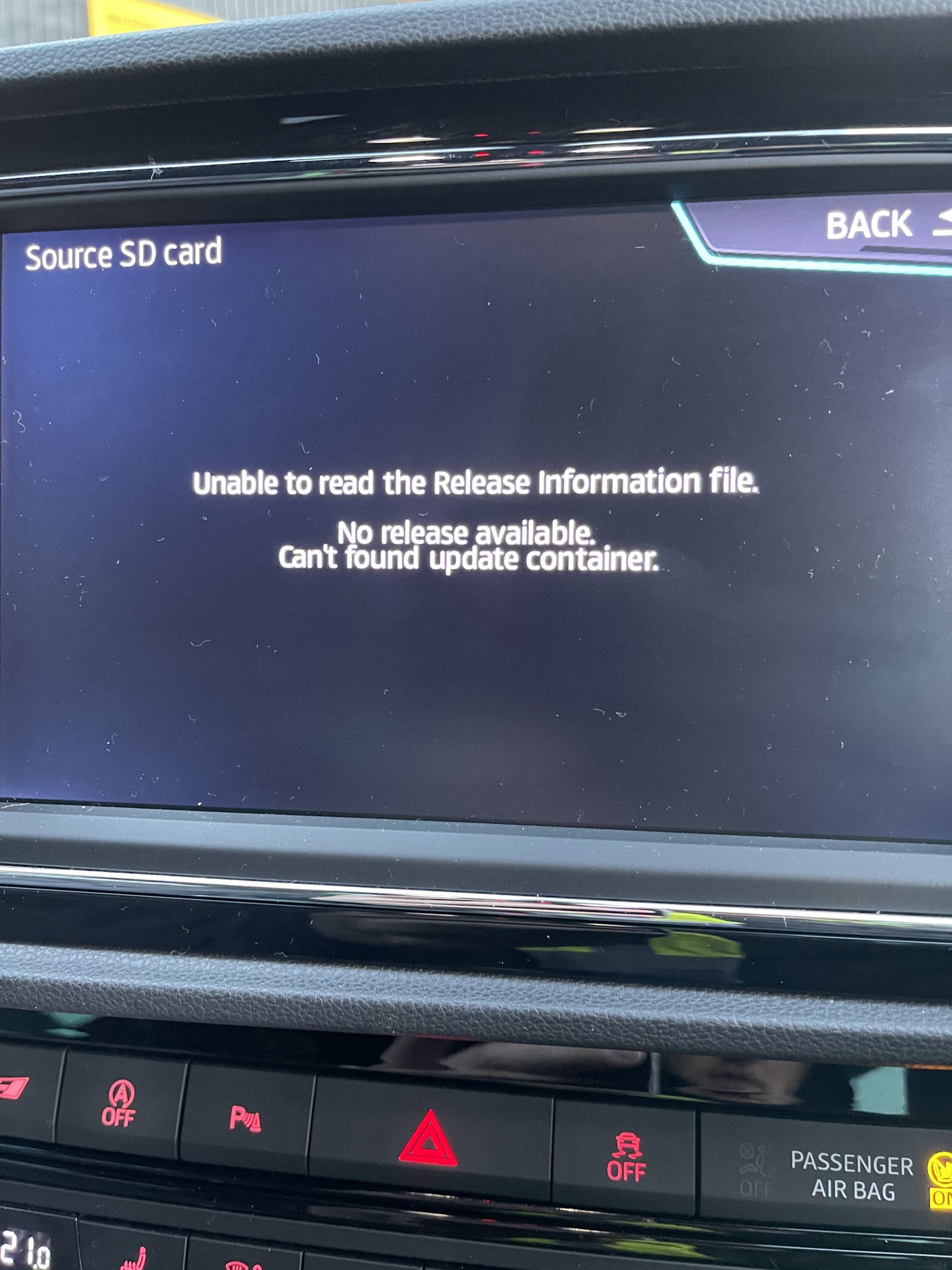

Trying to upgrade from 514 to 515 but keep getting this error,
anyone know how to sort?
I used SDcard no 1, with card formatted to FAT32 and default cluster size.
Enter update menu by holding down (long press) menu button on infotainment system to bring up update menu, then click update and start.
worked fine

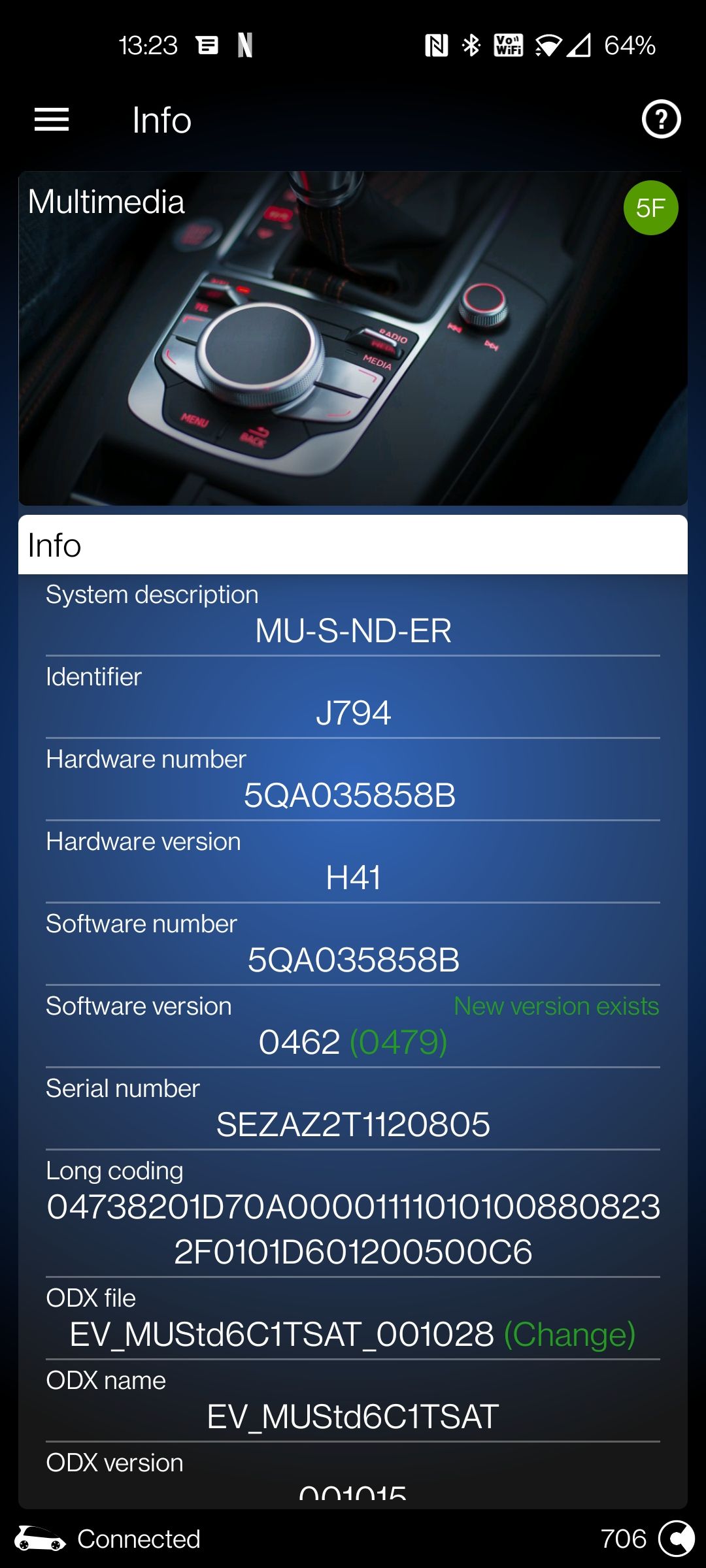

I hope someone can clarify something for me regarding a firmware update on my 2017 Leon.
It's Hardware version H41 and It's currently running the original firmware 0462.
I see in the Mega files posted recently there's version 0479 which OBD11 says is the latest version for my car.
The question I have is can I just install 0479 or do I need to do 0469 and 0475 first?
I don't want to corrupt anything so hopefully someone here will know what it is I should be doing. Thanks.
I have just updated from 0462 to 0479 and it did it in one operation, haven't seen much difference though!
Its scary watching the unit update, and praying that it will work OK afterwards, I lost all DAB radio icons which I had to add again
