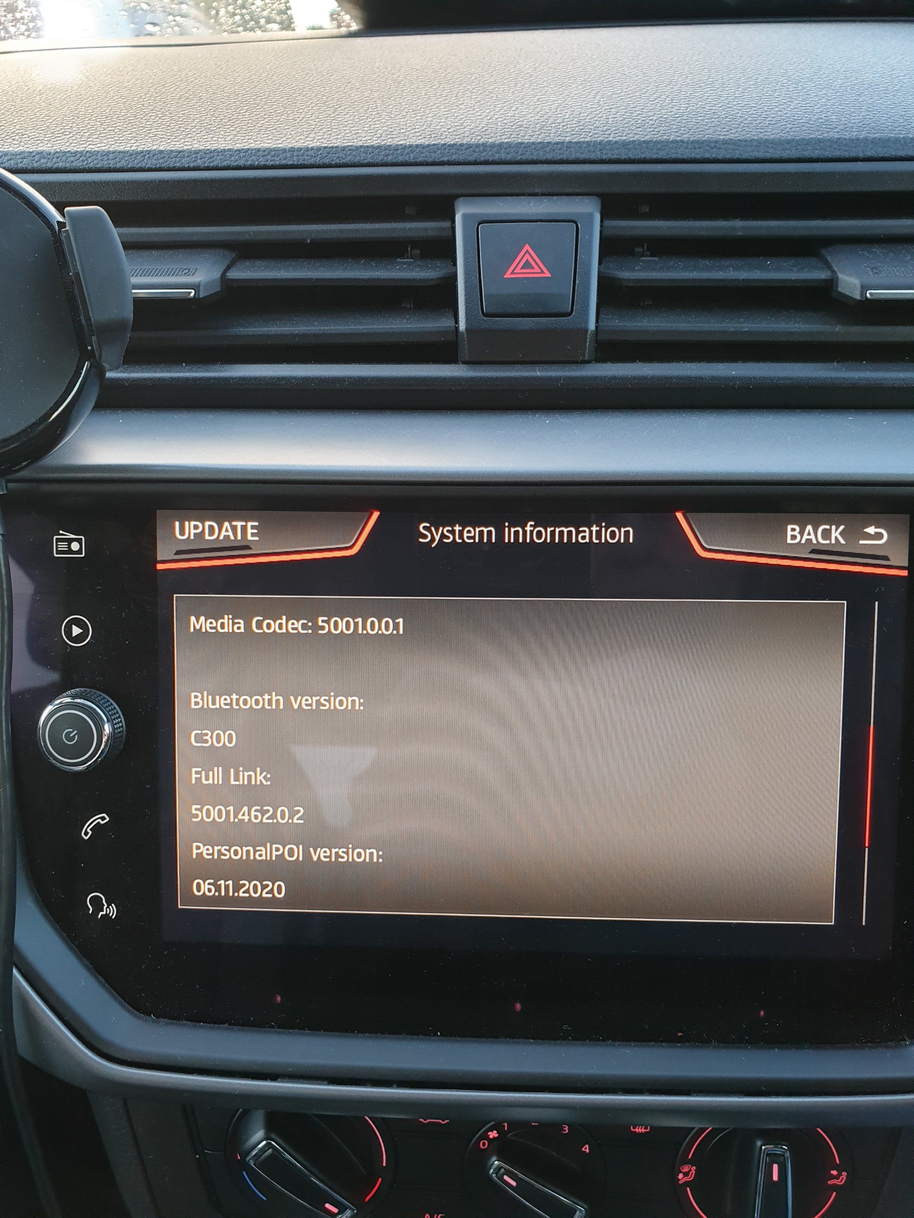

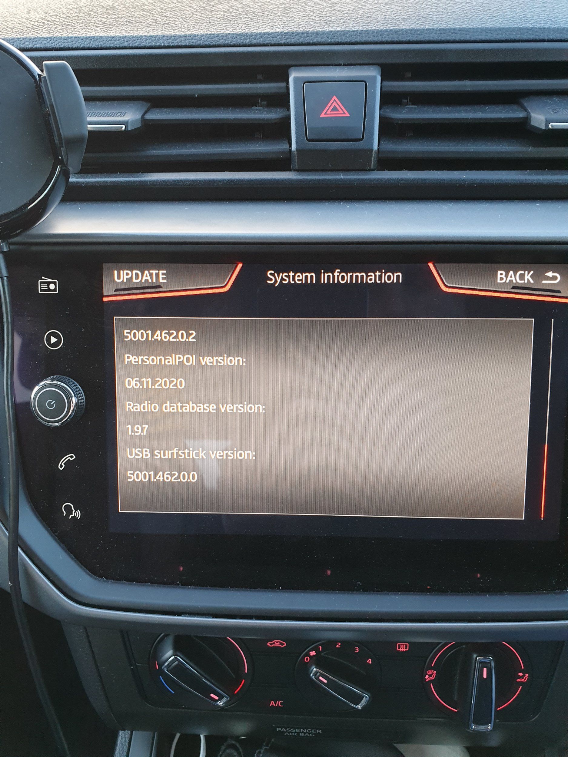

I have the following info on the display screen:
Device P/N: 5F0035846C
Hardware: H50
Software: 0512
Installed SW Train version:MST2_EU_SE_ZR_P0512T
Hardware: H50
Software: 0512
Looks like your 0512 can go to 0515. See https://eastyorkshireretrofits.co.uk/collections/seat-leon-mk3/products/mib2-software-updates-seat. You can pay £20 to download from this reliable source, or look on the link on post #709. I've downloaded one from the post for mine, but I'm slightly reluctant as I've never heard of this guy or know how safe/reliable the files are.
Your Navigation software is one behind as well. 1520 is out now!
Reactions: Steven Rowan
