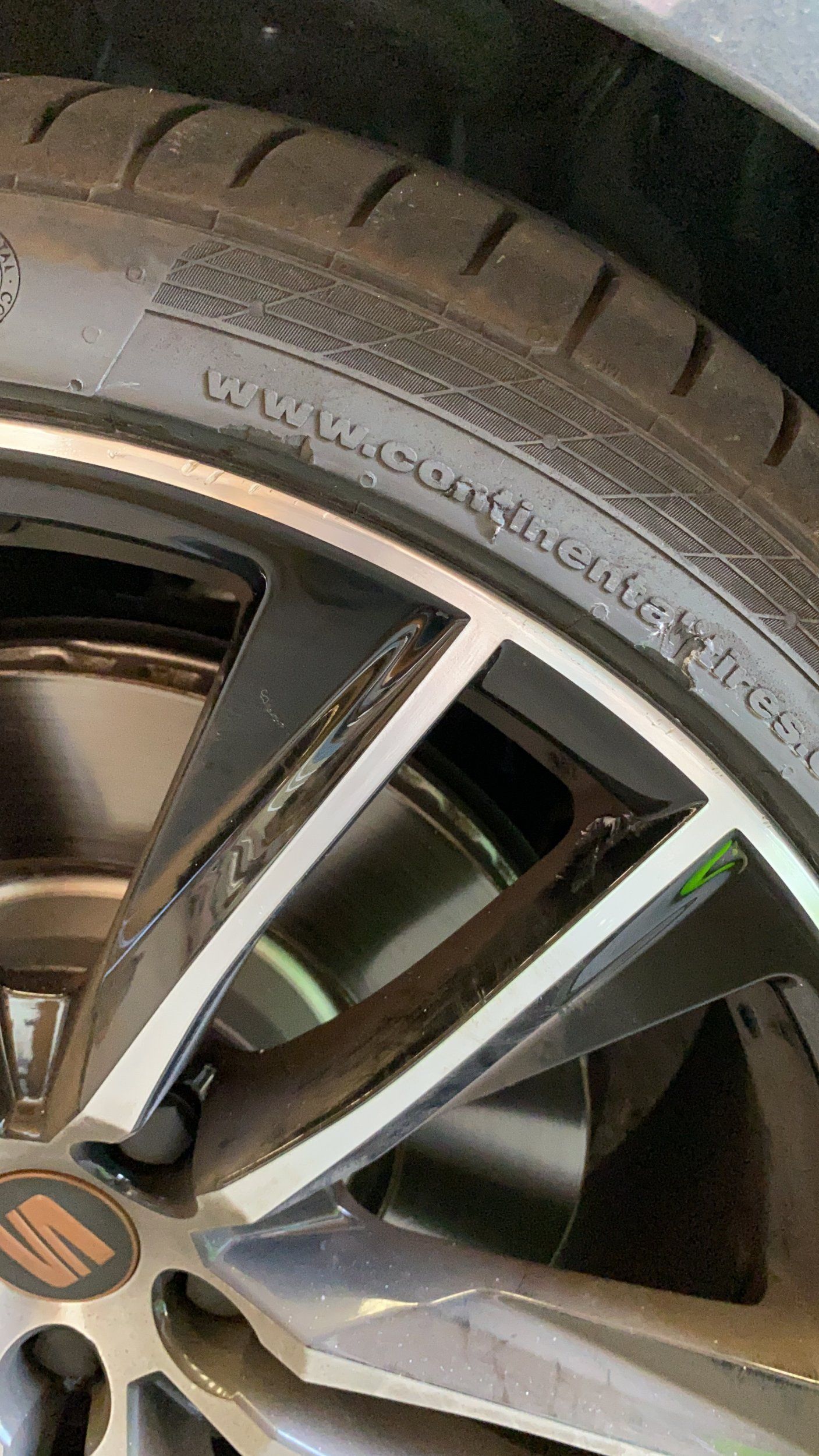

Unfortunately managed to scuff my rear left wheel yesterday.
Not bothered enough to replace the whole wheel but wondering what my options are? It looks like it's taken off some kind of coating layer and I'm wondering if it can be repaired easily? Other than that I guess I'd just want to make it less noticeable, any ideas?
For reference they are these wheels.
Thanks.

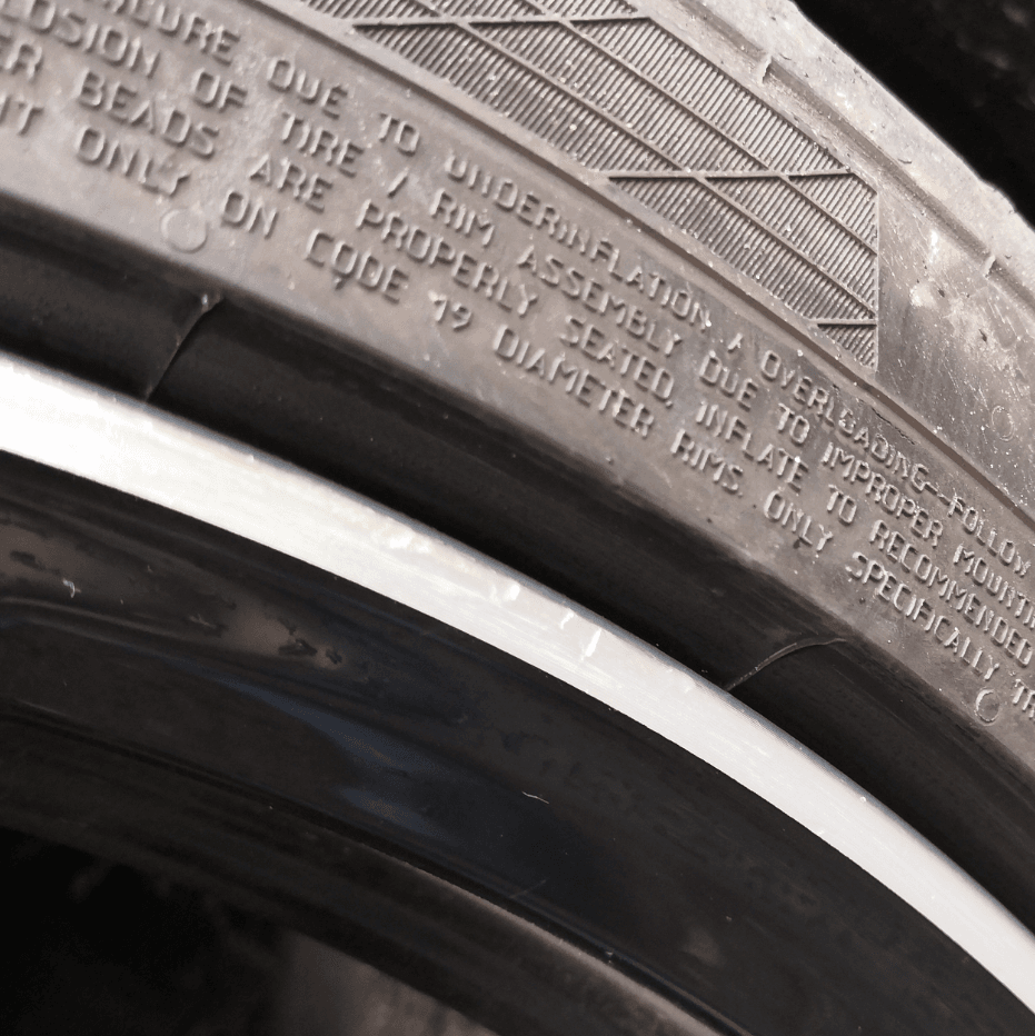

This happened to me the other week, I did a DIY fix.
Start with 400 grit sand paper, move up to 600 and then wet sand with 1200 & 2000. Polish and then lacquer, jobs a goodun!

Nice job Sochaux.?
Did a similar repair on mine a few months back. My results weren’t perfect but unless you really study the alloy you can’t see it. ?
Can only see the repair in a certain light it’s very slightly a darker shade.
I did spray the lacquer on after masking the area off. Got a better finish. Found that when applying the lacquer with a touch up brush, I could see the brush marks?

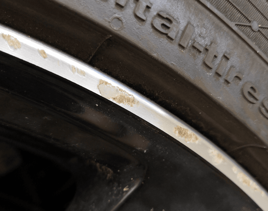

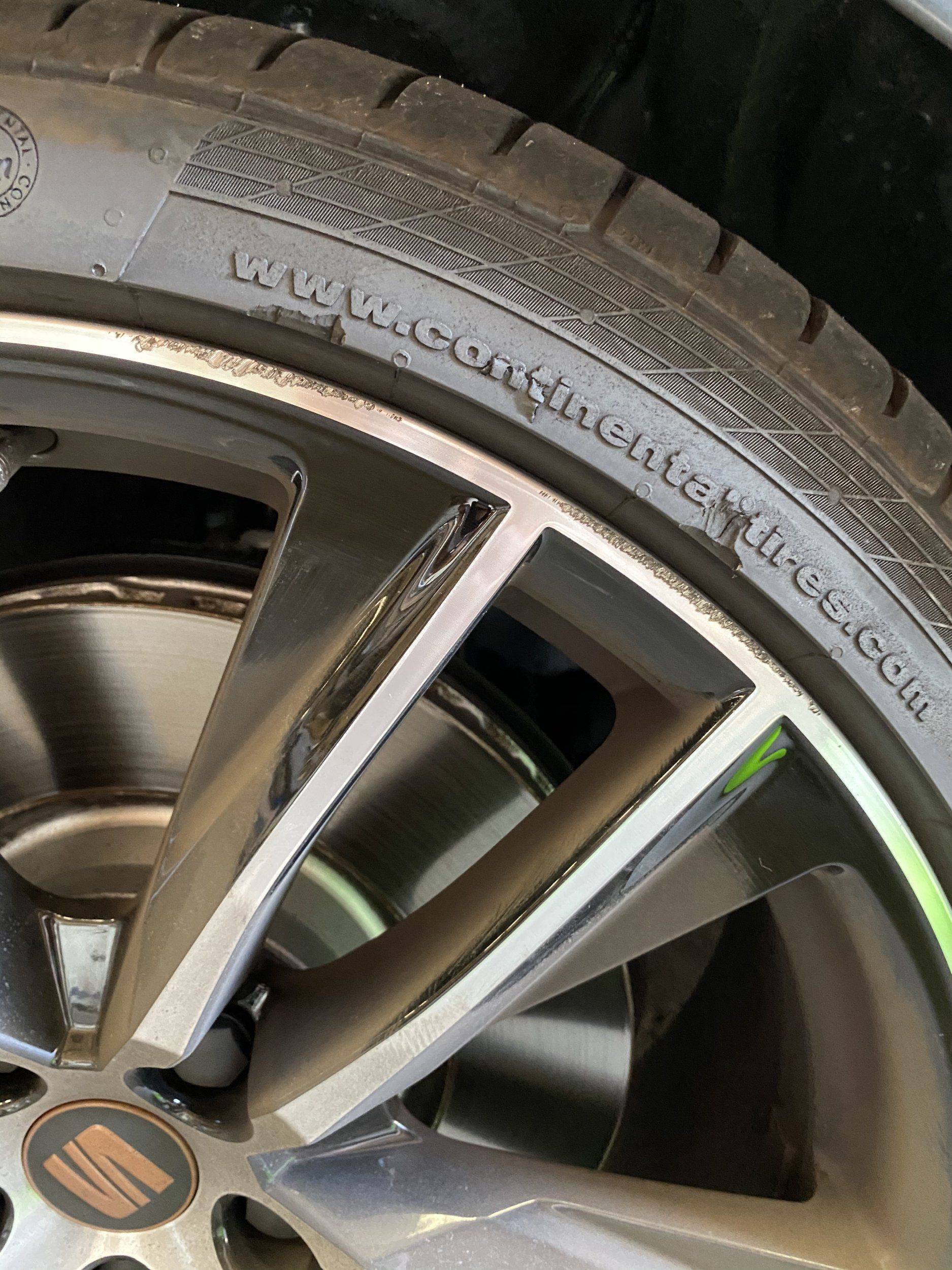

Sanded down until the dirt was gone and then lacquered. Still visible if you're looking for it but much less noticeable overall so reasonably happy.
Same part as first post:
Where the damage was a bit deeper:
Thanks for the advice all.
