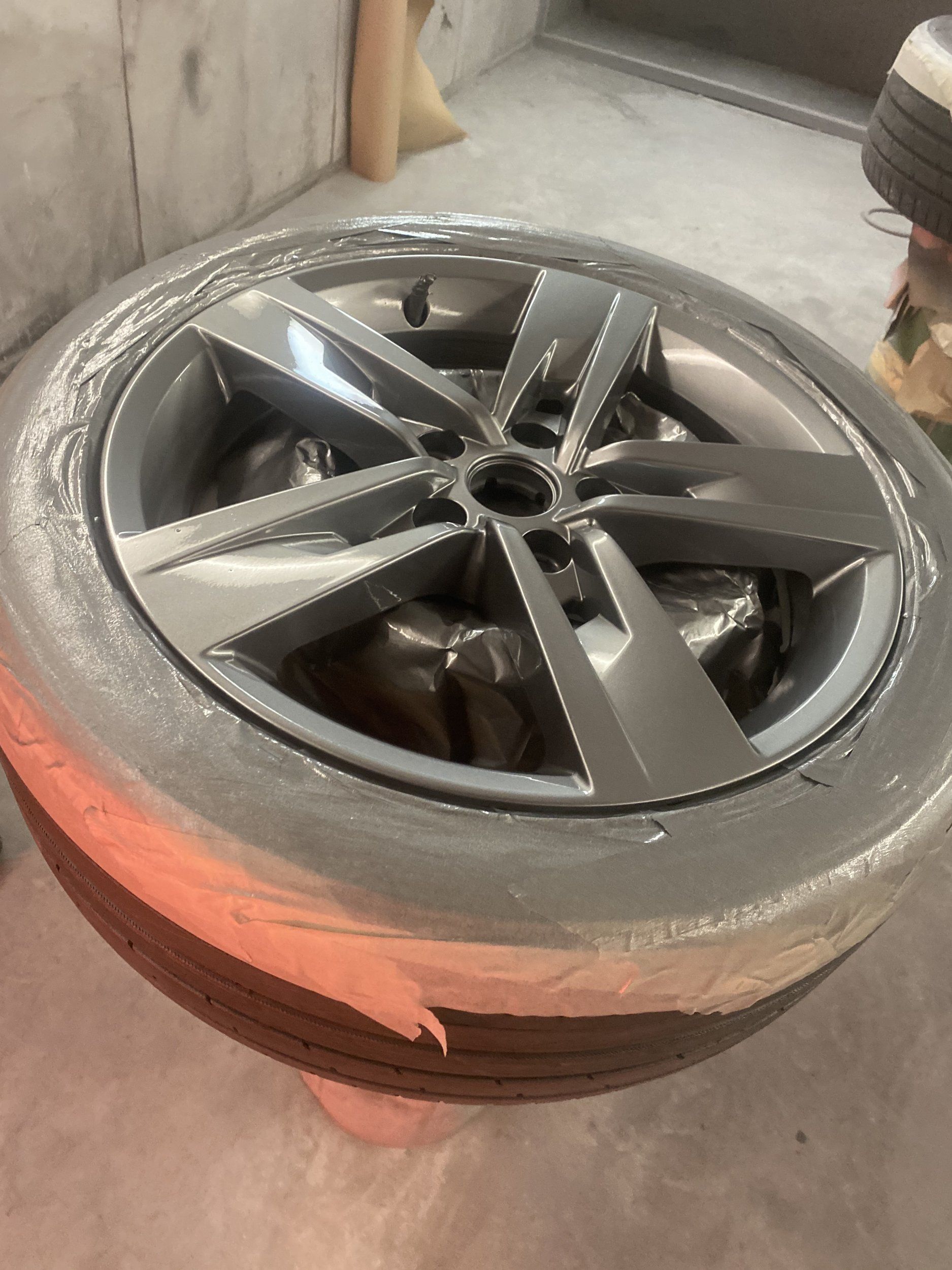

Decided to have them repainted before getting the new tyres got done for £250
Colour looks really good...
But I'm paying a similar price to you for the tyres/valves/weights to be removed, chemical strip, then powder coat on 19" alloys.
Sorry to be the bearer of bad news again, but would have had the tyres replaced at the same time, so the soft, fresh paint isn't damaged when the old balance weights are removed when new tyres are fitted.

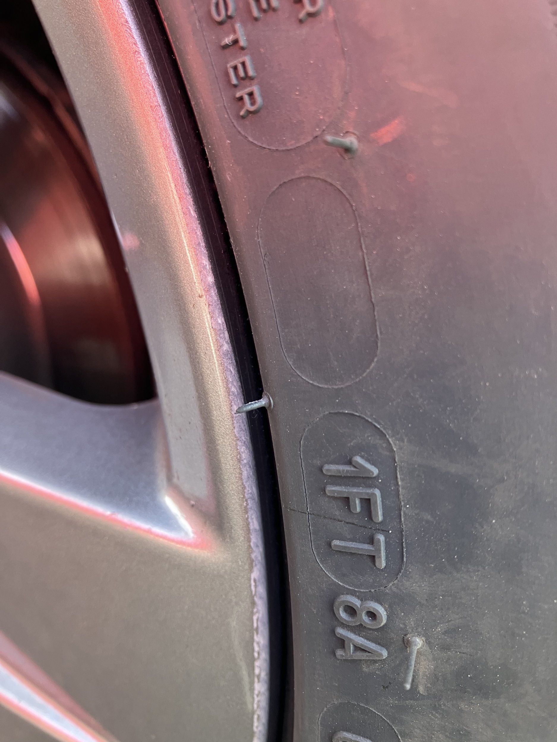

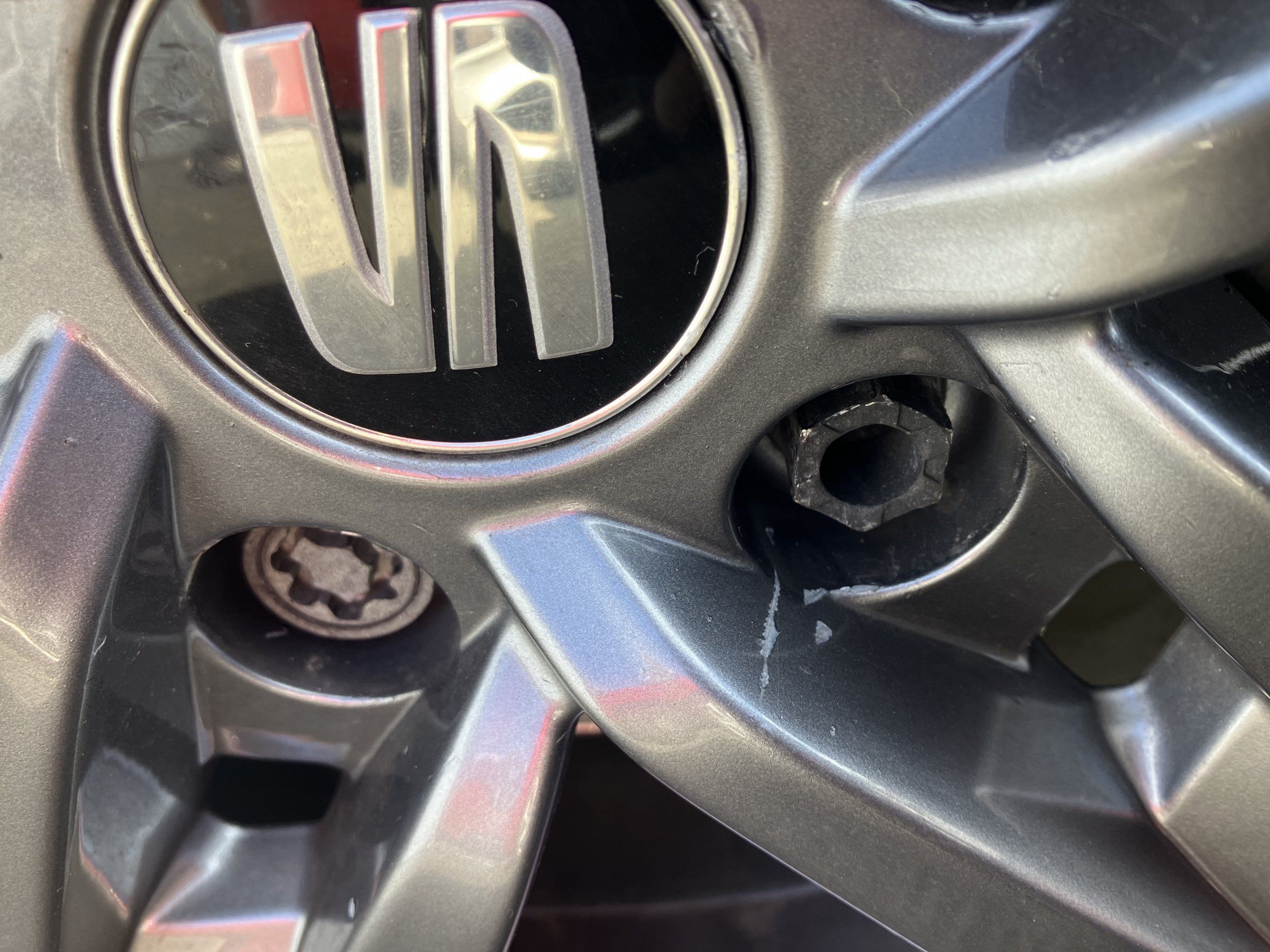

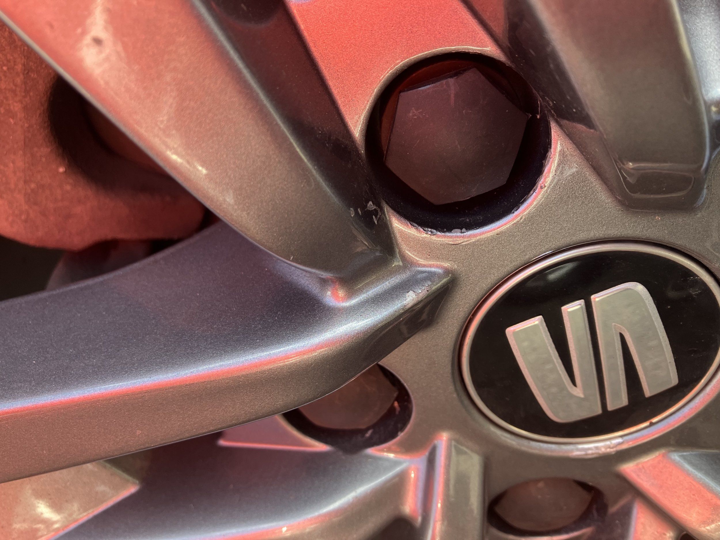

I wish I knew this before. I've had the new tyres fitted and every alloy is now damaged, some much more than I feel is acceptable. Look at this for instance.

That’s shocking!
I‘d be going back to the place that fitted the tyres, point out the damage and ask them what the propose to do to rectify it.
They would have been able to see that your wheels were completely unmarked before they removed the old and fitted the new tyres. Hindsight’s a wonderful thing, but I always point out the condition of my wheels to any tyre fitting place I go to before they touch my wheels (weather permitting, I also make sure they’re spotlessly clean too, so it’s easier to agree their condition), and tell them I expect them to be in the same condition after they’ve fitted the new tyres.

Uhoh looks like the paint was soft or laid too thick.
Yeah always best to find somewhere that refurbs wheels that takes the tyres off. Masking up is a rather rough imo

Unfortunately looks like a wet paint job on just the faces, as they haven't removed or even taken the tyre orr the bead. Was this done by a body shop rather than a wheel refurb company? The onus here is on the tyre garage though, the damage around the wheel bolts is unacceptable. The marks around the edge will be unavoidable as they just masked around the tyre when they painted them, so it will always lift as the tyre comes off.

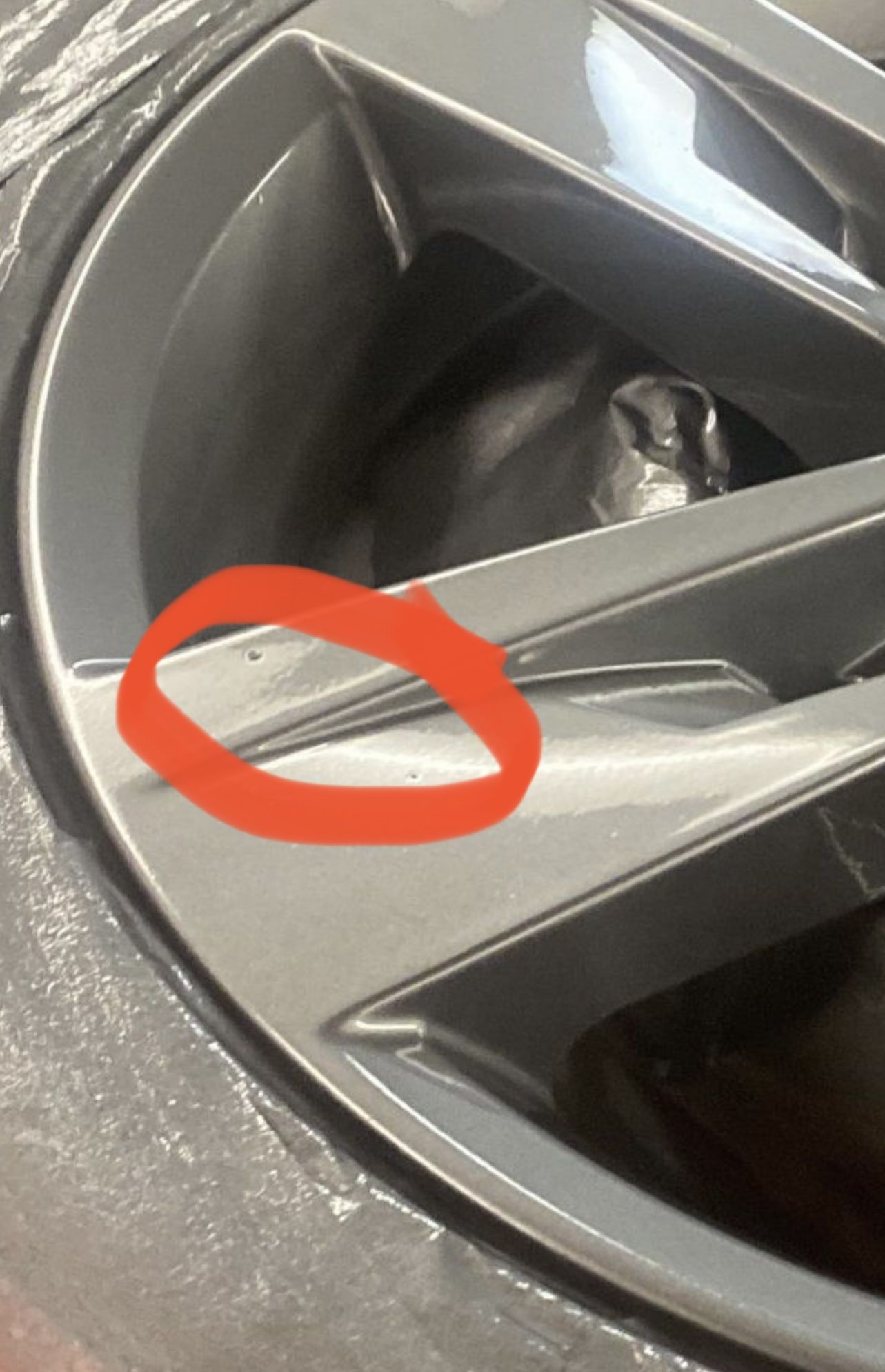

Playing devils advocate to the people saying it’s the tyre shop. This looks far from a quality paint job on the alloys no?

I was thinking that as I did notice that after I picked the car up from having the alloys done, not much I can do now, other than get them done at a proper alloy place if I ever did again which I doubt :mad:

Your best bet is to claim from the tyre shop, however it’s not a quality job when they have left the tyres on, air plugs etc so meh. Pay for what you get. From other posts I pick up you’re on a budget so must be aware you get what you pay for it’s not all going to be perfect unfortunately pal
I only saved about £30 for the alloys so I still paid quite a bit for how the body shop did it 😞

I sent the tyre place the images and they've called and apologised and said they'll put me in touch with a alloy wheel refurbisher who will come to my house and sort them out so hopefully this will work out.
