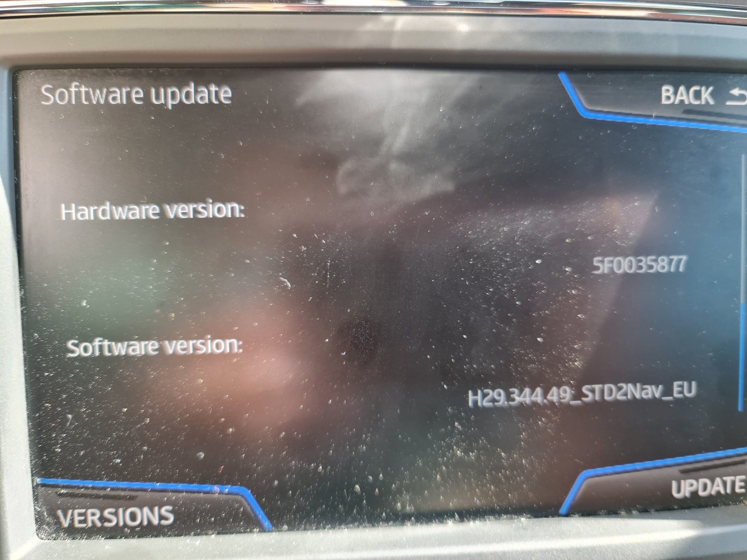

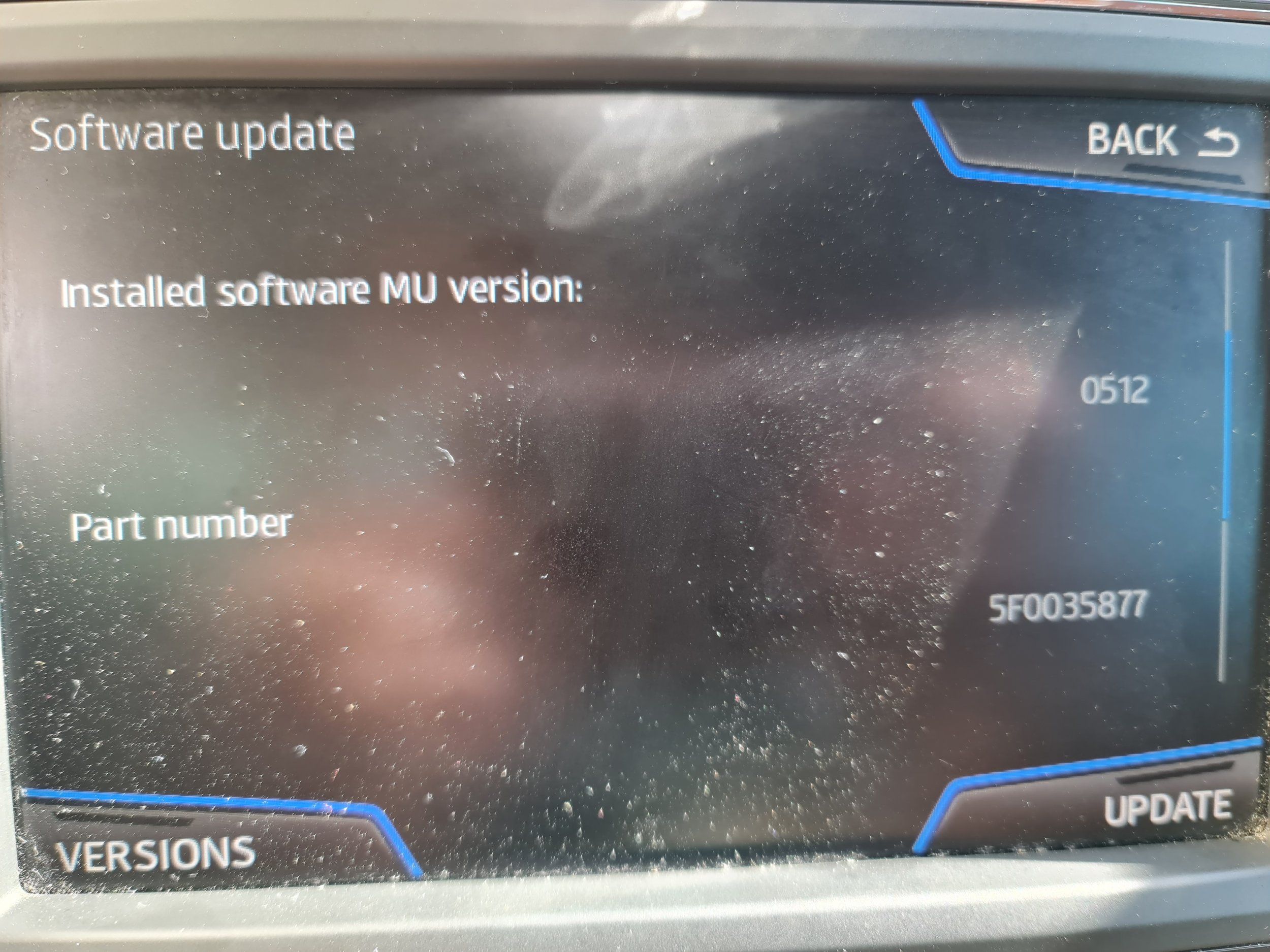

Hi
I have a Seat Ateca 2019 car.
I wonder if there is a way to update the infotainment system or softwar. And if it is needed.
I attached my infotaiment info and version. Is it final?
Hi
There is atleast a 515 version, you are at 512. I've never done a firmware update. A lot of other people have. I've got a retrofitter to do that for me on a high.

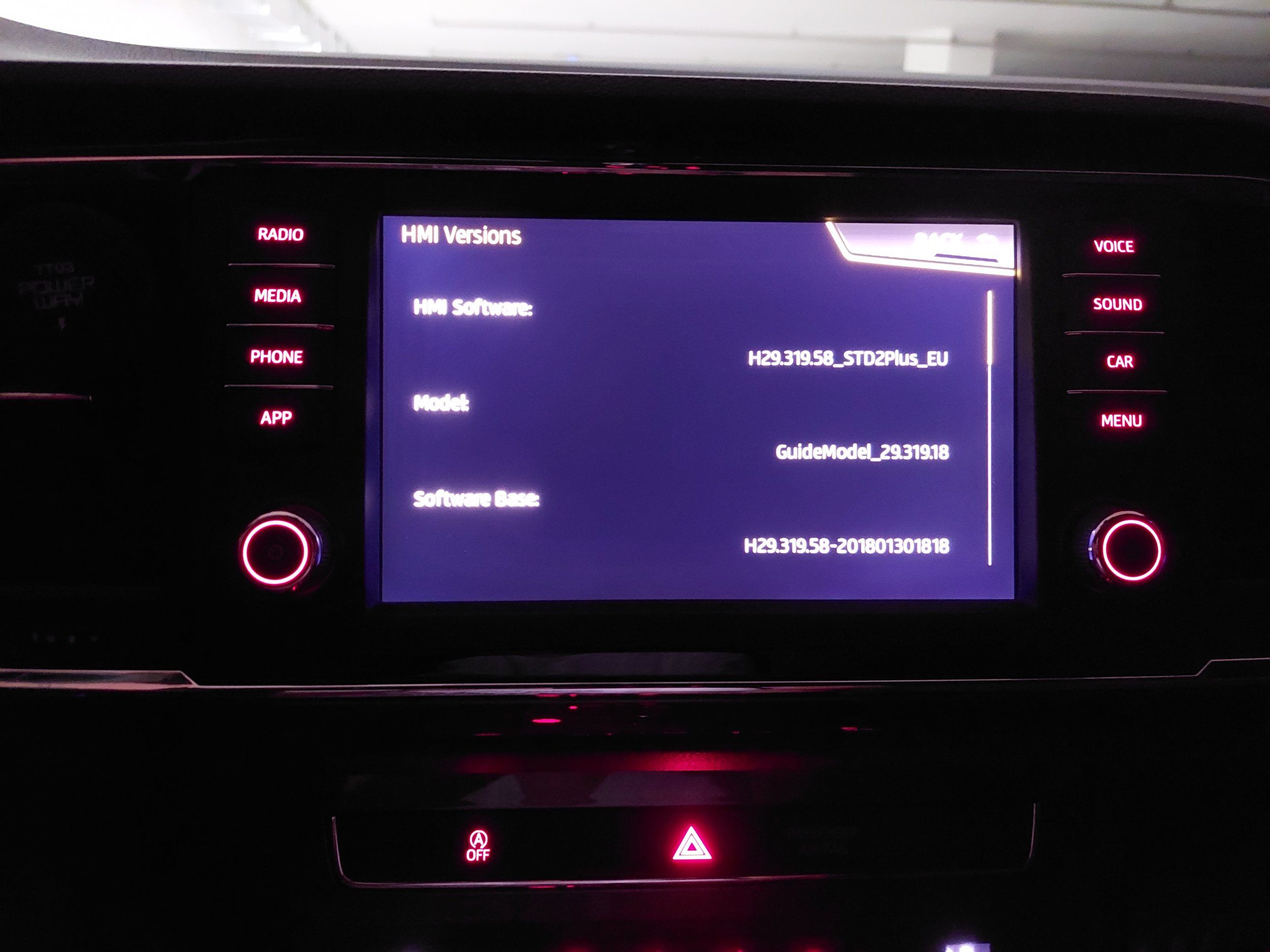

Well this is what I see on hmi versions page. What is the right way to upgrade 515 version from 319?
*Your best place to ask that question is on the software thread
Have a good read.
I did research another big upgrade for someone else on another random thread, can't find what I posted up at the minute.
The big upgrades which jump trains are tricky which is why the boards retrofitter sponsor offers a return service not DIY.
"If it displays 02xx, then purchase the 02XX update, 03xx to 03xx etc. Please do not try to update from 02xx to 03xx, 03xx to 04xx as you risk damaging your unit."
Yours falls into that.
I did find a Briskoda page with people doing these train updates with the help of a Polish guy on them and it did cover Seat. Its suppose to be tricky and fiddly from what was written.
Pending the Mib collective arriving suggest you have a good read of the SW thread. It links thru to the Spanish thread but you will find the recent material on it. Probably already asked on there. Read both threads.
He can upgrade without spending any money, just needs an SD card and that's it :)
Do not upgrade to 515 unless your unit came with a 5xx version. It's possible but you may have issues in the long term.
You can get to 515 from a different train but what you may loose pass on. With these complex operations you either need a kind soul who gives their experience out for free or pay for certainty with an honest retrofitter if you can get it there and whether they want the job. It seems to me no cost is associated with the firmware upgrade as such and the routes that retrofitters use to obtain the software seem similar to hobbyists (free). E.g. same release. Not everybody is a hobbyist and has the experience to do it themselves. To update a standard unit should only cost a token amount via a retrofitter or zero if you research it and have the skills.
