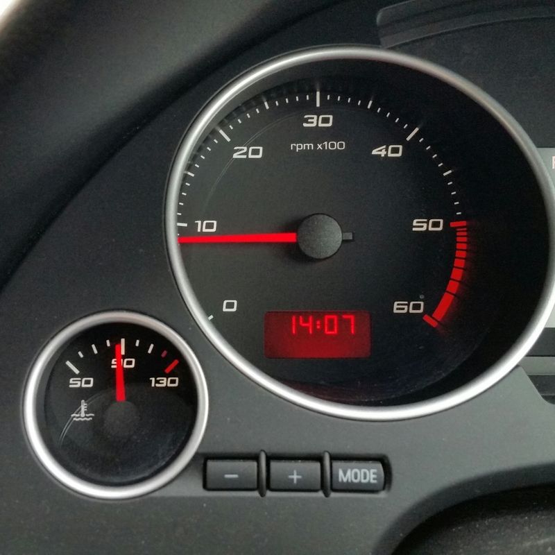

Karmann_65
Sep 7, 2016
110
Reporting back from my Exeo thermostat change yesterday....
Took the car in to Arnold Clarke and explained what had been going on. The general opinion between the parts manager and their in-house VAG trained mechanic was that a thermostat, housing and coolant change was the way to go.
When I got the call to collect the car it was fresh out of the service bay and pretty much up to temp already. It was also 8 deg outside. Within 2 miles the water temp was reading just below 90 deg and stayed like that for the 5 miles home.
Starting from cold this morning (4 deg above frezing outside), back on the daily 15 mile commute, the temp got to 70 deg just before arriving. So I'm "presuming" at this stage that the temp would increase further given a longer run. With that said, it's already an improvement on recent temps and I've got some peace of mind. :)
They also plugged it in carried out a full scan for sensor errors etc. Nothing showed, past or present.
The car was fully valeted and given a clean bill of health including an emailed video walk around by the mechanic who carried out the work.
£132 all in due to a totally legit "friends and family" deal from my cousin the parts manager. :D I believe that's a 50% discount. :hug:
