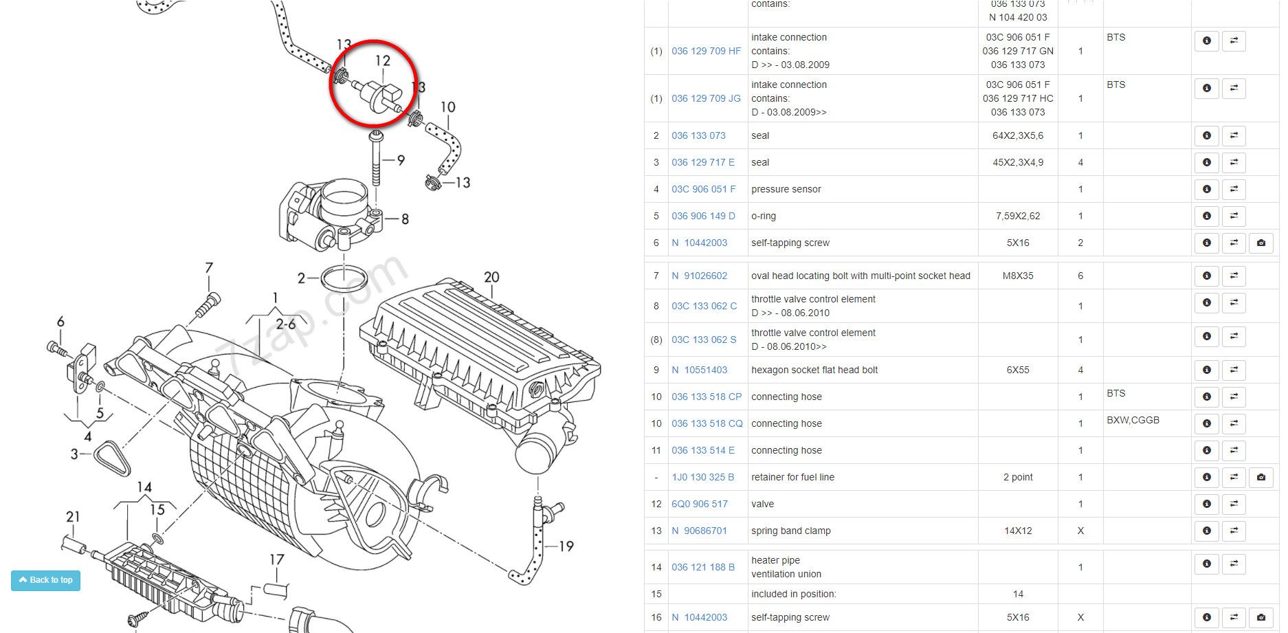

This sounds like it might be the documented hot-start issue. On my car it only ever did it in hot weather, the car would crank for ages but eventually start; I can't remember the detail but it's something to do with the car not being able to vent a build-up of petrol fumes.
There is an official Seat fix which consists of a replacement fuel tank breather valve and a software update. I didn't bother with a software update due to the expected cost of paying a main dealer, so I just replaced the breather valve and the problem hasn't returned since. On my car (2009 1.4) the part number was 6QE906517; it was about £30 for a genuine Bosch item. See below.

Thank you so much to both of you, that's really helpful. Yes, I was already aware of that thread, but was unsure about how likely the issue those people were having was the same as mine due to the fact that this is happening not just exclusively in hot weather conditions. But one thing I can say for certain is that hot weather definitely exacerbates it - as I said, I can basically guarantee the car won't start on a warm day. It may well be a combination of things.
I've ordered the Bosch breather valve as suggested by vw.man (thank you for the part number) and I will try that first. If replacing that doesn't do the trick, I will then replace the coolant sensor as you suggest RUM4MO. I will post back here when I've done so to let you know the outcome.
Thank you both again for taking the time to reply to this, huge respect!
@vw.man @RUM4MO Hi guys, just an update - I replaced the purge valve as suggested and so far it looks to have worked - it was 16 degrees today and after fitting it the car started first time; that basically never happened before. I will test it again tomorrow (as it looks like it's going to be warm again) and report back, but it does look like this was the purge valve issue. Once again, huge thanks to you both, you've saved me a lot of hassle and money!!
Reactions: Callum Redman
Yeah, I tested it again today on multiple occasions - starts perfect every time. Thanks again both - take care
