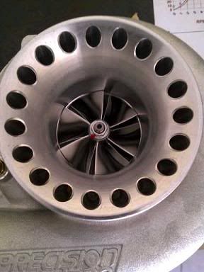

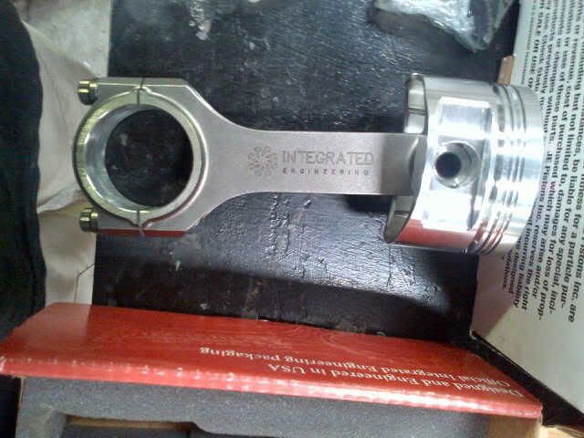

PTE 5858 BB Turbo

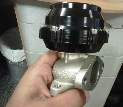

PTE 39mm External Wastegate

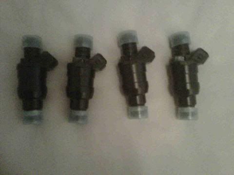

830cc High Impedance Injectors
Calico Coated Rod bearings
Calico Coated Main bearings
Custom Branch and Manifold by Lee at gtec
IE Rods
IE Gasket set
JE Pistons 9.25.1
JE Piston rings
ARP Rod bolts
ARP Crank Damper bolts

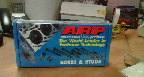

ARP Head Stud kit
ARP Cam Pulley bolt
ARP Flywheel bolt kit
Custom Surge Tank

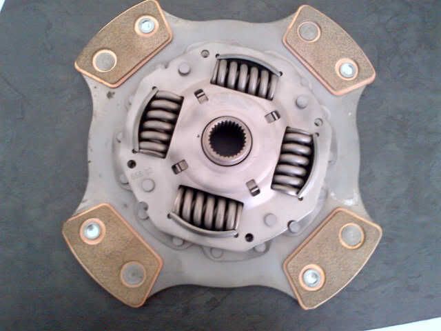

VR6 Copper Clutch and ABF Flywheel
Custom Catch can
Bosch 044 Inline Fuel Pump
76mm Custom DP

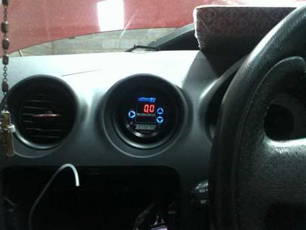

Eboost 2 EBC

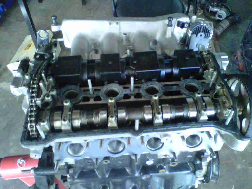

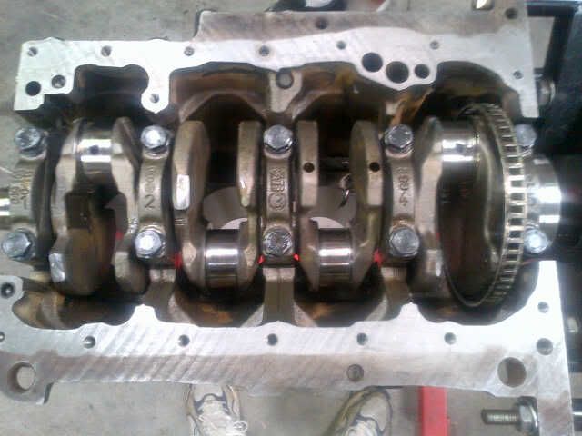

Motor Rebore to 1.9 (Sarel 8v performance)
Headwork by Mike Dixon in CPT, Recon, port polish, flow, oversized billet zorst valves etc
Custom boost piping
WOTBOX
NGK Plugs
Devils own DVC 30 WMI (Dual meth nozzles)
Battery relocate to boot
Poly engine mounts
H&R Suspension
Forge Intercooler pipe
Forge Short Shifter
Forge 008 DV
Digital Designs Amplifier
JVC USB Front loader
Unitronic Stage 3 Software (big turbo custom tune)

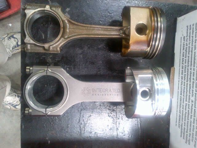

IE Rods/ARP Rod Bolts
Calico Coated Bearings

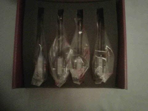

830cc Injectors
Oil Catch Can
Bosch 044 In Line Fuel pump
39mm PTE Ext wastegate as well as ARP head Stud kit!
JE Pistons
ARP Cam pulley bolt, ARP Flywheel bolt kit, ARP Crank Damper bolt
Calico Main Bearing set

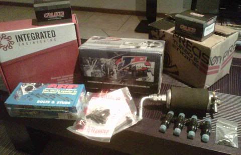

all the goods together

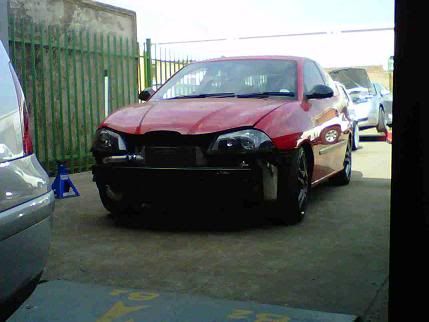

before
after

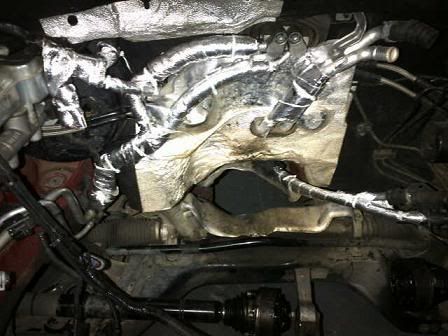

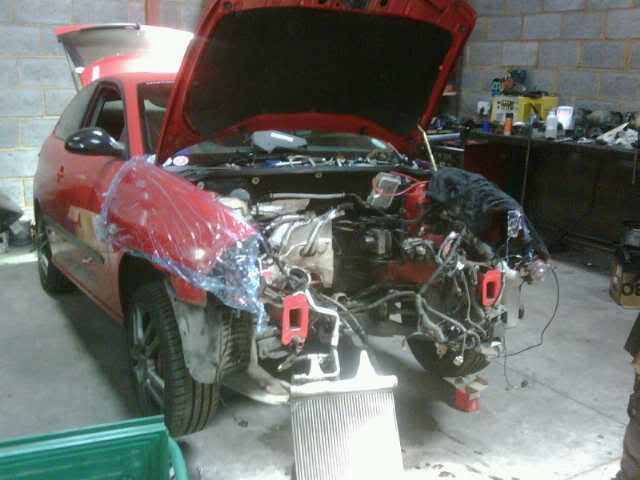

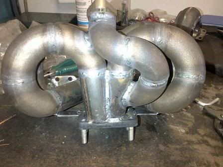

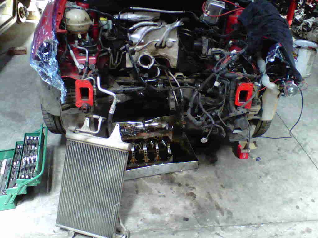

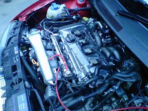

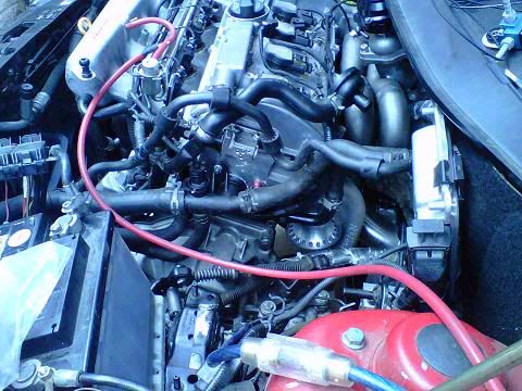

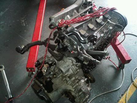

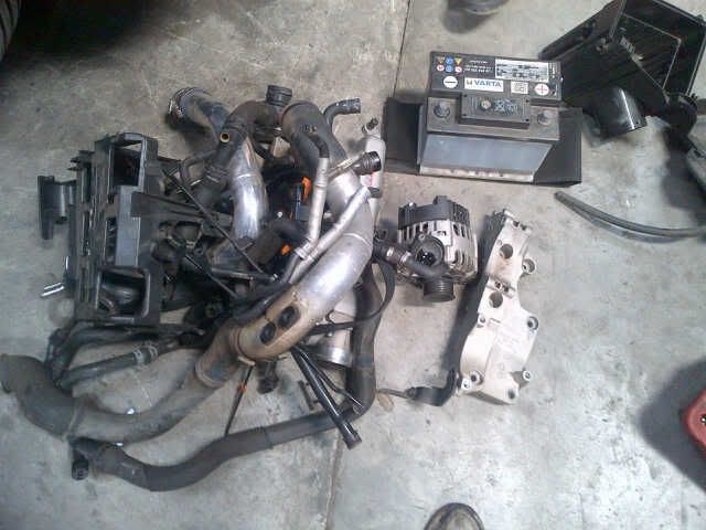

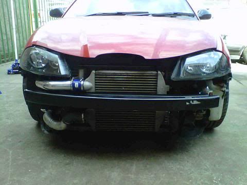

Some pics of the branch being made, turbo position, heat wrap etc

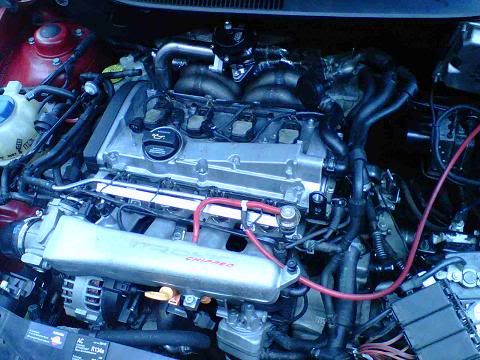

Done!

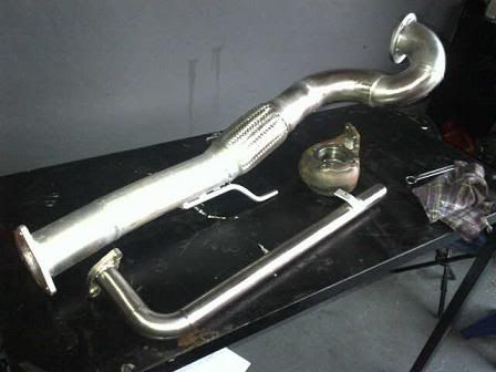

So heres the DP and the screamer pipe

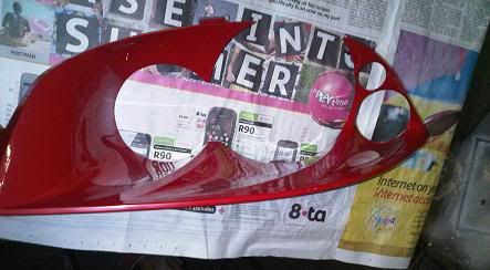

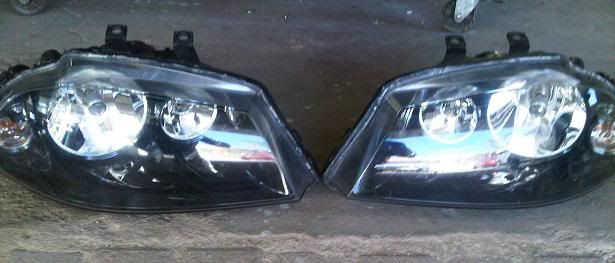

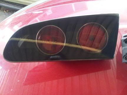

I gave it to a friend to do who is a proper DIY guru so to speak, he used a heat gun and said that each light took about 2 hours to split!
