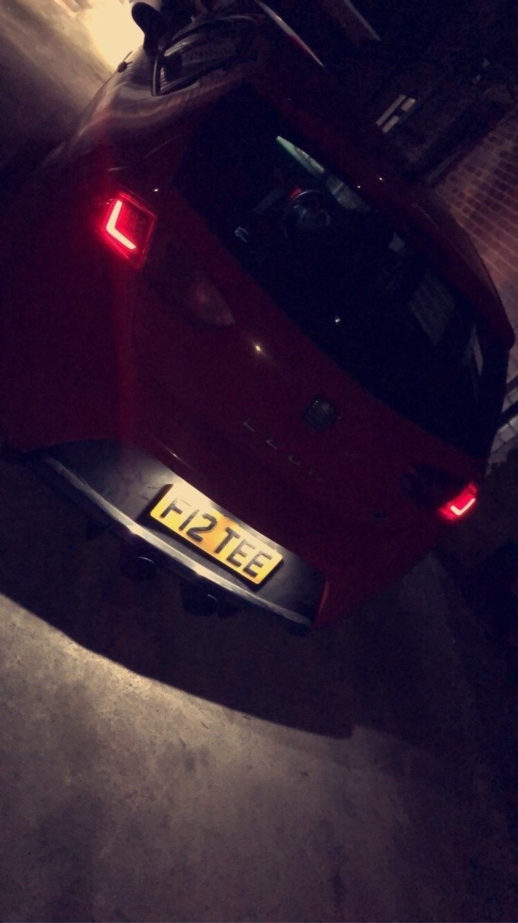

Anyone can that advise me i would appreciate it i got these tick light fitted i had to change the full bootlid etc however the main back light aint working neither is the wiper, does anyone know what it could be?
I do have the light sensor on my dash but they have new bulbs in
my car is on a 2007 plate im not sure if that makes a difference
Please see image below as the inner tick lights not switched on

It's probably the tailgate shut sensor. The car thinks the tailgate is open so has shut off the electrics.
The sensor is built into the latch mechanism but check the wiring inside the tailgate in the first instance.

Thanks buddy i will get the wiring check however do you know anything why the lights aint working...
Check the closed signal from the tailgate latch. If the car thinks the tailgate is open it turns the lights off.
But then on my dash it would say my tailgate is open which it doesn’t say that which is strange
It's switched to negative when open so a broken wire or faulty switch wouldn't make the contact. It was the fact that the wiper is also not working that makes me think it might be this.
