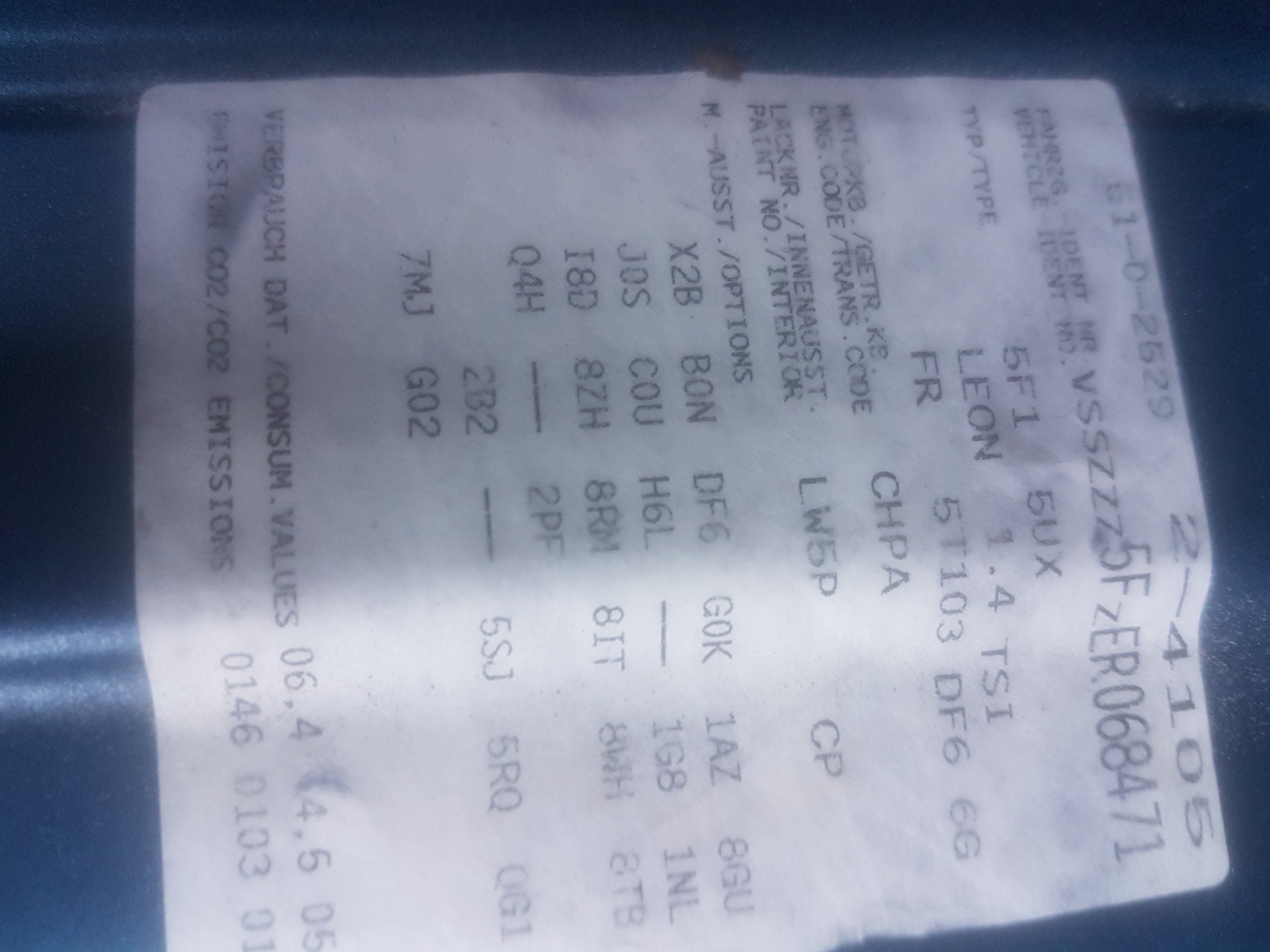

Hi all
Please can someone let me know if my 2014 Seat Leon Fr 1.4 is the 138 bhp or the 148 bhp model .Also my car does not have cylinder deactivation. All replies appreciated.
F1 Fan
Hi F1 Fan, we will need a little more info to figure out what BHP varient your car is. If you check the boot under the floor carpet, you should find a white sticker with codes printed on it. Post a picture of this as it should tell us the engine code.
I've also moved your thread to the correct forum (y)
Thanks,
Lozzy.
1.4TSI's with engine codes I can see linked to the Leon with PS & BHP conversions from kw:

Thanks SuperV8 looks like my car is CHPA 140 bhp. Still goes ok for 1.4.
