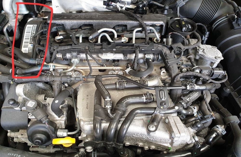

If the engine code is CUNA then it'll be 184bhp.

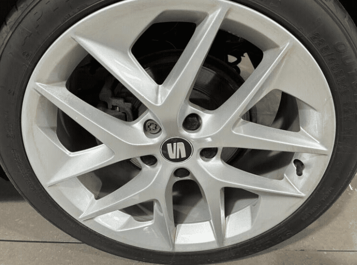

If the rear axel is solid its a 150 if the axel is independent suspension wise its the 184
Thanks chaps, I'll be hoping to see CUNA then, under the bonnet I believe is the black label with engine code.

You can find the code on this sticker
Log book.. aha I must admit I didn't look at this book sat on the passenger seat, moved by the dealer whilst we test drove it.
Although I did look under the rear area for any obvious nasties, I'm not sure I'd be able to ID the difference between suspension systems- it's all new to me. Anyway, just hoping CUNA is a definitive way to identify it.
Thanks- is the plastic engine top cover needing to be removed to see this label?
I was told on the TT forum (I had designs on the petrol EA888 2.0 audi TT until the timing chain Achilles heel made me opt out) to just 'oh you just lift that plastic engine cover up/ off' but as if I'd do that looking over someone else's car- it just seemed wrong.

The 184 has independent rear axle.
The 150 FWD has beam rear axle.
If you have a photo of the rear wheel you can tell which axle it has from the brake caliper position.
150 - higher mounter caliper
184 - rear caliper is horizontal = independent rear axle.
