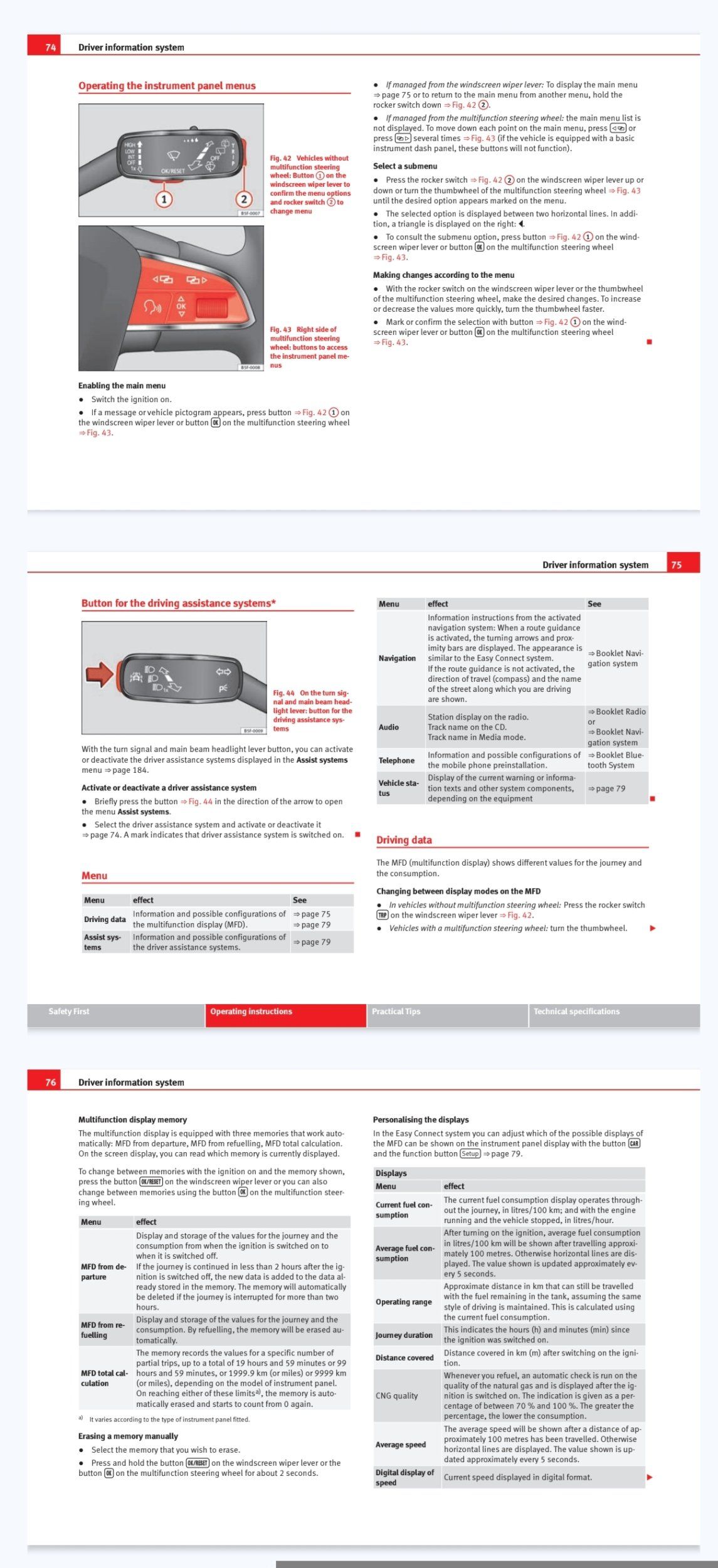

The following section from user manual explains how to customise the instrument panel to show selected information, including operating range. Hope this applies to your car as well.
Hi serdar_18fr
thanks indeed- found it. Under my nose as it were, just a few clicks. On the face of it damn useful.. although it showed 90m (2 bars remaining) parked in my drive, & within 5 minutes of driving down to 85, then 80, then 75 within 10 mins, & down to 70 a few mins after this. When I returned from this 12m trip, it had gone up to 75.
So it's pretty vague at best, not sure how useful in actuality. Which is a shame for me, out here low population & rural.

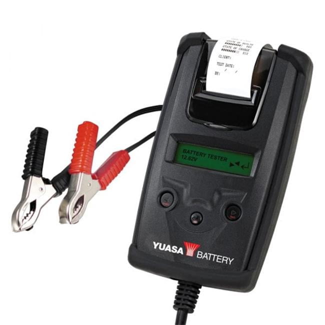

If you suspect the battery, then having some data on it is always good so you can make an informed decision. Reputable garages usually have a battery measure tool, showing if the battery is still ok. And they usually can do a printout of the status.
The battery monitor I recommended shows data like the ambient temperature, the state of charge, how long your car takes to start, historical data etc.
Something like this:
Yuasa-Battery-YUA00BTY01P-Digital-Battery-Print-Tester_f2e26313-ae6d-4032-9e39-947b829bf011.d693ba3072b1a3f9bafa8ef1d58622eb.jpeg
You can also do a simple test with a digital gauge. I use this chart for my car batteries, 12.4 during rest is well within normal limits and looks fine.

The 12v thing looks affordable & no app smartphone situation needed. But would this thing's reading be the definitive test to determine if the issue -is- with the battery simply needing to be replaced-?

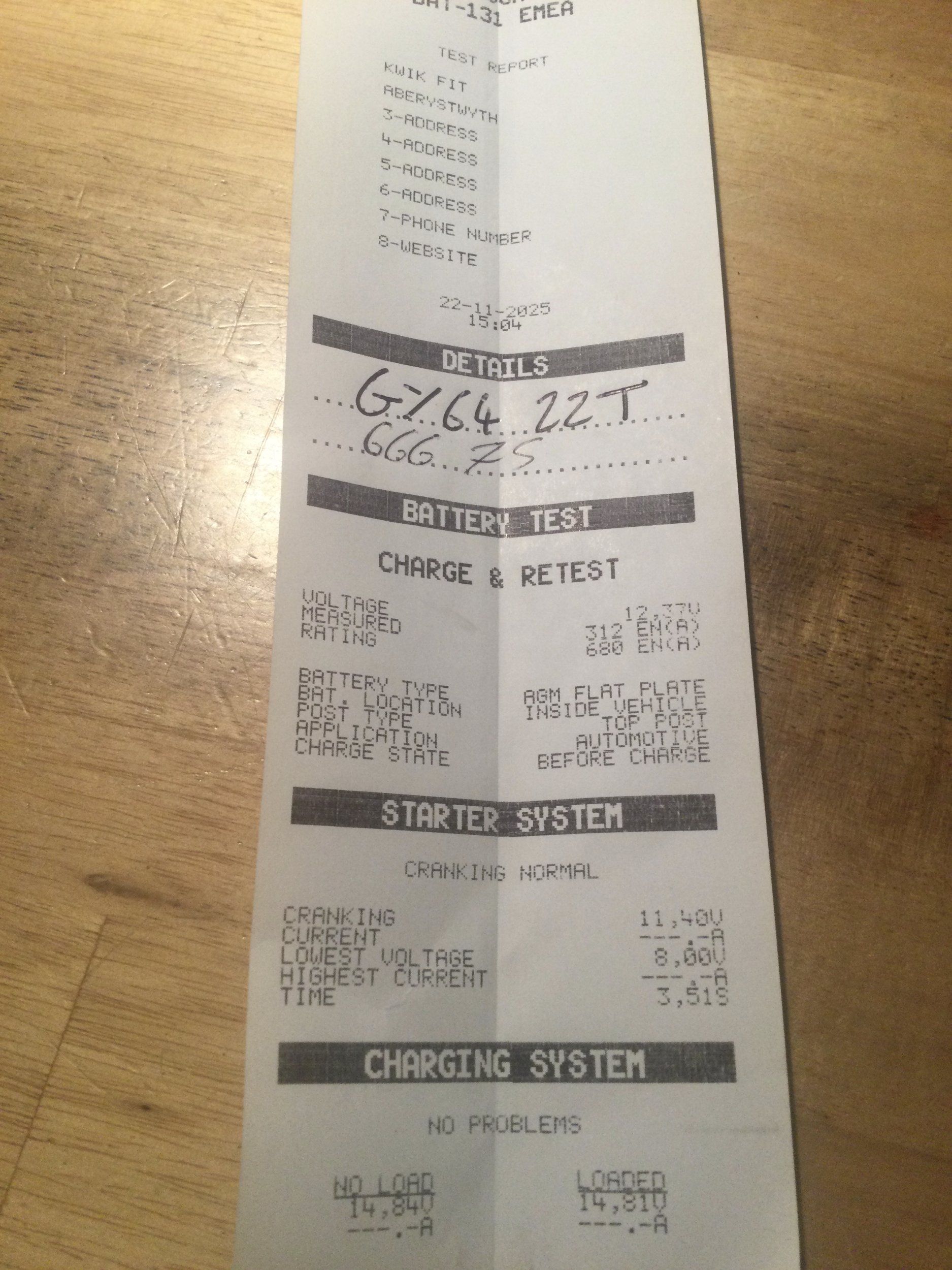

Ok so I had this free battery check, in KwikFit in town. 15mins I'd say, with some gizmo on my battery, & a printout given to me. Below.
The chap said "although printout shows it checks out as ok, we did see evidence of it not holding charge too well".
Hmm. Thing is I'm a bit confused as to why it --would-- start immediately 1st thing AM after an overnight big freeze.. but 3 hrs later --failing to-- when the sun had burned the frost off. That doesn't say to me 'battery is suspect' (or the reverse would surely have happened: not starting covered in frost, but starting later when outside temp had risen).. but something else being at fault instead.
I do think your battery date is worth checking/ will do this tomorrow. Is it ok to just whip off one clamp on the battery terminal to look for a date, then pop it back on-?
Anyway, here is my printout:
Thanks, Zoot

This test looks good to me. Cranking voltage is important and is well within the range (the 11,4v value). For comparison, my Cupra with a 11 months old battery sits at 11,1v and 3.4 seconds crank (just checked the app ;) ). I also suspect something else is on.
It doesn't cut out all of a sudden right? If the answer is yes, then it could be a faulty Crank Position Sensor.
